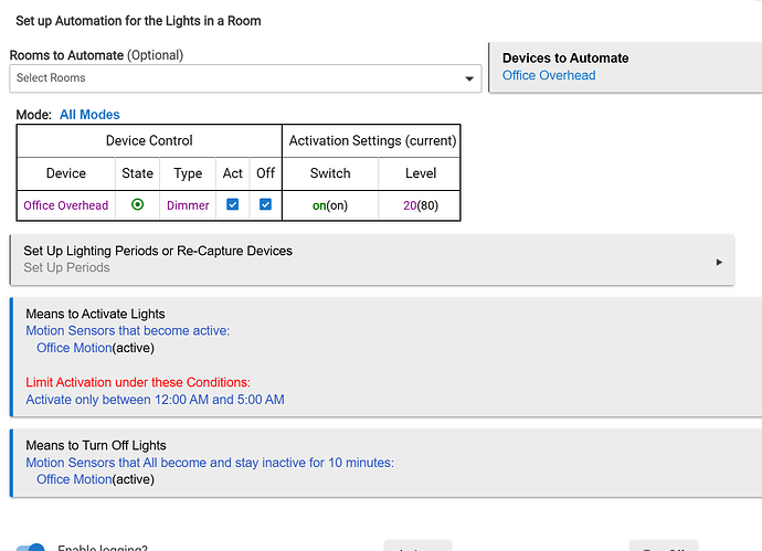

In your example, first, I would strongly recommend you utilize the built-in Room Lighting app, instead of building this automation in Rule Machine. The Room Lighting app was purpose-built for exactly this type of lighting automation, and has a bunch of options available that would be challenging to implement in Rule Machine.

In the Room Lighting app, here is what it would look like.
