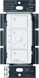

Any (low tone) and use any fan rated smart switch, I prefer lutron

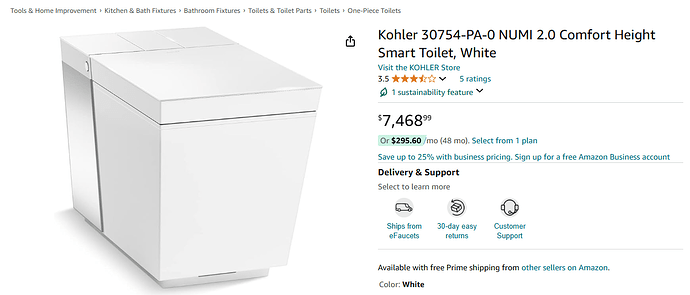

This is very essential:
https://www.amazon.com/Kohler-30754-PA-0-Comfort-Height-Toilet/dp/B0BSB3J2PG
