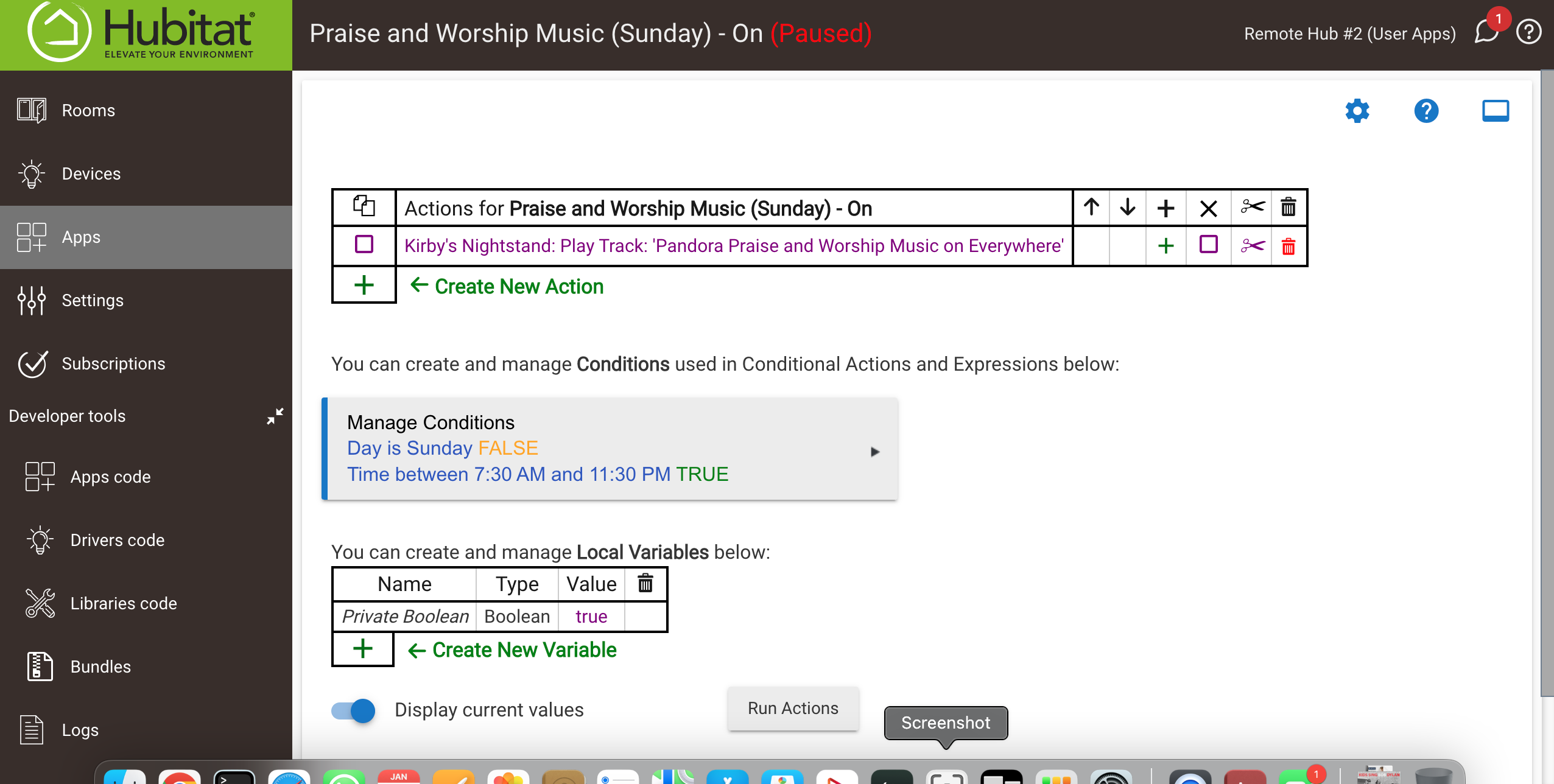

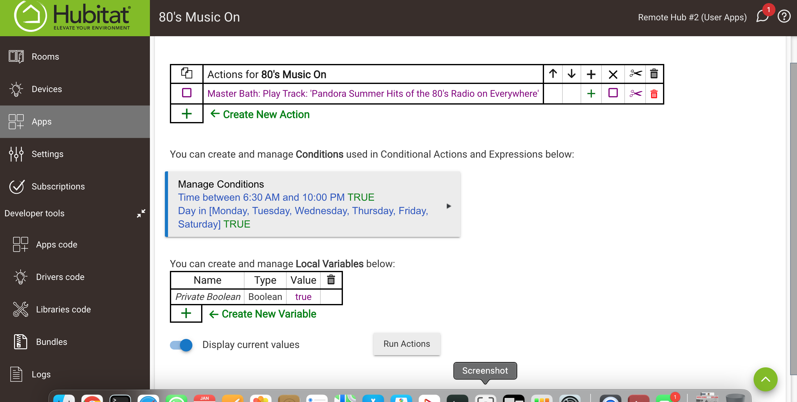

I have two separate rules that Play Pandora tracks on my Amazon Echo's "Everywhere" group. I am no longer using Echo Speaks because of the Heroku issue. I am using the Music Device applications through Rule Machine.
I want one Rule to play music Monday-Saturday and the other Rule to play on Sunday. I have set the conditions accordingly.
The Problem is when the trigger goes off (push of a button). Rule Machine is alternating the Sunday Application and the Monday-Saturday Application on every push of the button. HOWEVER, when I pause the Sunday application Rule Machine plays the Monday-Saturday application every time.
Please review my two separate screenshots and let me know
if I am missing something. I am usually pretty good at solving my Rule issues but this one is stumping me. Any help would be appreciated. Thanks.
Thanks for the info. It sounds like I am misunderstanding how the "Managed Conditions" work in the New Rule Machine. Most of my rules were written in Legacy and I use a lot of if-then principles. I'll look at this closer and check out the "Required Expressions". I'll let you know if I am still having difficulty.
Thanks again! I see where I made the error. Should work now. :grinning:
