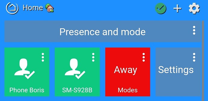

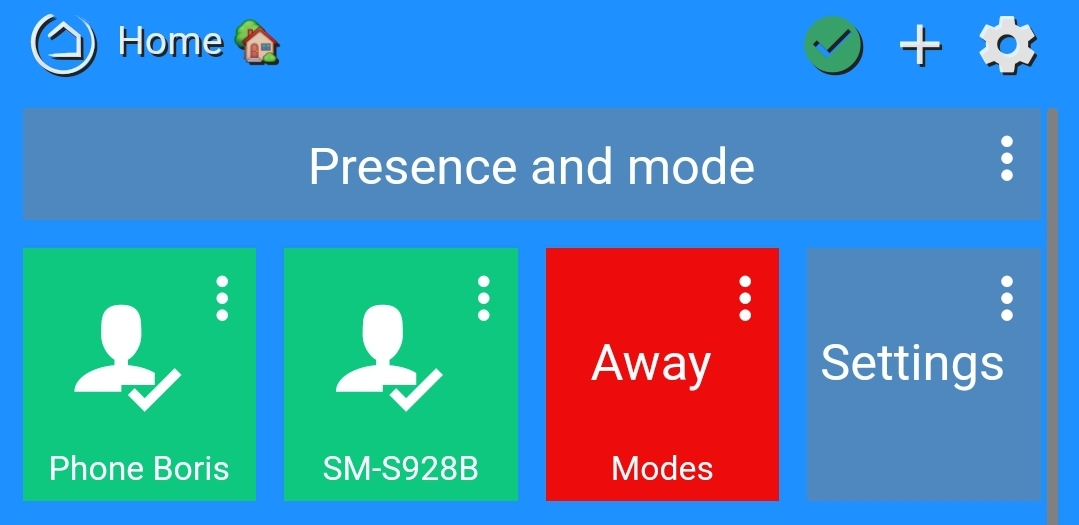

But, this morning we all left the house and it went to Away. This turns the heating off. Once we came back home after about 1 hour, we did not check and resumed our day. It was hours before we checked why we felt getting really cold. I set the mode to Day, got warm, then in the evening we both left and returned at different times, but the Away/Day/Evening switches were well.

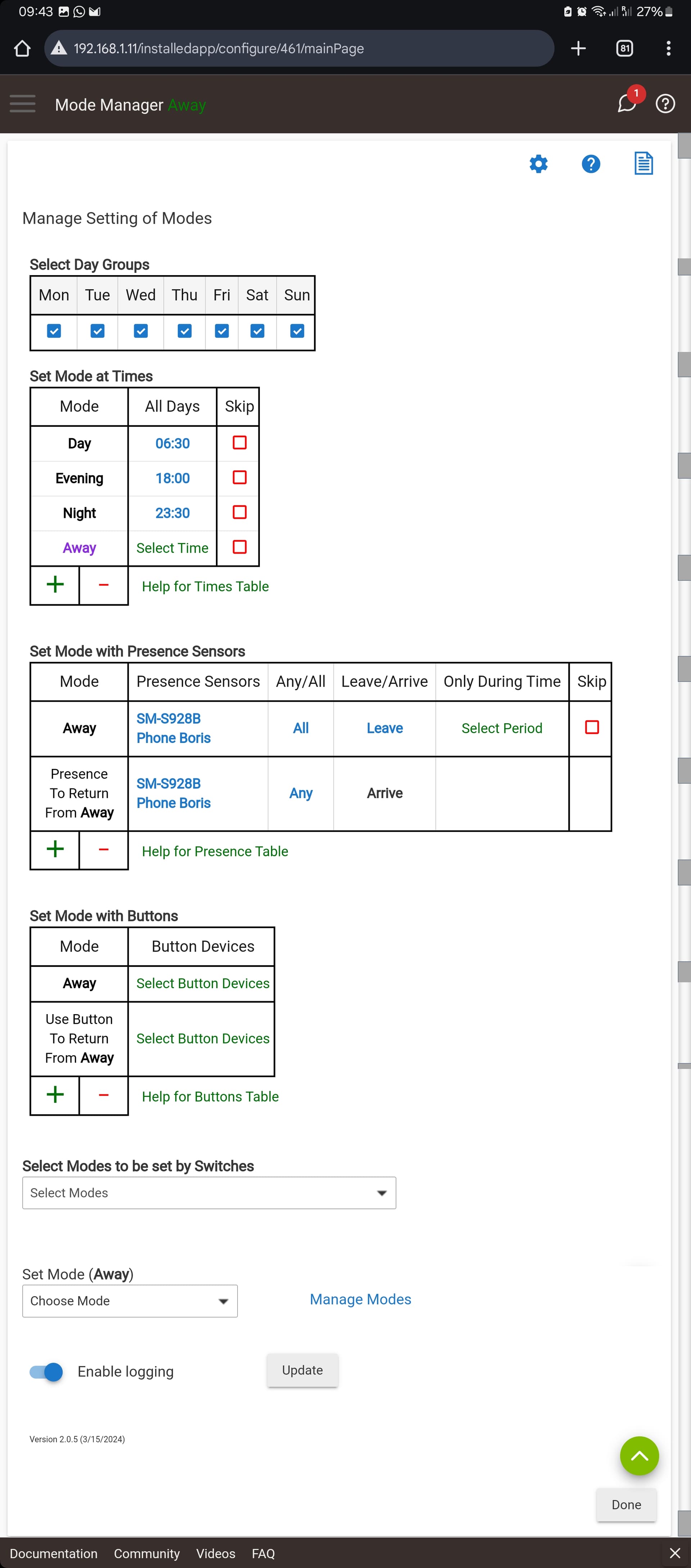

Here are some mode related screenshots of configs:

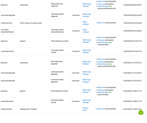

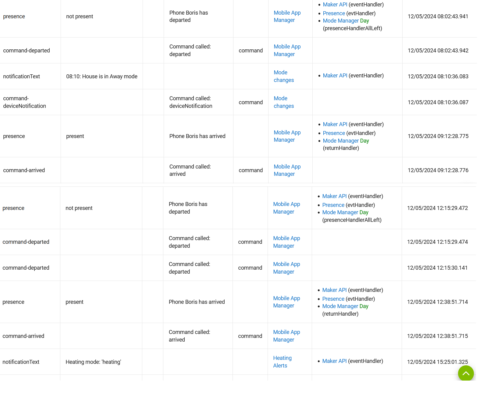

i can at least see events, but the UI is what it is, a lot of whitespace, here it is:
The way i read it is:
  • 08:02 I leave the house (all presence devices together)
  • 08:10 the second device is seen as leaving the hose so the house goes to Away mode. This is noticeable because i have an automation that tells me when the house goes to Away mode on my phone
  • 09:12 both presence devices return, but at least one is needed to go out of Away mode
  • HOUSE STAYS IN AWAY MODE, seen on the previous screenshots
  • 12:15 one presence device leaves the house, the other one stays
  • 12:38 the presence device returns
  • 15:25 we notice that the house has been in Away mode due to the temp going way down. Manually set the mode to day, heating comes back on. Noticeable by the notification i sent to my device from an automation.
Maybe not relevant to the current issue, but comparing your mode manager screen to mine, I think you should have the "skip" box next to Away checked in the "Set mode at times" section.
Without that checked, the mode should switch out of away at 0600/1800/2330 hours even if you're still away.

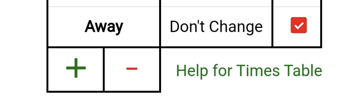

OP, my Mode setup is as vanilla as it can get, but it has what Alan is talking about:

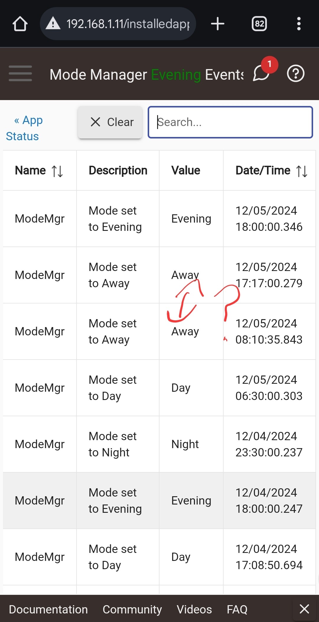

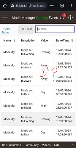

I moved the evening time to be few minutes after the current time. The mode did not change? And i got something strange in the logs
Shadow mode set to Evening
However, if we are out of the house, it would be exactly what i want, the house stays on Away mode.

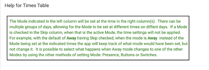

Also from the docs:
by default, Skip is selected for Away mode, which prevents time changes from taking the hub out of Away mode based on time alone (other methods, such as presence, buttons, or switches, will still be able to change modes)

I believe shadow mode is the hub's way of tracking what the mode should be when you return from Away mode. So it makes sense that it logged the change to shadow mode while you were in Away mode.

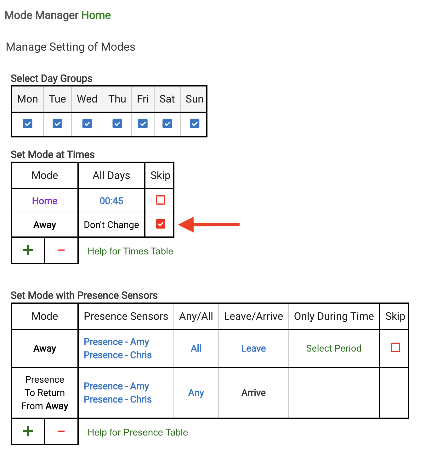

This is how Mode Manager starts out when first installed:

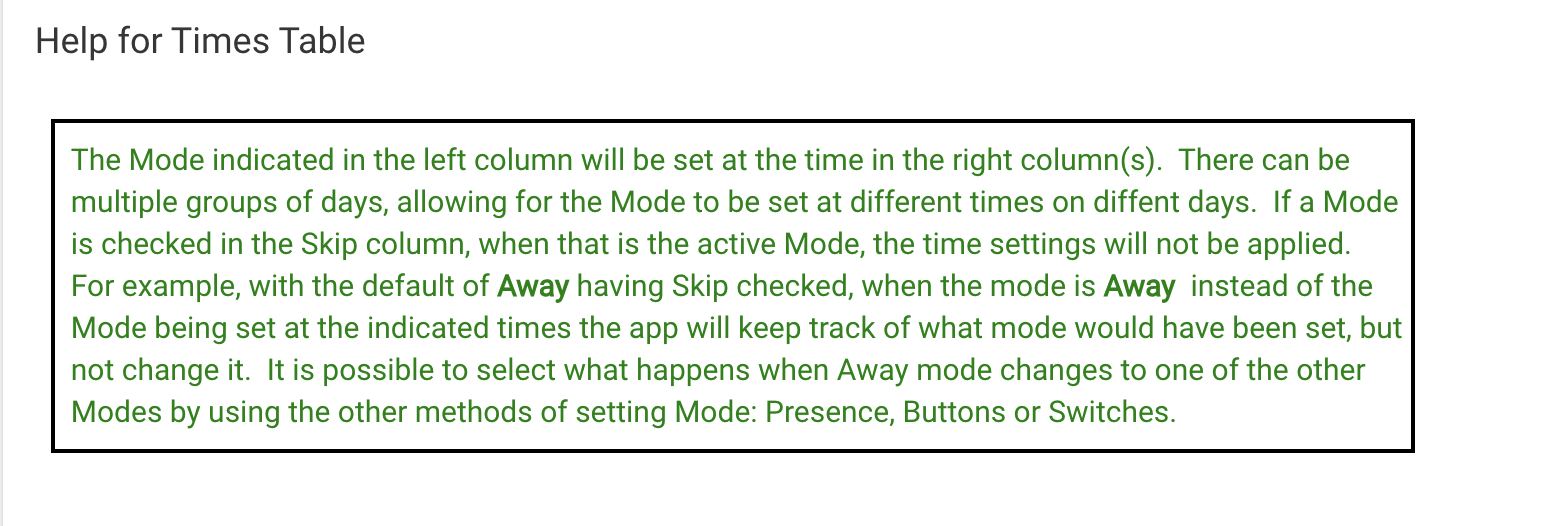

So, a user has to knowingly remove Skip, and ignore the built-in help text that explains how it works:

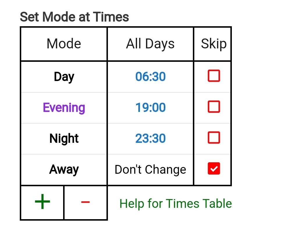

I will try to explain the UI from my point of view, so here's how my current table looks like:
Reading the Away mode:
"Set Away mode at times - don't set it at a time - just skip this mode altogether."
But, i think Skip does much more, because it does not affect only setting the mode at times, but also how to exit that mode right?

Aside from that, in your screenshot i see a box with help text. It is not on my screen.
Final, i know my use case is just one of many many more, so it may not fit all of the use cases.
It's a link on your screen:
Perhaps that should read: "Click for Help for Times Table" since it's not obviously a link.
