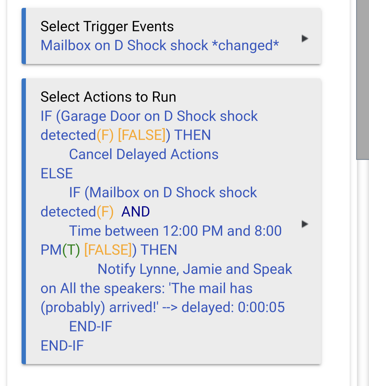

The problem is the garage door rattles the mailbox when it opens, triggering a false alarm. I have a tilt sensor on the garage door, so I have been thinking I might be able to write a rule that integrates the garage door and the mailbox to eliminate false alarms.
Something like "If garage door is changed, and mailbox shock is detected" within 15 seconds of each other, then the mail probably has not actually arrived. Any ideas?

Hi @kilowatts, since you already have sensors that appear to have adequate range and reliability for your application, I think that all the hardware based suggestions given, although all sincere efforts to help (this is a great community) may not be what you are looking for.
All the above having been said, I must say that your own idea of making a rule to announce a mailbox opening only if the garage door sensor is not triggered simultaneously is an excellent one and much simpler than all the suggested hardware change based ones. Should be pretty easy to set up in RM5.1.
Use garage door sensor not active as a required expression and the mailbox sensor as a trigger, the action being your notification or announcement. As long as your garage door sensor is active, your rule will not run, so the trigger (mailbox sensor) will not fire the action. Much simpler than trying to work in some time dependent conditionals. Hope this helps.

Thanks, I will try this! I see a possible variable with message delays - if the garage door doesn't report active in time. If it spells trouble I'll see if I can introduce a small delay somewhere.
Okay, I built in a delay just in case the messages get crossed. I think this should do it - if for some reason the garage shock takes a little longer due to bad reception, it will cancel the notification.
I need to build in a "once per day"... Perhaps with a private boolean?
Yes @kilowatts, some delays may end up being necessary if there is a significant lag with your garage door sensor and it reports slightly later than your mailbox sensor.
