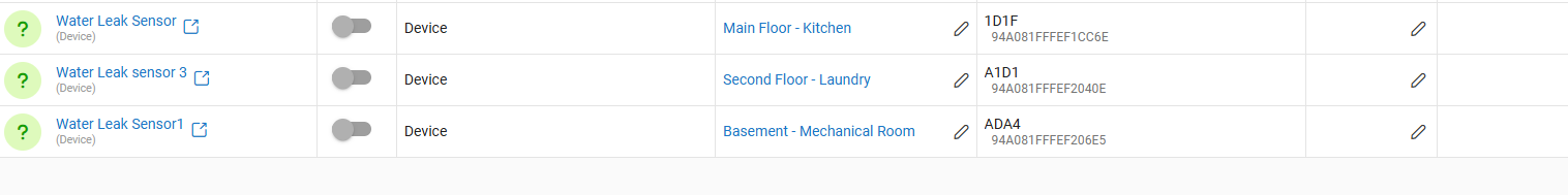

I bought Ikea Badring Water Lean Sensors.
BADRING water leak sensor, smart - IKEA CA
I am having some issue installing them.
Looks like drivers are partially installed.
Any help i would appreciate
They paired as a plain "Device" - that happens if (for whatever reason) Hubitat doesn't get enough info about them during pairing process to select a more specific driver.
You can try changing the driver Type to something like the native/stock "Generic Zigbee Moisture Sensor" driver, or you can search the commuity here for community-developed IKEA device drivers.

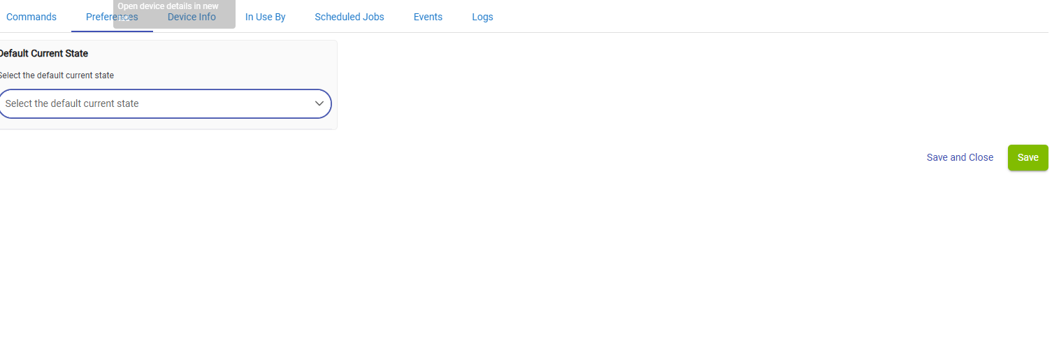

I tried those generic but stil partially.
No battery status...etc.

Did you hit run the Configure command (in the device's "Commands" tab page) after switching to the native driver?
With battery devices, you almost always have to wake them up to accept configuration changes (such as running the Configure command) -- the wake-up sequence should be documented in the instructions that came with the device. Unless they're woken up, they aren't otherwise "listening" for updates.

Yes i did. It did not work
Here's another Raw Link for the driver that may work better.
I was able to install that driver.
It works fine now.
