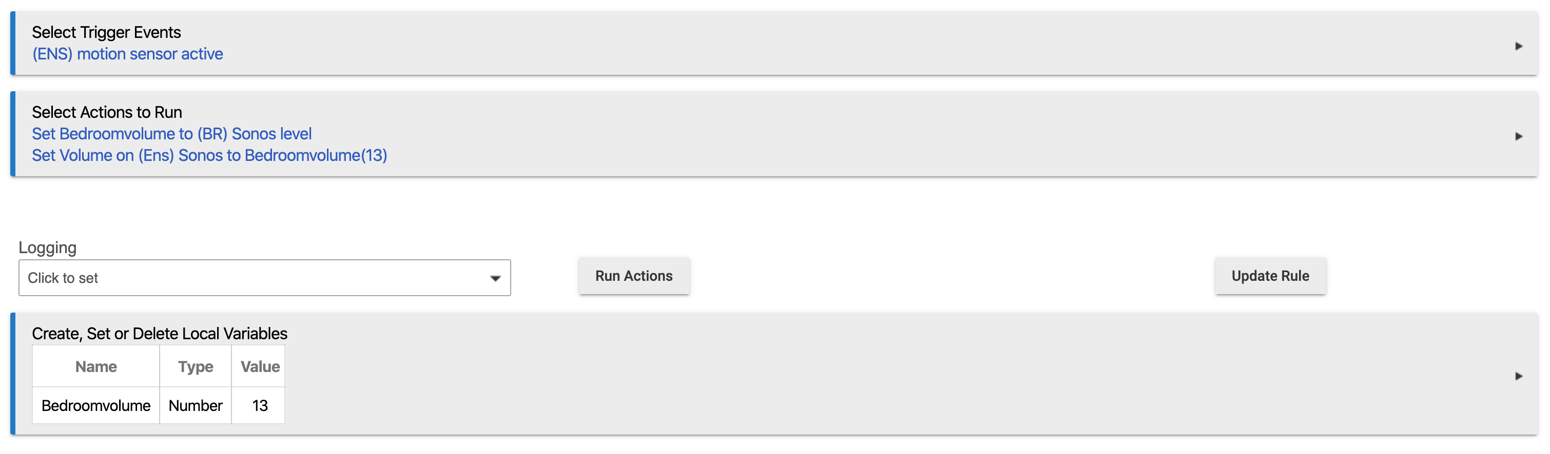

I use this rule to turn the speaker in my ensuite up (to the volume of the adjacent room) when motion is detected in the room.

I have added this to the volume up rule, is this what you mean?
Thanks again!
Cancel Delayed actions will only cancel actions for that rule. There is another option to cancled the timed actions of another rule as seen in the screenshot below
You would want to use this and select the volume down rule as the one you want to cancel timed events.
Ah I see! Like so?
