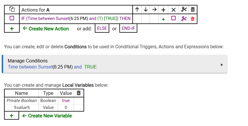

That being said, it sounds like you just need to wrap specific actions in a conditional, then the actions inside will only be executed if the expression is true when that line is reached. I'd normally suggest adding an "IF THEN...", which requires an "END-IF," this block enclosing the actions you want to restrict based on the evaluation of the expression.

IF (Time between sunset and sunrise) THEN
  On: Kitchen Lights, Outside Lights
END-IF

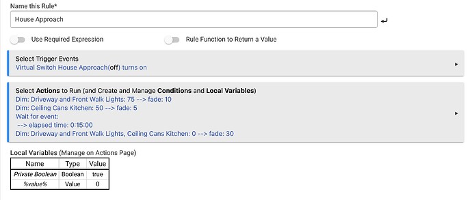

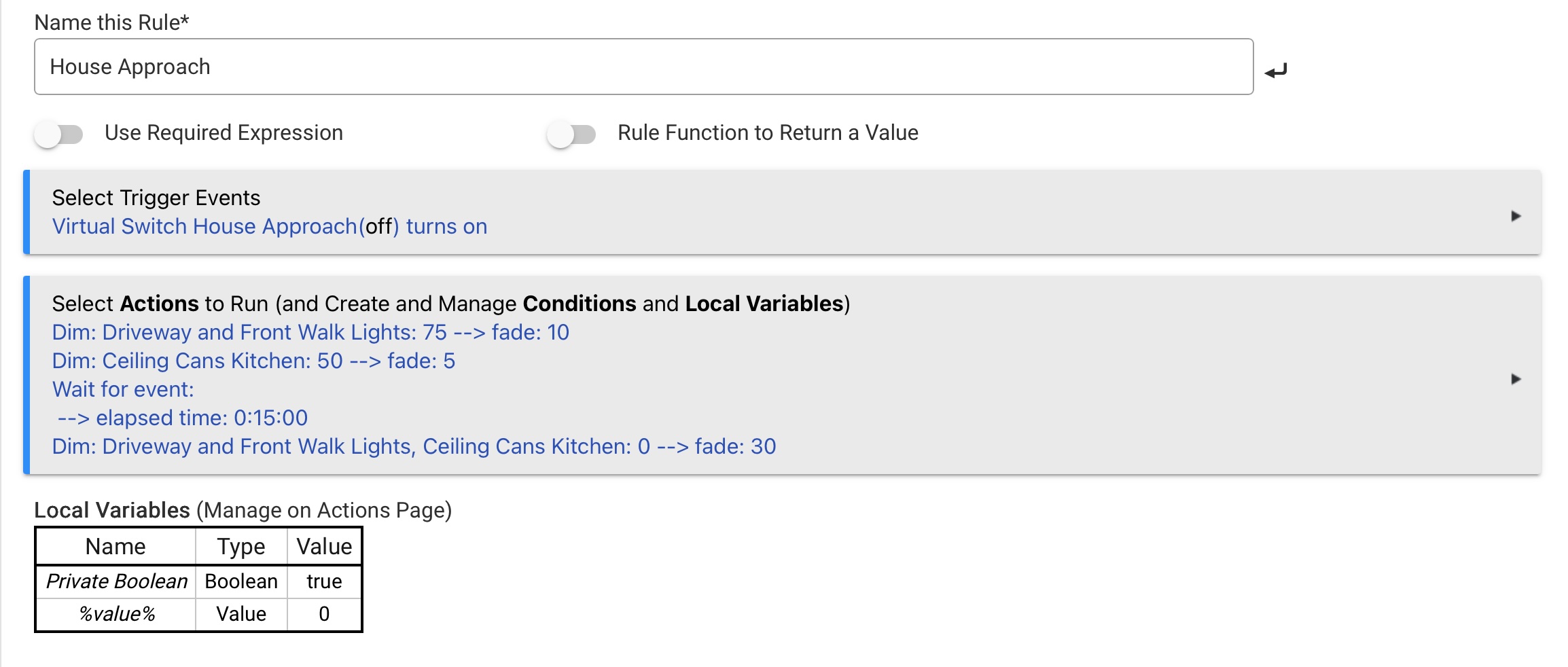

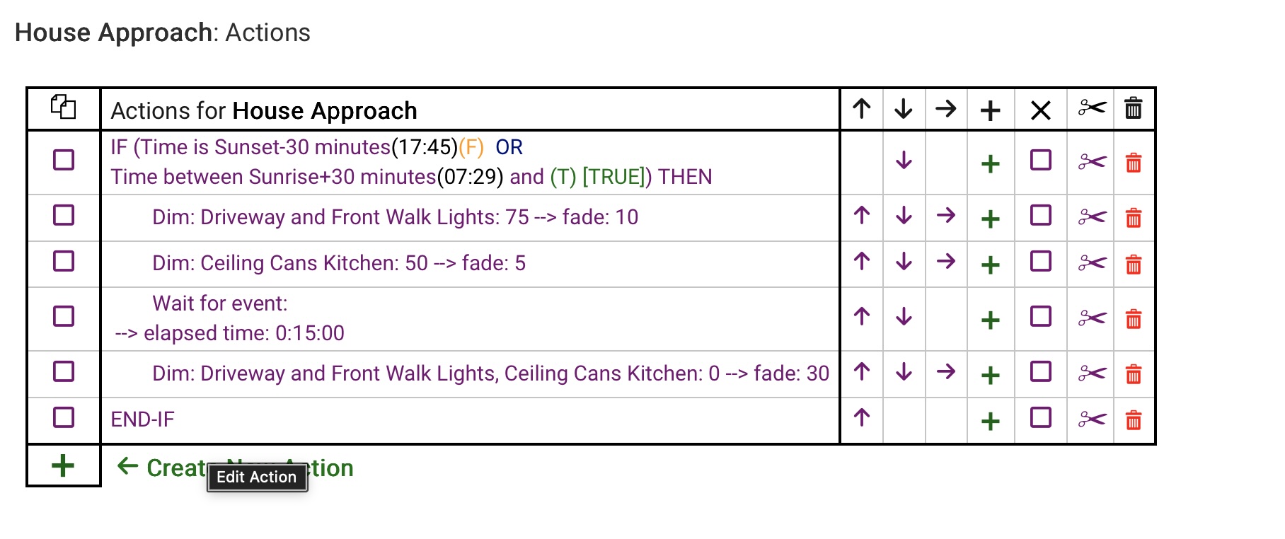

Here is what I have so far. I have not yet added the garage door function because I have not yet installed the device I bought to make it work. I have a Chamberlain opener so all the ways I have available are locked out (thanks, Chamberlain!). I forget the brand, but it is a device that mashes on the button of a regular sun-visor garage door opener button.

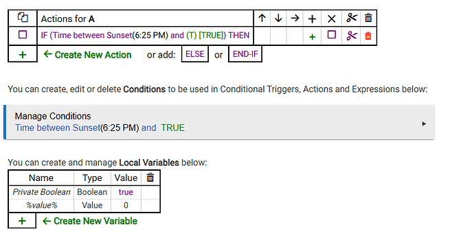

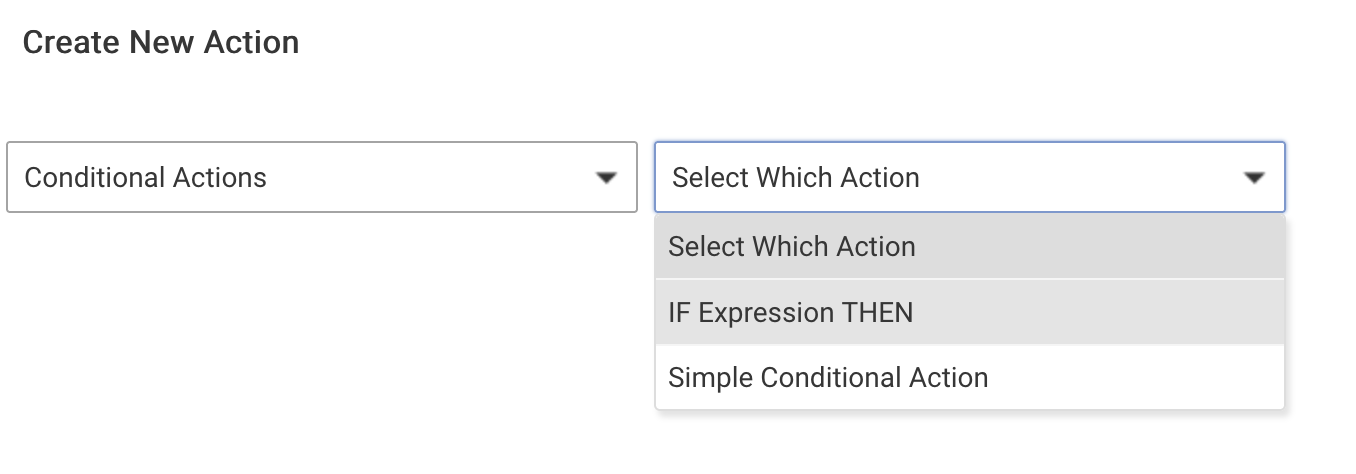

This is all Rule Machine, not code. Just add the "IF THEN" (and "END-IF," although there are also UI shortcuts that appear when you're likely to need them) from the menus the same way you add any other actions in your Rule.
I just this minute dived in and put this together. Again, the garage door button-masher isn't in-place yet.
Am I on the right track?

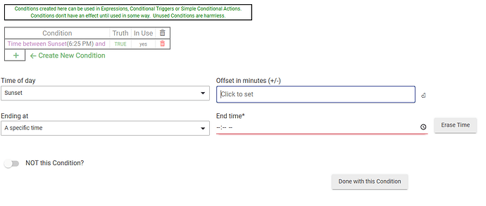

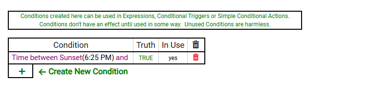

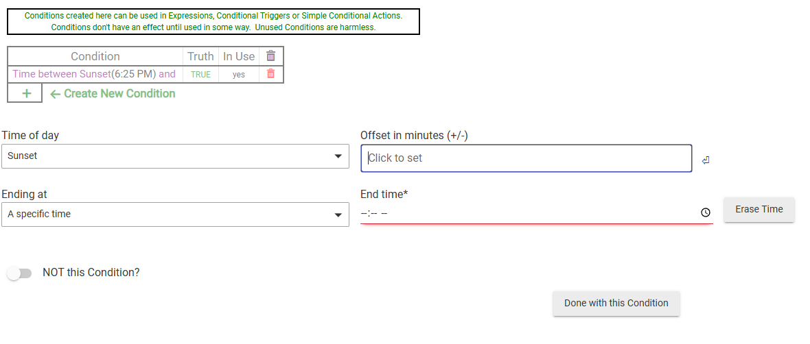

Close! But your expression is broken. You have two conditions, sunset-30 (which will be true at exactly that time only) and "Time between sunrise+30 and," which is incomplete as you are missing the end time. I assume you want a single condition like "Time between sunset-30 and sunrise+30", but once you figure out the logic for that, the rest sounds like what you want!
That's exactly what I want. I'm scratching my head and stroking my beard in thought but not sure what to do. Thanks very much for the help.

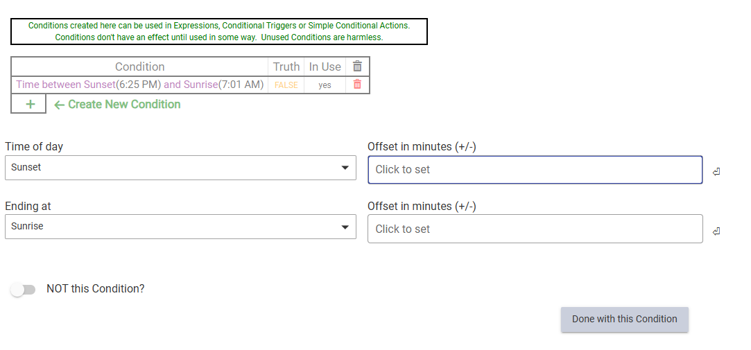

You already did it once in your example above, but there you just didn't finish the other side of the between.
Go into Actions
Click on Manage Conditions
Finish the Ending at Section with Sunrise
Click done with conditions
And it will be completed

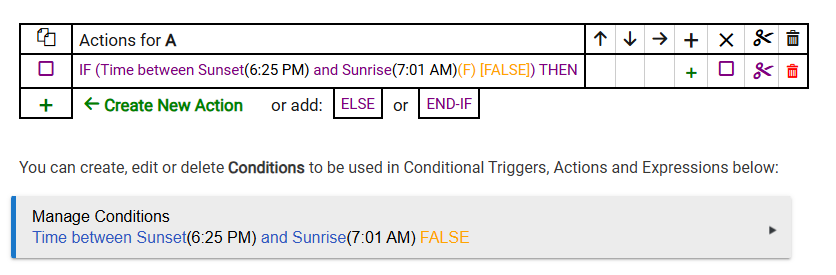

Pay VERY close attention to the order in which you click the “finished” or “done” buttons when writing rules. I you “finish” the ‘outer’ part of something before the ‘inner’ part. You will get broken rules like you had earlier.
