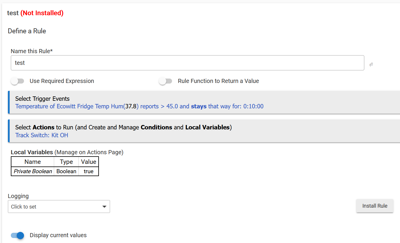

But both the Notifications app and Rule Machine can do "and stays".
Yeah, Simple Automation doesn't do that for temp either.
Rule Machine would look like below.
RM's a learning curve. I tried to stick with SA for the longest time. I'll still do that if I can, but now I probably have an equal number of rules in RM and SA.
@hydro311 , you use RM: what does "track switch" do? Yes, I should probably look it up. :slight_smile:
Never used it myself, but per Documentation (link jumps to correct section):
