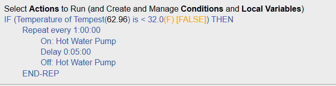

I am trying to write a repeating rule that when the temp drops below 32 degree it will turn a pump on for 5 minutes. Then off for 55 minutes. Then keep repeating until the temp goes above 32 degrees.
I have this so far but can't wrap my head around how to exit the repeat and or restart the repeat. I know I could have multiple rules to start or stop it but hoping to do it in one rule.
Thanks!!! I will have a virtual switch that will turn the rule on and off. We don't get freezes a lot but I just installed a hot water heater recirculating pump to help with instant hot water at some locations in my house. We have a sink on an outside wall that will freeze up during a hard freeze and I think this will solve that problem.
