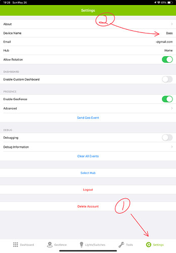

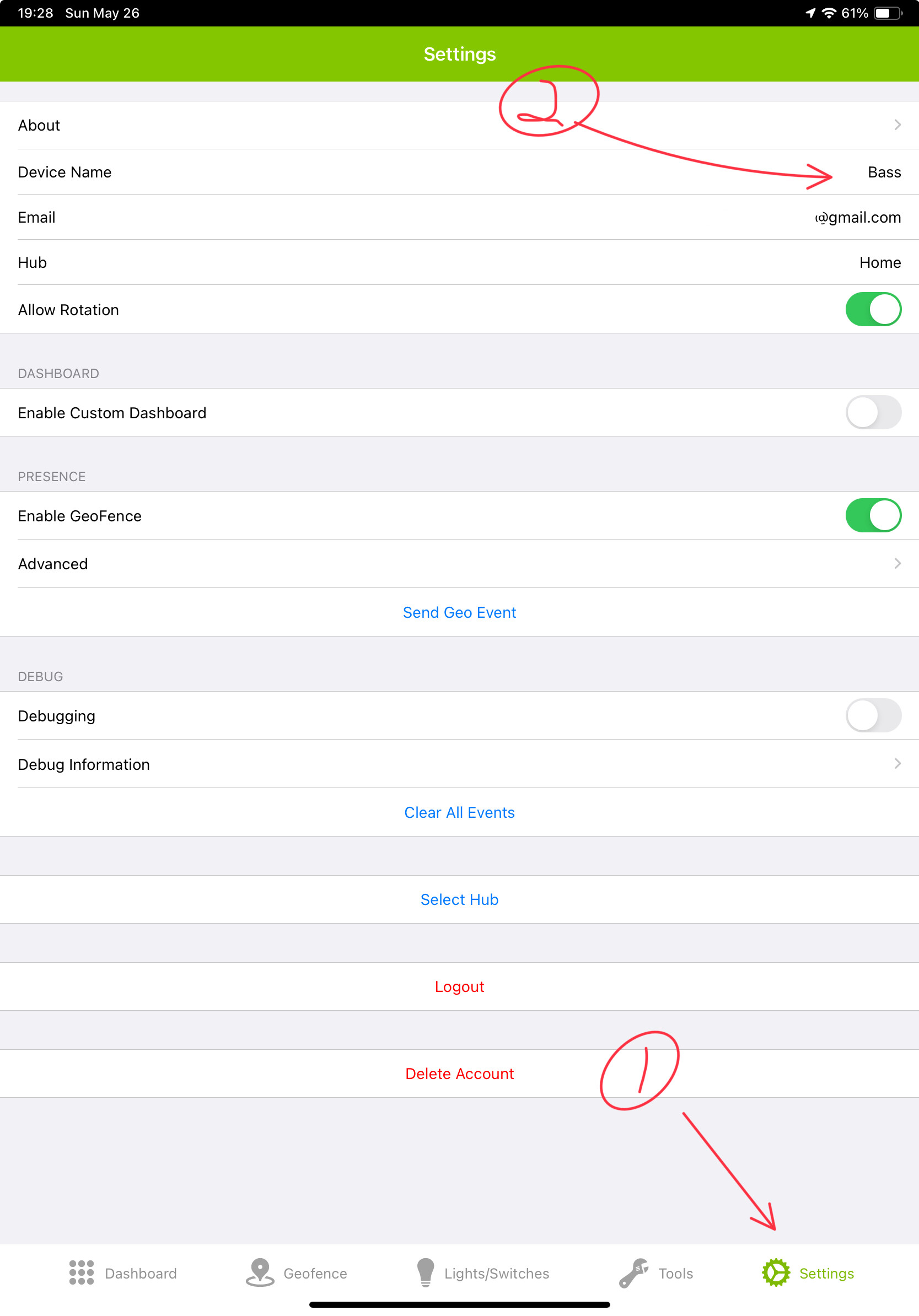

  1. Confirm what device your iPhone is linked to in the app:

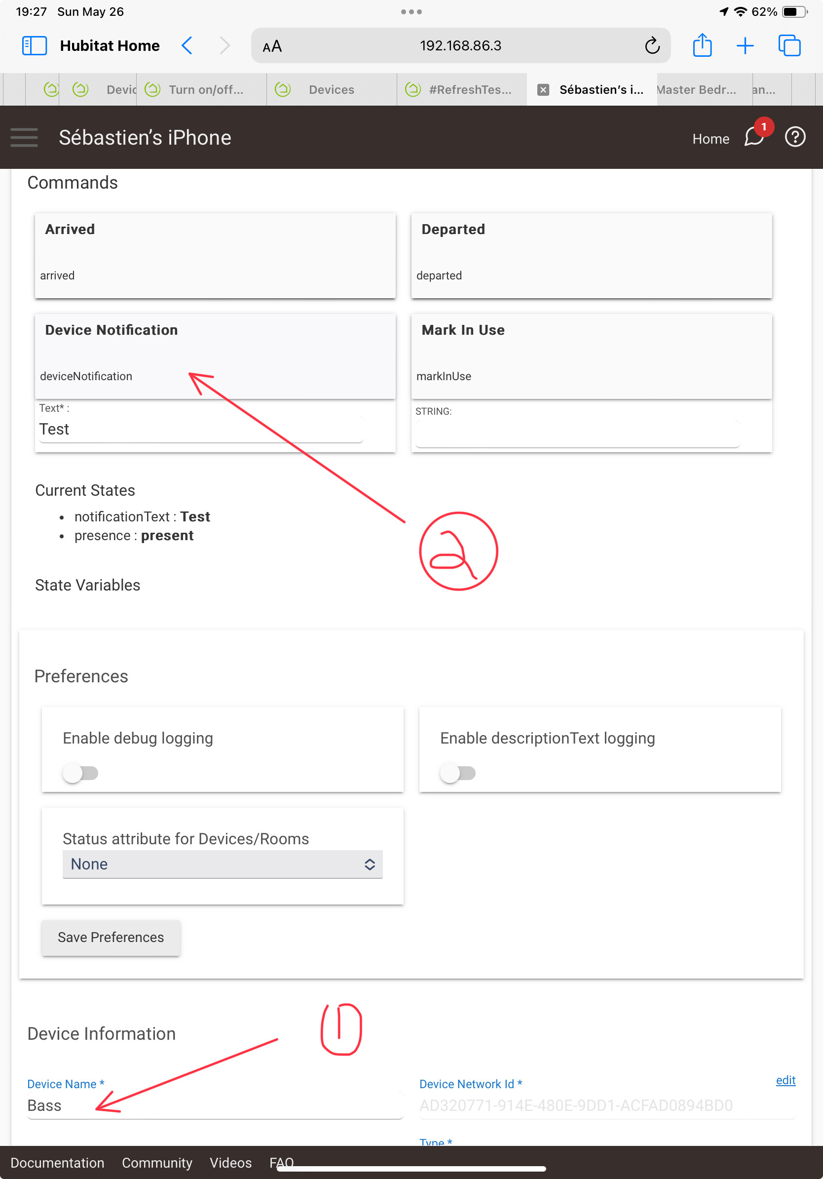

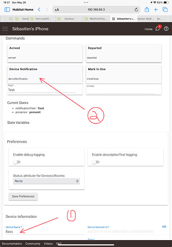

  3. Navigate to “Devices” and then search for or go to the one where the name matched the device name in step 1 above. From that screen, enter text in the “Device Notification” area (2) below, and click on the button above where you entered the text. You should get a notification on your phone when it is setup correctly.
