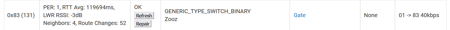

I'm looking at the z-wave details page here on a device that's on the edge. I think the logs show the same info. Can you do the same? Would it help?
C5 is very different in how it shows things.
I know you're trying to be helpful, but your posts are tangential to the issue.
@JustinL is assessing the z-wave mesh on his C-5, which uses an entirely different z-wave stack than the C-7 or C-8. The z-wave details and logs you are referring to are not available on that platform.
