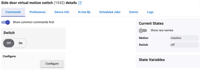

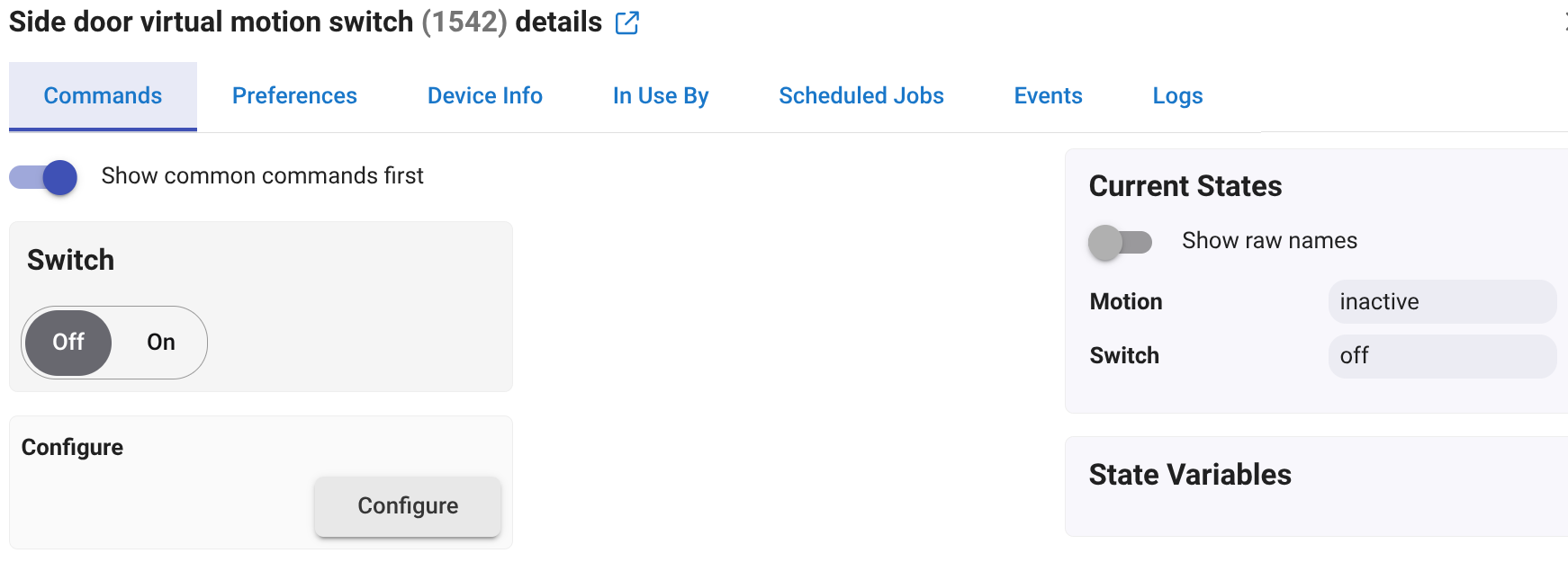

I think this might do what you are looking for. Alexa will not let you use a motion sensor. A solution is Virtual Switch uDTH Lite (user) It is a virtual motion sensor that reports as a switch which works for Alexa routines.
Thank you so much for pointing me to this. I added it and have a virtual device created with it setting it to be motion.
Now to figure out the rule machine part. I sometimes feel like rule machine is overkill for a simple task like what I’m trying to do.
