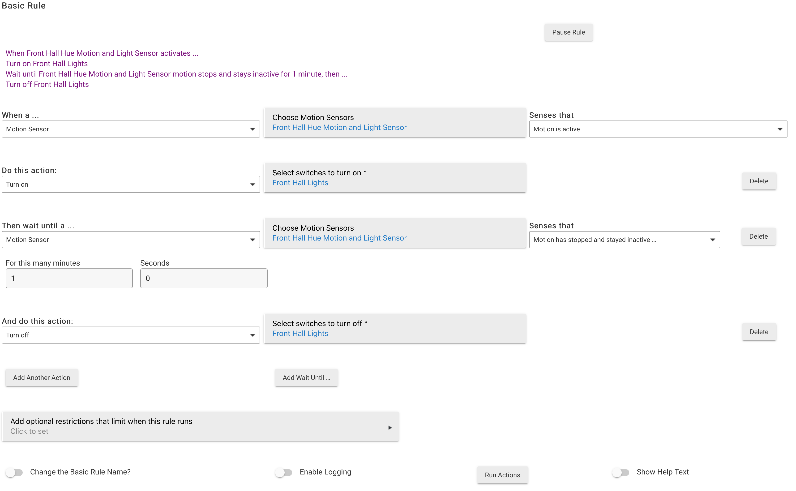

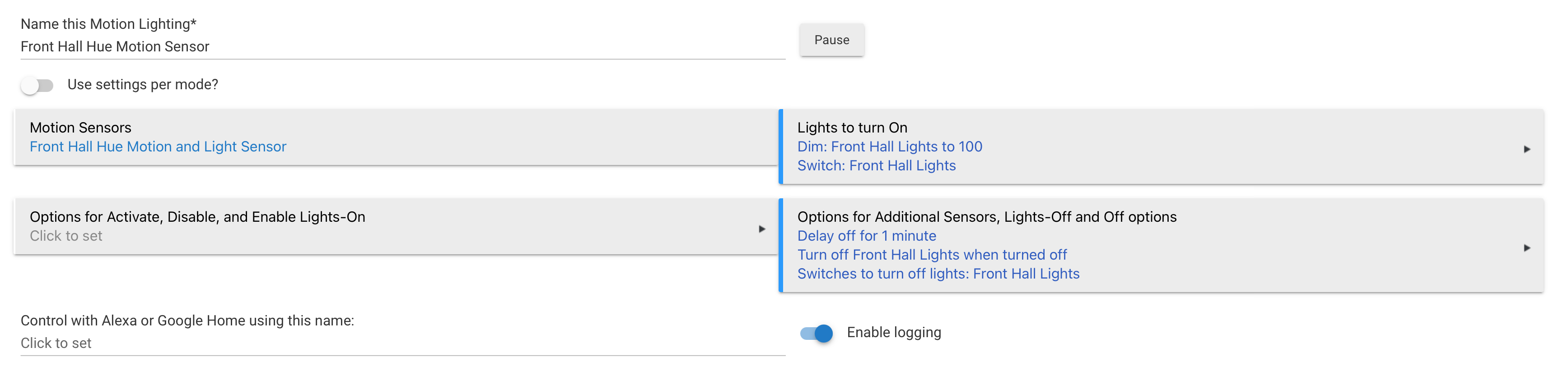

I happened to create 2 rules for my other Hue motion sensor (and just posted a different thread on which one should I delete). Could I clone either or those 2 and add the time or mode condition per above?
Here are those 2 existing app rules:
Basic Rule:
Motion and Mode Lighting rule:

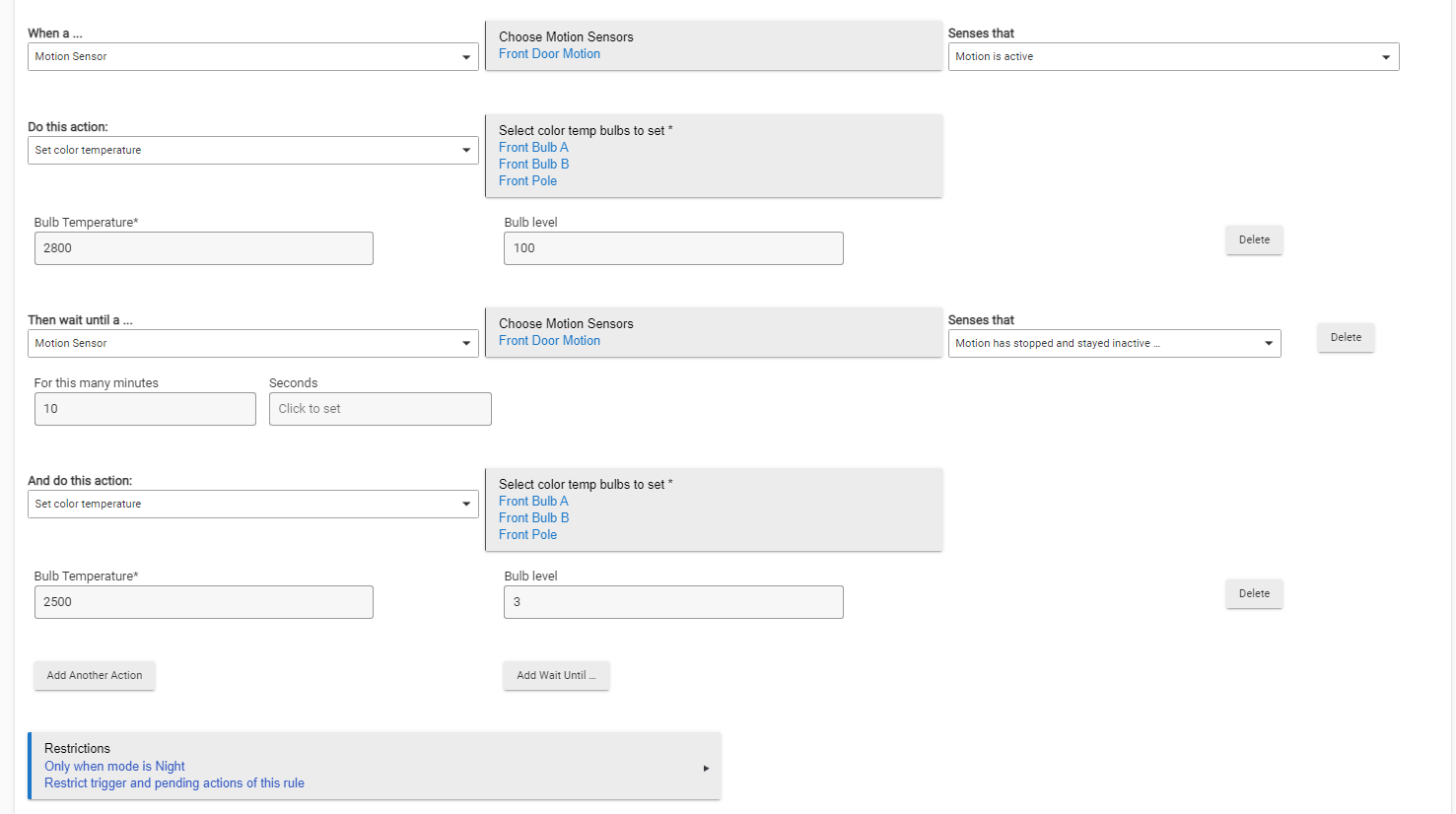

You'll probably get more people suggesting to use Rule Machine, but I find it as easy to run the case in Basic Rules with two rules restricted by mode or time. Here is how I handle your use case:

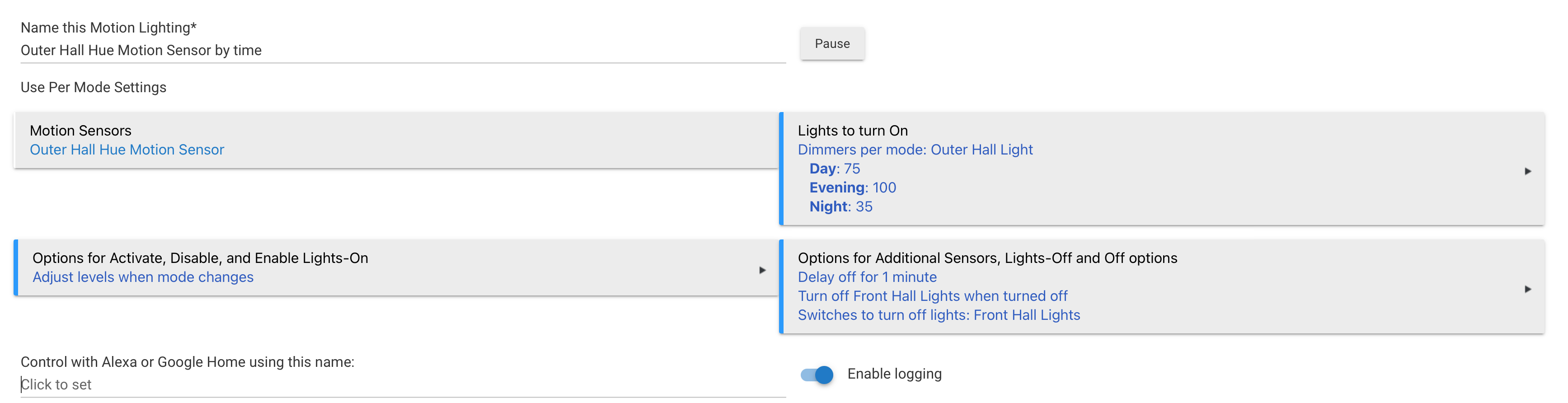

Thanks! I think I'm 99% of the way there. I got rid of the legacy Motion Manager and installed the new one. (Though that was after I set the Day/Evening/Night days in the legacy one first, which I thought was actually easier, clearer. But I get they want the consistent new table look).
I then found it was able to add those 3 modes in the Motion and Modes app so it looks like this:
The last piece of the puzzle is that I have an Alexa Good Night routine that turns on the Outer Hall light 35% for 2 minutes. The Motion and Mode rule I am creating turns the light off after 1 minute if motion is inactive. Since it is an Alexa routine I get that there is no way for Hubitat to know that.
I'm wondering how to work with that. One I idea it to create a virtual device in Hubitat that Alex would turn on, and then I hope I could have it that is on to ignore the rule. But, maybe there are better ways. Any ideas?

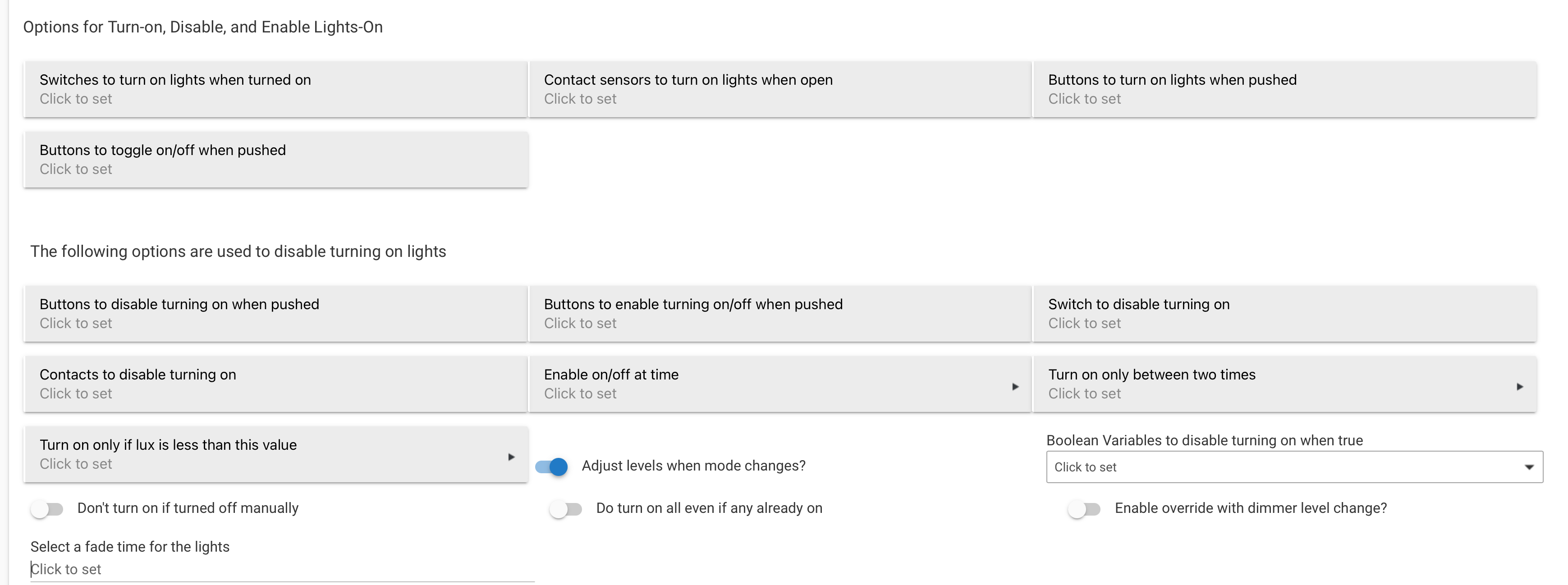

I found this options page, but I really don't understand if I could use it somehow to do what I want it to do.
