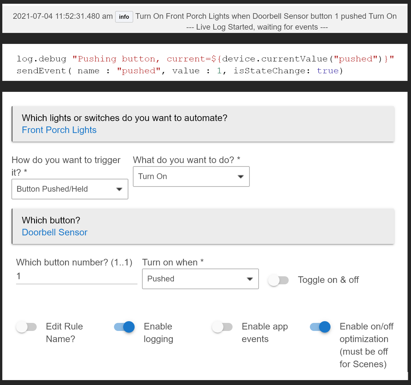

The screen shots below show three things:
  • The log from the simple automation rule, which I interpret as working, except that the light switch does not turn on.
  • The code in the device handler that sends the pushed event for button 1.
  • The simple automation rule.
What am I doing wrong? I have deleted the automation and recreated it. I've rebooted my hub. I can turn the switch on and off with the UI. And the doorbell button triggers another automation correctly, although admittedly it is also a home grown app. I suspect that my custom button handler is not doing something correctly but so far I have been unable to figure out what that is.
The log from the automation makes it look like it should work!
Any suggestions are appreciated.

Turn off the "Enable on/off optimization" option you see in the bottom right of your screenshot, and it should take care of that problem.
