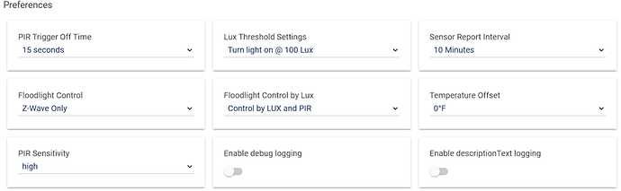

Here is a snap of the settings I’ve selected.
I want the PIR setting off at 30 seconds as I use the motion component to trigger other rules. Another oddity is that the Lux Threshold Settings always changes to “Turn Light on by PIR” despite me saving the preferences and them appearing to stick. When I reopen the device view, the though, it’s always reverted back to PIR.

Here are what my preferences are (not sure if they will help at all). Just make sure that any Rules you have do not switch the power on the Floodlight itself.
