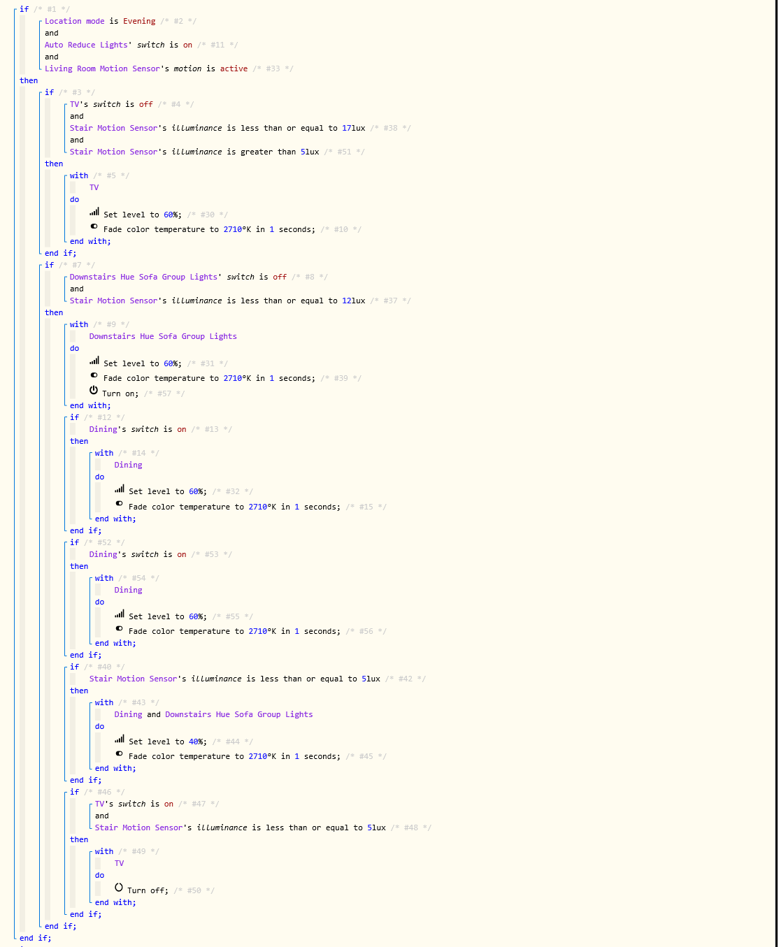

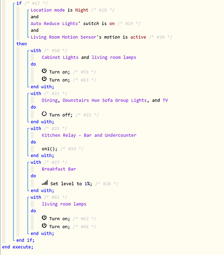

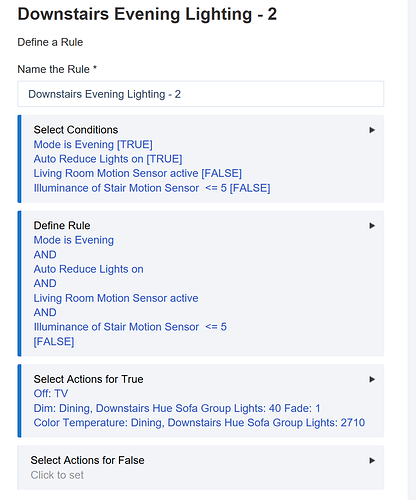

So, I've had a stab again at moving these to Rule Machine.
Does this look 'optimal'?
Thanks in advance!

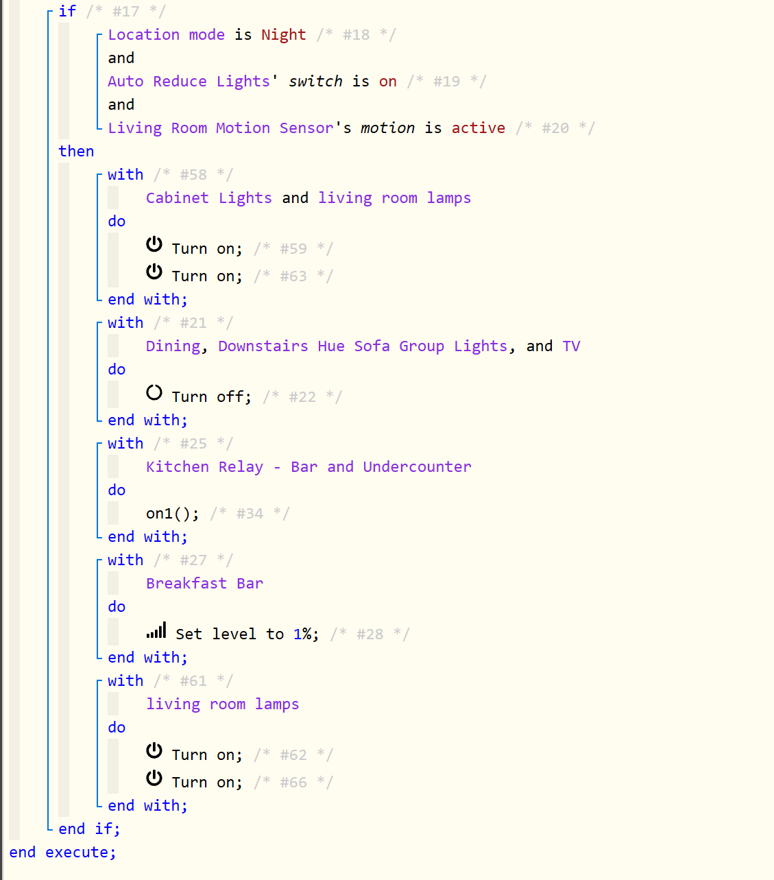

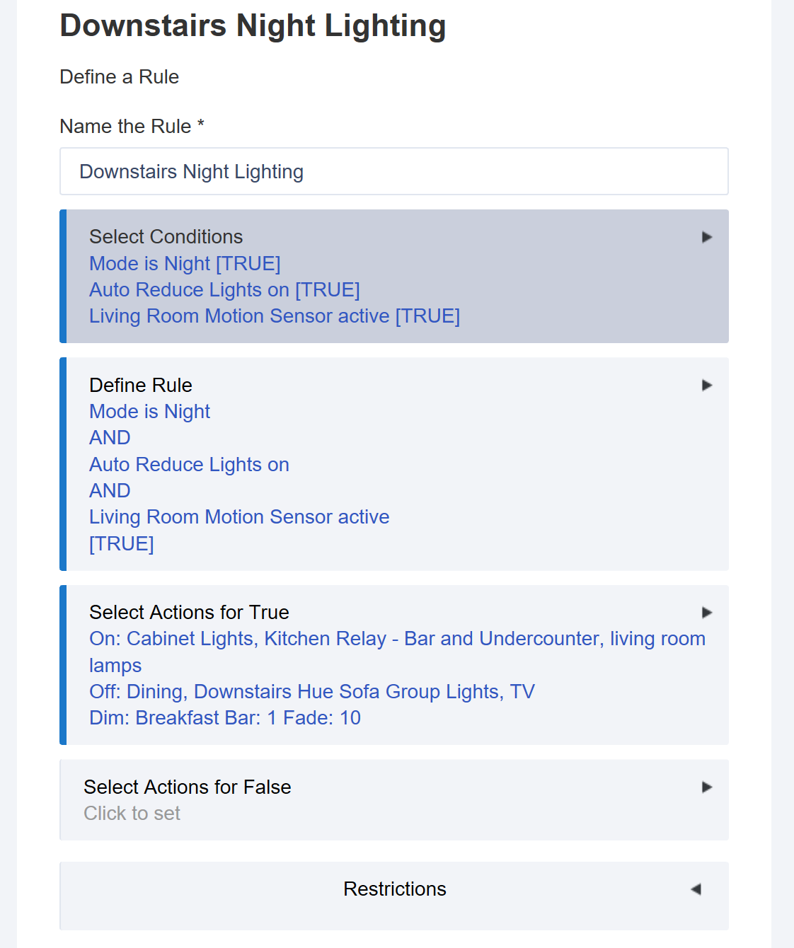

Night Mode Scene:

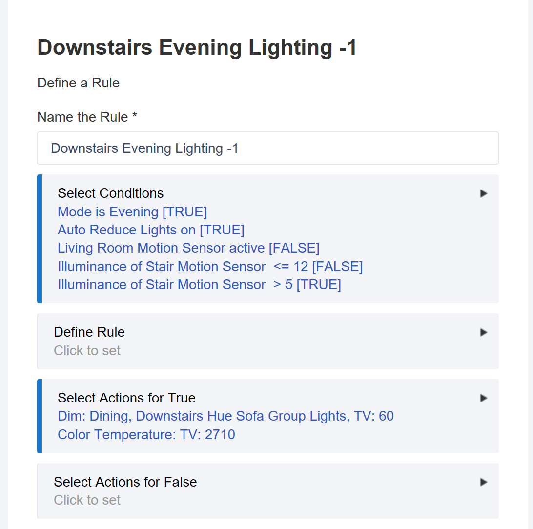

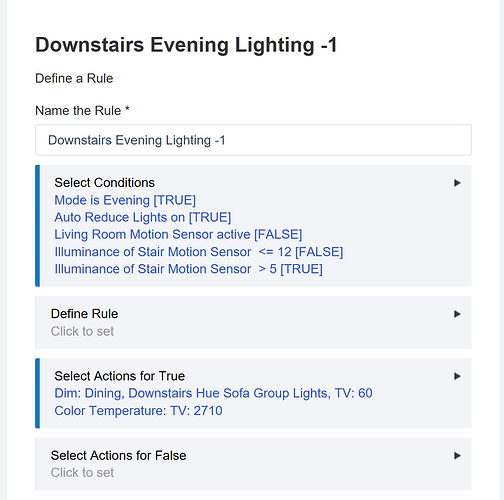

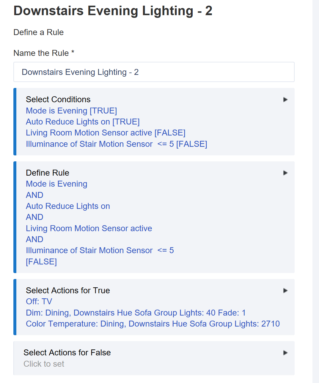

Evening Mode Scene: split in to two separate rules
I'm struggling with RM a bit, so I'm monitoring to see how you make out.
If I make some good progress I'll take another look.
Downstairs Evening Rule 1 has Conditions, but no Rule Defined. I'm thinking you caught that already. :slight_smile:
Illuminance is the tricky one there because many devices report only on 5% change or 1 hour.
Your Night Rule is a direct one for one of WebCoRE - so I imagine you'll be happy with that. :slight_smile:
Your Evening Pistons involve more devices, I can only guess you've simplified your automation intentionally. The result seems to be a good translation.
I'm going to guess that "Auto Reduce Lights' is a virtual switch - the antithesis of "Let's get this Party Started" switch... As such, you could move its functionality into a Restriction. In many Rules, restrictions are the "first barrier", since they get tested first and then allow the remaining tests to be skipped.
From this 8000 meter perch over here, it looks like a good job. :slight_smile:

Spotted the missing rule !
Illuminence : yes, thinking this really Isn’t doing much, certainly the second evening rule.
What I’m trying to achieve is to have the lights dim/become warmer as evening
progresses and then ultimately the night scene kicks in where the main lights go off and the lamps etc come on.
Thanks for the suggestion with the virtual switch. I’ll add this as a restriction. I use it to stop the automation from overriding
any manual adjustments to lights being made.
