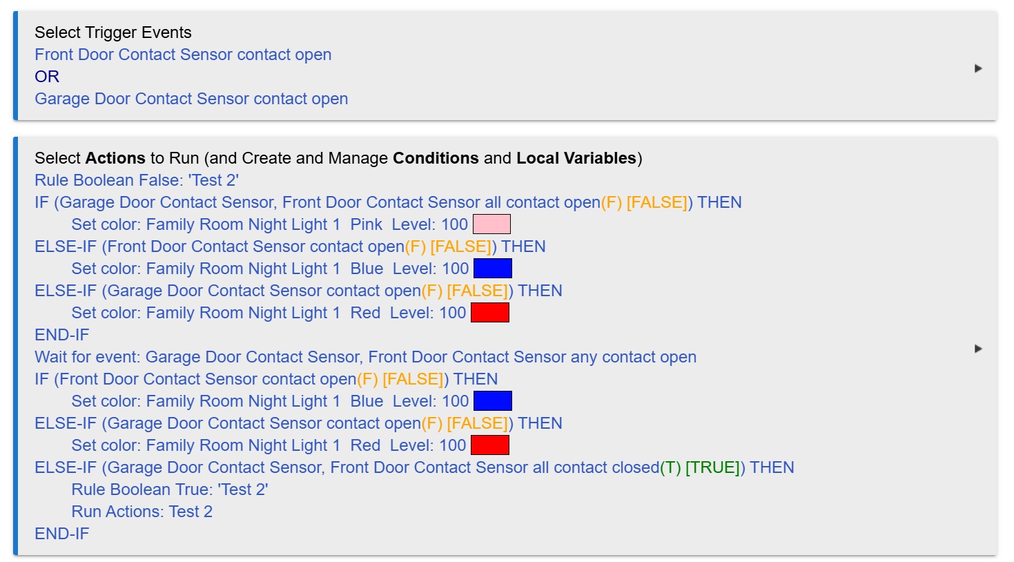

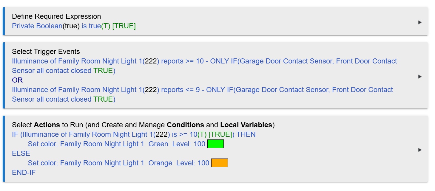

You'll need a fifth state to capture when both front and garage doors are open. With that said, it is possible to condense this down to two rules. First you need a rule to define the default state of the nightlight when both doors are closed based on Lux.
Basically if the doors are closed, your night light will be Green if Lux is above 10 and Orange if it is below 10. It has a Required Expression of the PB being True is which is used in your door open rule. This prevents a Lux reading from over-riding your doors.

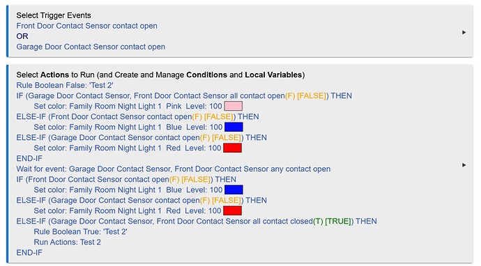

The door rule looks something like the following:
It sets the Lux rule's PB to false preventing it from running during this rule. Then, it sets the color based on three states: Both doors open, front door open only, and garage door open only. From there, it waits for one of the doors to close and then re-checks the two door states and sets the light according to whichever door might still be open. If both doors are closed, it sets the Lux rule's PB to True allowing it to run again and it additionally runs that rule's actions. This last step will set the nightlight to either Orange or Green depending on the Lux value.
Edit: I noticed an error in my sample. The Wait for Event says open when it should say closed.
