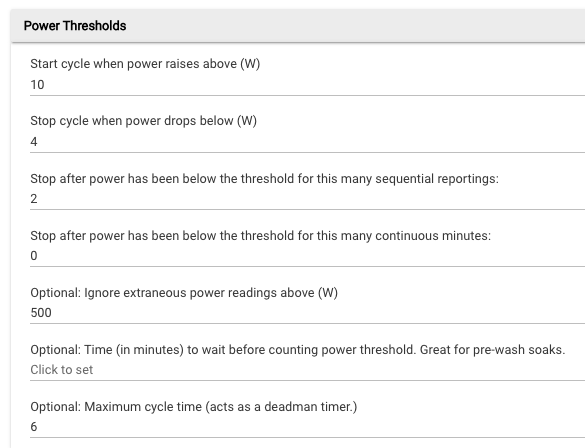

I made three experiments:
First, with the following settings:
The log results are:
app:904 2024-09-19 04:05:13.468 AM info Cycle finished.
app:904 2024-09-19 04:05:13.463 AM debug banner: today at 4:05am
app:904 2024-09-19 04:05:13.459 AM debug send: Washing is done!
app:904 2024-09-19 04:05:13.450 AM debug Power: 1W, State: true, thresholds: 10.0 4.0 2 0 optional: 500.0 null 6
dev:464 2024-09-19 04:05:13.416 AM debug pseudoPowerPlug setPower: 1
app:904 2024-09-19 04:05:10.299 AM debug We hit Power Delay 1 times
app:904 2024-09-19 04:05:10.279 AM debug Power: 2W, State: true, thresholds: 10.0 4.0 2 0 optional: 500.0 null 6
dev:464 2024-09-19 04:05:10.201 AM debug pseudoPowerPlug setPower: 2
app:904 2024-09-19 04:05:06.664 AM debug We hit the Power Delay 1 times but cleared it
app:904 2024-09-19 04:05:06.657 AM debug Power: 5W, State: true, thresholds: 10.0 4.0 2 0 optional: 500.0 null 6
dev:464 2024-09-19 04:05:06.608 AM debug pseudoPowerPlug setPower: 5
app:904 2024-09-19 04:05:02.706 AM debug We hit Power Delay 1 times
app:904 2024-09-19 04:05:02.701 AM debug Power: 3W, State: true, thresholds: 10.0 4.0 2 0 optional: 500.0 null 6
dev:464 2024-09-19 04:05:02.652 AM debug pseudoPowerPlug setPower: 3
app:904 2024-09-19 04:04:55.074 AM debug Power: 4W, State: true, thresholds: 10.0 4.0 2 0 optional: 500.0 null 6
dev:464 2024-09-19 04:04:55.025 AM debug pseudoPowerPlug setPower: 4
app:904 2024-09-19 04:04:49.548 AM debug Power: 77W, State: true, thresholds: 10.0 4.0 2 0 optional: 500.0 null 6
dev:464 2024-09-19 04:04:49.392 AM debug pseudoPowerPlug setPower: 77
app:904 2024-09-19 04:04:39.978 AM info Cycle started.
app:904 2024-09-19 04:04:39.964 AM debug banner: today at 4:04am
app:904 2024-09-19 04:04:39.928 AM debug send: Washing has started!
app:904 2024-09-19 04:04:39.922 AM debug Power: 90W, State: false, thresholds: 10.0 4.0 2 0 optional: 500.0 null 6
dev:464 2024-09-19 04:04:39.658 AM debug pseudoPowerPlug setPower: 90
- Power hit 90 watts and started the Cycle because it is higher than the Start Cycle value of 10 watts.
- Power hit 77 watts and nothing changed, still higher than the Start Cycle value of 10 watts.
- Power hit 4 watts and nothing changed, not below the End Cycle value of 4 watts.
- Power hit 3 watts, below the End Cycle value of 4 watts for 1 time.
- Power hit 5 watts, above the End Cycle value and the counter was reset.
- Power hit 2 watts, below the End Cycle value of 4 watts for 1 time.
- Power hit 1 watts, below the End Cycle value of 4 watts for a 2nd time and the Cycle ended.

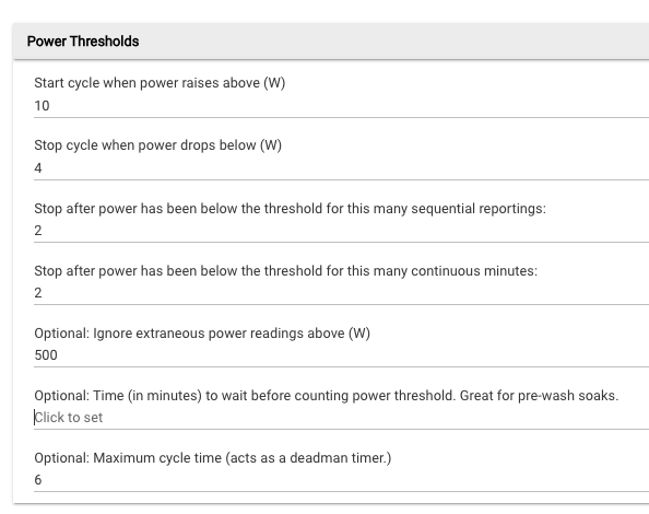

Second, with the following settings:
The difference is "Stop after power has been below the threshold for this many minutes" was set to 2.
app:904 2024-09-19 04:12:26.308 AM info Cycle finished after delay.
app:904 2024-09-19 04:12:26.303 AM debug banner: today at 4:12am
app:904 2024-09-19 04:12:26.290 AM debug send: Washing is done!
app:904 2024-09-19 04:10:26.256 AM debug Ending duration is set, waiting 2 minutes
app:904 2024-09-19 04:10:26.248 AM debug Power: 1W, State: true, thresholds: 10.0 4.0 2 2 optional: 500.0 null 6
dev:464 2024-09-19 04:10:26.206 AM debug pseudoPowerPlug setPower: 1
app:904 2024-09-19 04:10:21.728 AM debug We hit Power Delay 1 times
app:904 2024-09-19 04:10:21.719 AM debug Power: 2W, State: true, thresholds: 10.0 4.0 2 2 optional: 500.0 null 6
dev:464 2024-09-19 04:10:21.667 AM debug pseudoPowerPlug setPower: 2
app:904 2024-09-19 04:10:14.088 AM debug We hit the Power Delay 1 times but cleared it
app:904 2024-09-19 04:10:14.082 AM debug Power: 5W, State: true, thresholds: 10.0 4.0 2 2 optional: 500.0 null 6
dev:464 2024-09-19 04:10:13.941 AM debug pseudoPowerPlug setPower: 5
app:904 2024-09-19 04:10:10.747 AM debug We hit Power Delay 1 times
app:904 2024-09-19 04:10:10.743 AM debug Power: 3W, State: true, thresholds: 10.0 4.0 2 2 optional: 500.0 null 6
dev:464 2024-09-19 04:10:10.685 AM debug pseudoPowerPlug setPower: 3
app:904 2024-09-19 04:10:07.093 AM debug Power: 4W, State: true, thresholds: 10.0 4.0 2 2 optional: 500.0 null 6
dev:464 2024-09-19 04:10:06.948 AM debug pseudoPowerPlug setPower: 4
app:904 2024-09-19 04:09:58.028 AM debug Power: 78W, State: true, thresholds: 10.0 4.0 2 2 optional: 500.0 null 6
dev:464 2024-09-19 04:09:57.978 AM debug pseudoPowerPlug setPower: 78
app:904 2024-09-19 04:09:49.499 AM info Cycle started.
app:904 2024-09-19 04:09:49.494 AM debug banner: today at 4:09am
app:904 2024-09-19 04:09:49.487 AM debug send: Washing has started!
app:904 2024-09-19 04:09:49.482 AM debug Power: 98W, State: false, thresholds: 10.0 4.0 2 2 optional: 500.0 null 6
dev:464 2024-09-19 04:09:49.411 AM debug pseudoPowerPlug setPower: 98
- Power hit 98 watts and started the Cycle because it is higher than the Start Cycle value of 10 watts.
- Power hit 78 watts and nothing changed, still higher than the Start Cycle value of 10 watts.
- Power hit 1 watts, below the End Cycle value of 4 watts for a 2nd time and the EndCycleDelay started.
- 2 minutes later, the Cycle ended.
Third, with the exact same settings:
app:904 2024-09-19 04:36:09.917 AM info Cycle finished after delay.
app:904 2024-09-19 04:36:09.913 AM debug banner: today at 4:36am
app:904 2024-09-19 04:36:09.905 AM debug send: Washing is done!
app:904 2024-09-19 04:34:09.885 AM debug Ending duration is set, waiting 2 minutes
app:904 2024-09-19 04:34:09.861 AM debug Power: 2W, State: true, thresholds: 10.0 4.0 2 2 optional: 500.0 null 6
dev:464 2024-09-19 04:34:09.831 AM debug pseudoPowerPlug setPower: 2
app:904 2024-09-19 04:34:05.427 AM debug We hit Power Delay 1 times
app:904 2024-09-19 04:34:05.389 AM debug Power: 3W, State: true, thresholds: 10.0 4.0 2 2 optional: 500.0 null 6
dev:464 2024-09-19 04:34:05.353 AM debug pseudoPowerPlug setPower: 3
app:904 2024-09-19 04:33:33.751 AM debug Power resumed during timeout
app:904 2024-09-19 04:31:57.843 AM debug We hit the Power Delay 1 times but cleared it
app:904 2024-09-19 04:31:57.839 AM debug Power: 33W, State: true, thresholds: 10.0 4.0 2 2 optional: 500.0 null 6
dev:464 2024-09-19 04:31:57.796 AM debug pseudoPowerPlug setPower: 33
app:904 2024-09-19 04:31:50.773 AM debug Resetting end timer
app:904 2024-09-19 04:31:50.758 AM debug Power: 6W, State: true, thresholds: 10.0 4.0 2 2 optional: 500.0 null 6
dev:464 2024-09-19 04:31:50.707 AM debug pseudoPowerPlug setPower: 6
app:904 2024-09-19 04:31:33.728 AM debug Ending duration is set, waiting 2 minutes
app:904 2024-09-19 04:31:33.716 AM debug Power: 1W, State: true, thresholds: 10.0 4.0 2 2 optional: 500.0 null 6
dev:464 2024-09-19 04:31:33.690 AM debug pseudoPowerPlug setPower: 1
app:904 2024-09-19 04:31:29.631 AM debug We hit Power Delay 1 times
app:904 2024-09-19 04:31:29.625 AM debug Power: 2W, State: true, thresholds: 10.0 4.0 2 2 optional: 500.0 null 6
dev:464 2024-09-19 04:31:29.522 AM debug pseudoPowerPlug setPower: 2
app:904 2024-09-19 04:31:25.975 AM debug We hit the Power Delay 1 times but cleared it
app:904 2024-09-19 04:31:25.971 AM debug Power: 5W, State: true, thresholds: 10.0 4.0 2 2 optional: 500.0 null 6
dev:464 2024-09-19 04:31:25.913 AM debug pseudoPowerPlug setPower: 5
app:904 2024-09-19 04:31:22.332 AM debug We hit Power Delay 1 times
app:904 2024-09-19 04:31:22.327 AM debug Power: 3W, State: true, thresholds: 10.0 4.0 2 2 optional: 500.0 null 6
dev:464 2024-09-19 04:31:22.192 AM debug pseudoPowerPlug setPower: 3
app:904 2024-09-19 04:31:18.555 AM debug Power: 4W, State: true, thresholds: 10.0 4.0 2 2 optional: 500.0 null 6
dev:464 2024-09-19 04:31:18.419 AM debug pseudoPowerPlug setPower: 4
app:904 2024-09-19 04:30:55.949 AM debug Power: 73W, State: true, thresholds: 10.0 4.0 2 2 optional: 500.0 null 6
dev:464 2024-09-19 04:30:55.889 AM debug pseudoPowerPlug setPower: 73
app:904 2024-09-19 04:30:42.254 AM info Cycle started.
app:904 2024-09-19 04:30:42.248 AM debug banner: today at 4:30am
app:904 2024-09-19 04:30:42.200 AM debug send: Washing has started!
app:904 2024-09-19 04:30:42.116 AM debug Power: 93W, State: false, thresholds: 10.0 4.0 2 2 optional: 500.0 null 6
dev:464 2024-09-19 04:30:42.067 AM debug pseudoPowerPlug setPower: 93
- Power hit 93 watts and started the Cycle because it is higher than the Start Cycle value of 10 watts.
- Power hit 73 watts and nothing changed, still higher than the Start Cycle value of 10 watts.
- Before the Delay could expire, power hit 6 watts and reset the delay.
- Power hit 33 watts and cleared the cycle end.
- Power hit 2 watts, below the End Cycle value of 4 watts for a 2nd time and the EndCycleDelay started.
All the results are what I'm expecting, which isn't surprising since I wrote it to work that way.
Some of the injected power values are 'invisible' in the sense that they don't alter the trajectory of the cycle. Dropping power to the exact threshold and having it be ignored, just proves that "below" is actually coded correctly, for example.
Thanks for the detailed reply, I'm sure it works how you intened, i must have missed something.
When i was looking at/debugging my version (which didn't alter the structure too much, but obviously i must have) I was noticing that if the the cycleEnding was set (due to 1 event below threshold) and an 'above' event happened the first 'if' statement triggered but then the remaining 'else if's were skipped (obviously) therefore skipping the reset of the powerDelay. Then on the next 'below' event the end of the cycle was triggered.
So then it's obvious that I introduced the issue, it works ok now in my version which better suits my operating/reporting conditions.
In any event, thanks again and sorry to have bugged you. Next beer's on me
