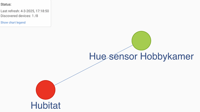

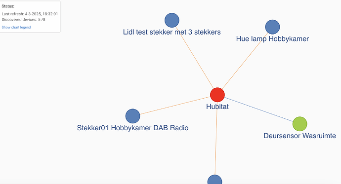

This suggests that Zigbee is working, but in the graphical overview, I only see this—while there should be a lot more devices.

I do see (some) Zigbee environment in the Zigbee graphical interface.

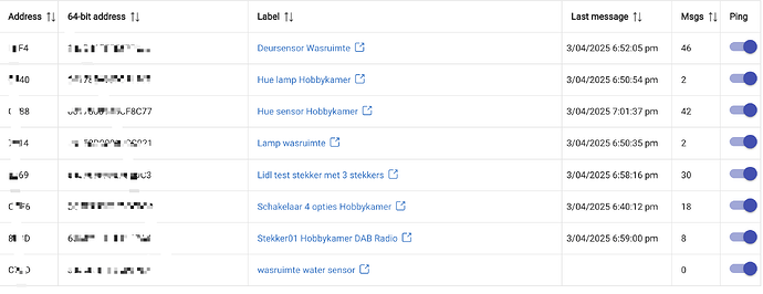

and the devices are seen also by Hubitat:
i cant understand this issue?

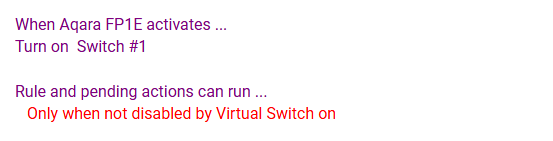

Can you post a screenshot of one of the automations (rules) that is not working as expected?
Your last screenshot here shows that you have seven Zigbee devices communicating to your hub. The Water sensor may be working as well, it is a sleepy device and sends battery reports rarely, that's why we have zero messages received.

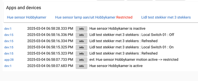

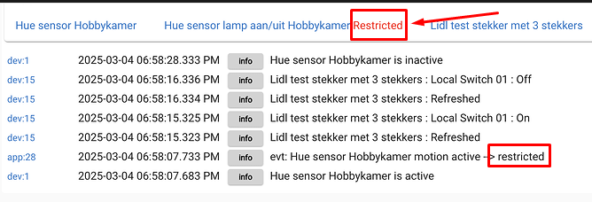

Update: your rule seems to be not running because it is Restricted ?
Make a screenshot of this rule.
https://docs2.hubitat.com/en/apps/basic-rules
Search the web page for 'restriction'
Note that the condition defined by the restriction must be true for the rule to run.

Regarding your question about "restricted": this was a motion sensor rule,
and in the restricted section, it was set to do nothing if the lux level was higher than 20 (so the lights should not turn on).
This actually worked very well, I must say.

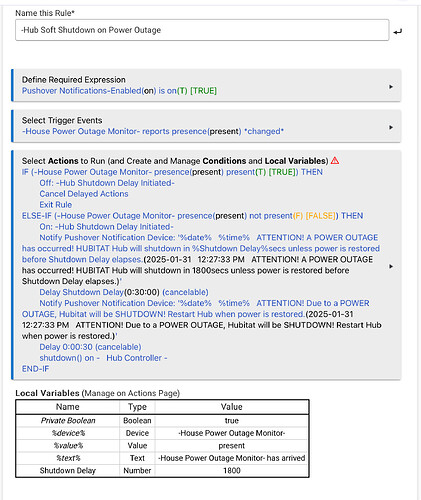

When you get things back up and going there is an application in Hubitat Package Manager that will allow shut down of the hub in this case. It is called Power Outage Manager. You can connect a device that runs off main power and switches to a battery when the power goes out. Power Outage Manager can be set up to notify you when the power goes out and comes back on. It can also be set up to gracefully shut down the hub after some period of time with the power out. I have used it for a while and it works great. You should look into it when you get things back to going.

“When you get things back up and going there is an application in Hubitat Package Manager that will allow shut down of the hub in this case. It is called Power Outage Manager.”

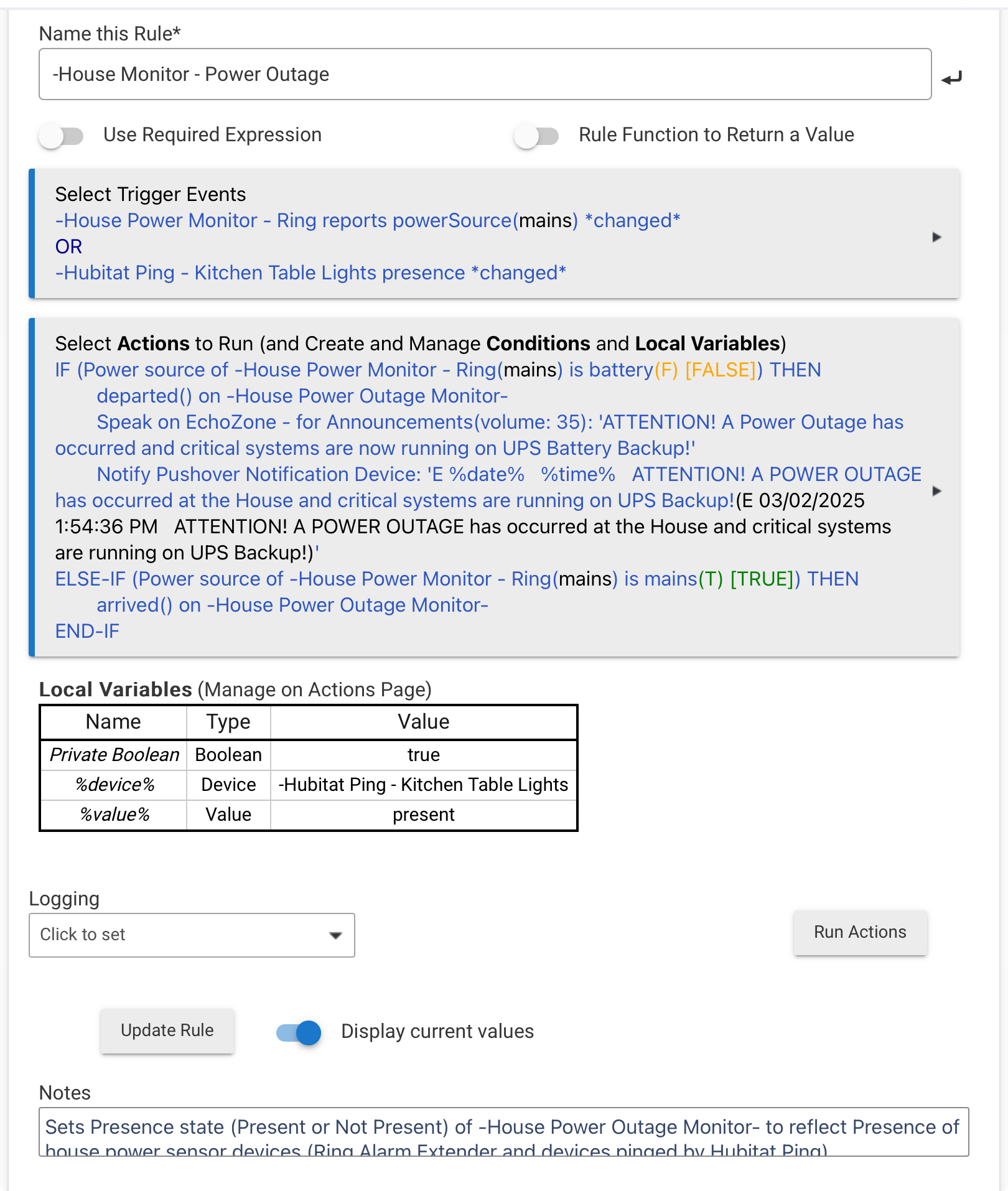

That sounds great. I did not know that Power Outage Manager existed :laughing: . Several years ago I made a RM app that did essentially the same thing along with push notifications to let me know what was going on. I was able to get notifications since everything is on a UPS (hub, wifi, modem etc):
My “-House Power Outage Monitor-“ is a presence sensor rule that monitors whether my Ring Alarm Extender (I do not have a Ring Alarm but use the extender as it reports whether it is on battery power or mains) is running on battery power:
I have not yet checked out the “Power Outage Manager” app in HPM but it sounds like it is a much simpler way to achieve what I did in RM :joy:.
