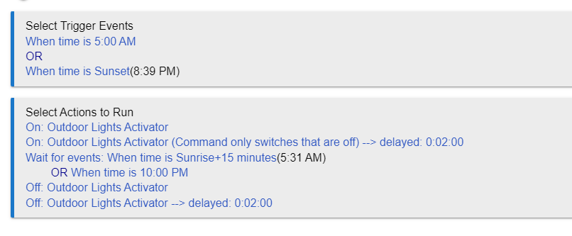

I was also using SAR for this same type of automation and it worked. I had two setup, one for evening and one for morning. Then I had this idea to combine them into one simple RM rule. I like this rule because it does not "wait" overnight with the chance of being canceled from a reboot or other activities. The ON is always triggered and then it waits for the OFF.
The double ON activations is optional. I was having a problematic light that was being slow so I did this to make sure it turned on/off.
That doesn't look like Simple Automations...are you showing a Basic Rule or a Rule Machine rule?

Since OP mentioned possibly going to RM I was giving an example.
OK, thanks. :slight_smile: I must have stopped reading after the first sentence... :wink:
