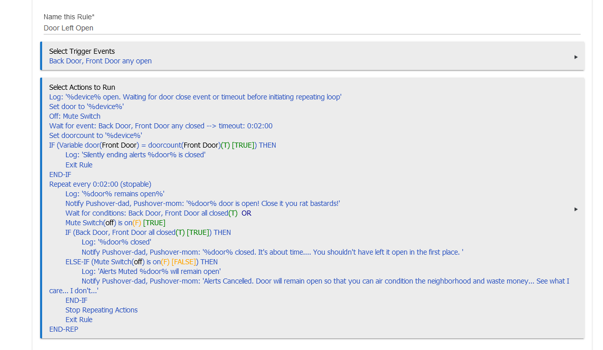

I can't take credit for this but this works well for me (someone helped me with the rule)
When door opens it starts to go into a 2 minute countdown of repeatable notifications. It is either stopped by the door closing or if I need to leave it open a virtual button... Here
