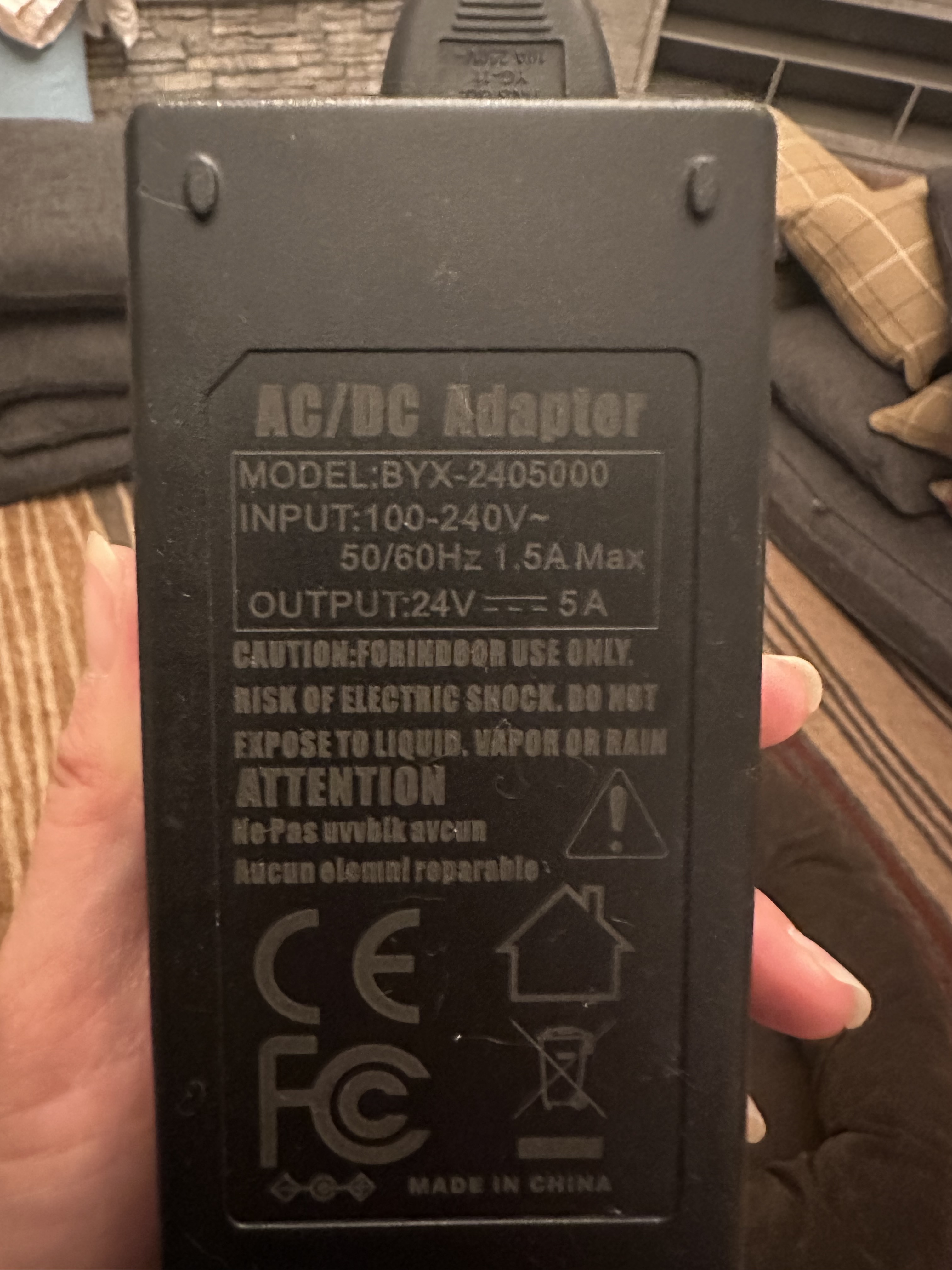

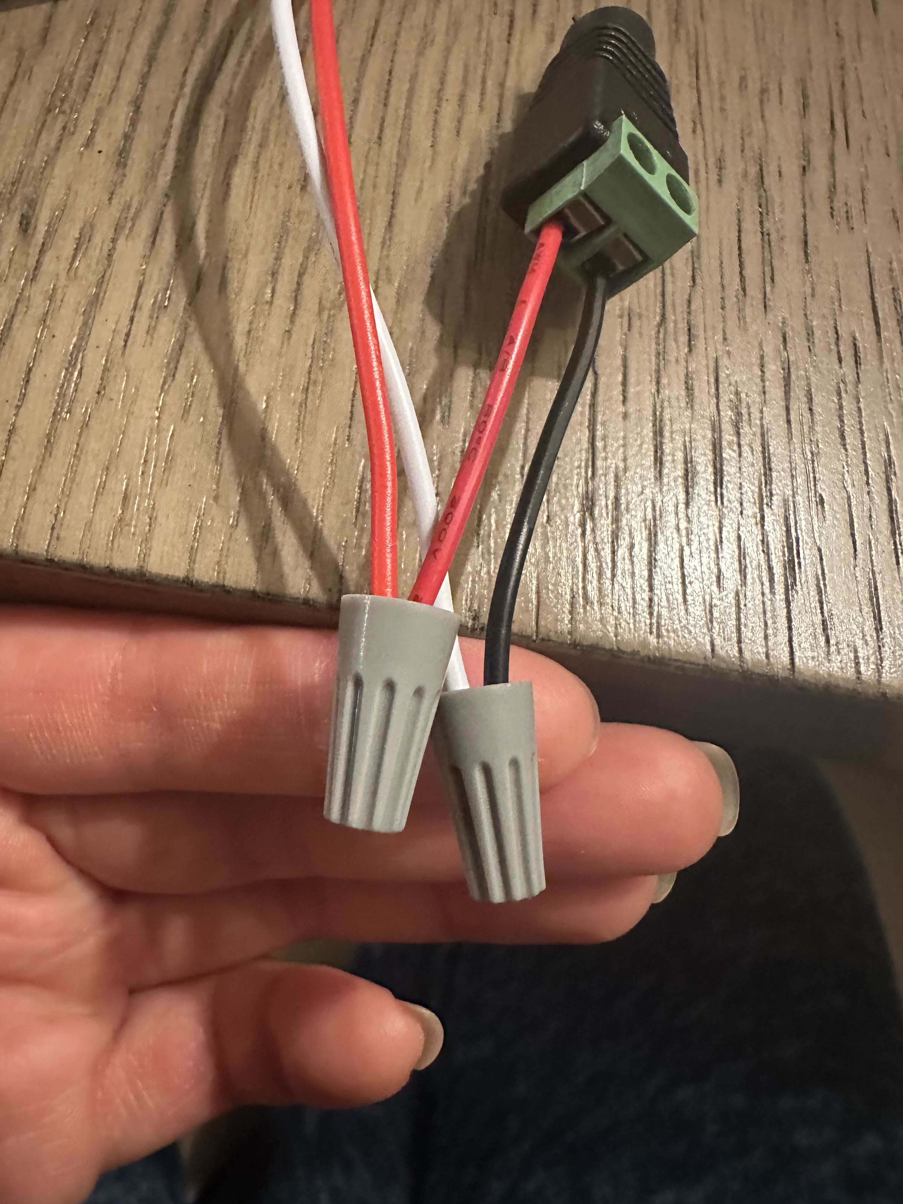

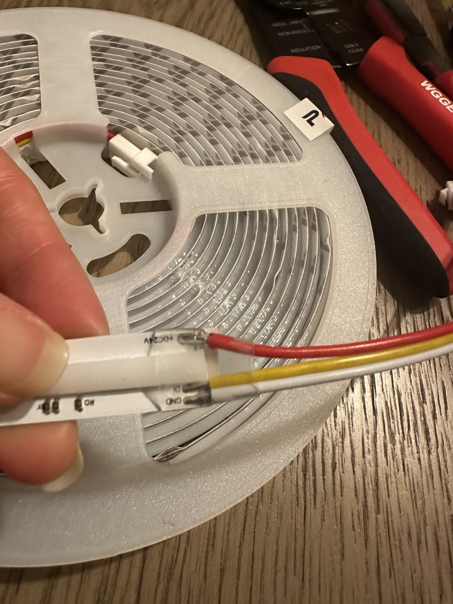

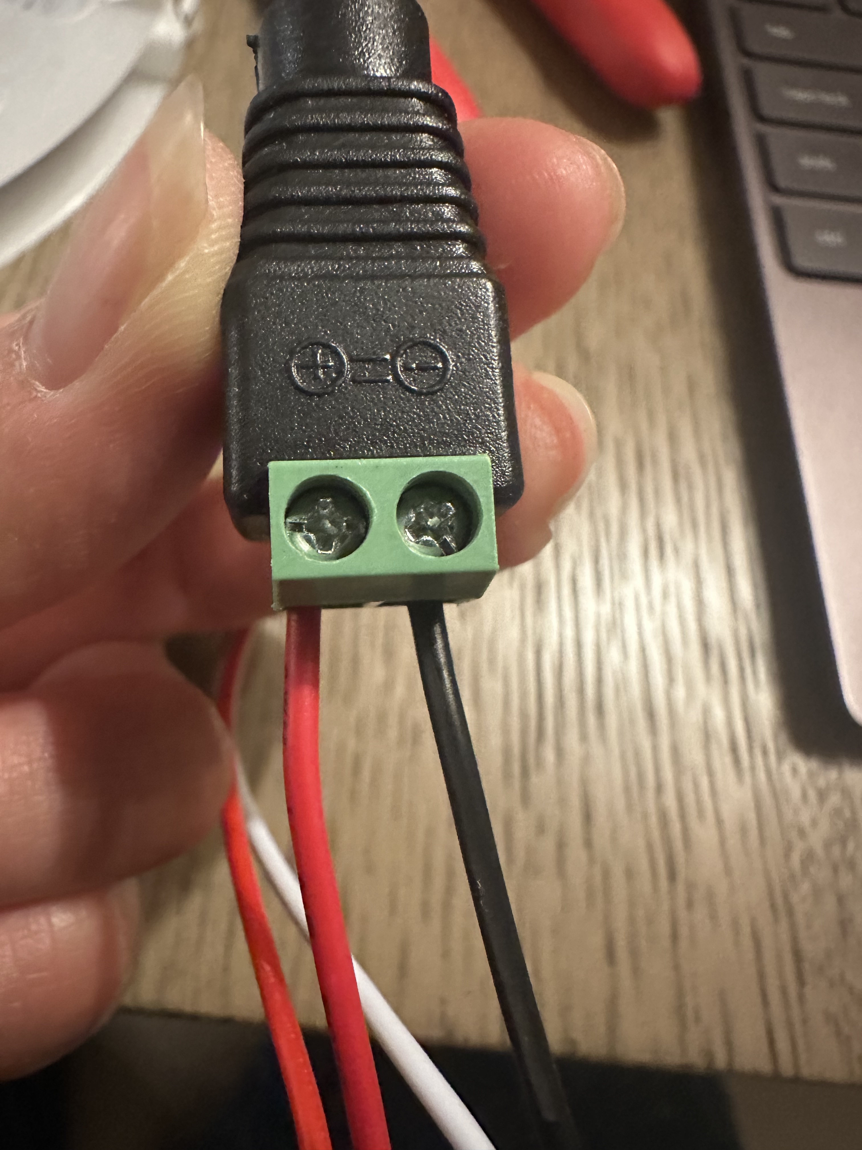

I feel like an absolute dumb-dumb lol. Can someone tell me what I’m doing wrong? All I’m trying to do is turn on these LED strips (no controller).
LED Strips: PAUTIX RGB Smart IC COB LED Strip Light Addressable 16.4ft/5m,UL-Listed 24V
Power Supply: PAUTIX 24V DC Power Supply Adapter 24Volt 5A 120W AC to DC Converter Transformer 100-240V AC Input with 5.5 x 2.1mm US Plug for LED Strip
All I’m doing is connecting the +24V and Ground to the Power Supply and it’s not turning on :frowning:
Because this is an addressable strip it will not be on without a controller.
Occasionally it may flickering if it will pickup noise on a data line.

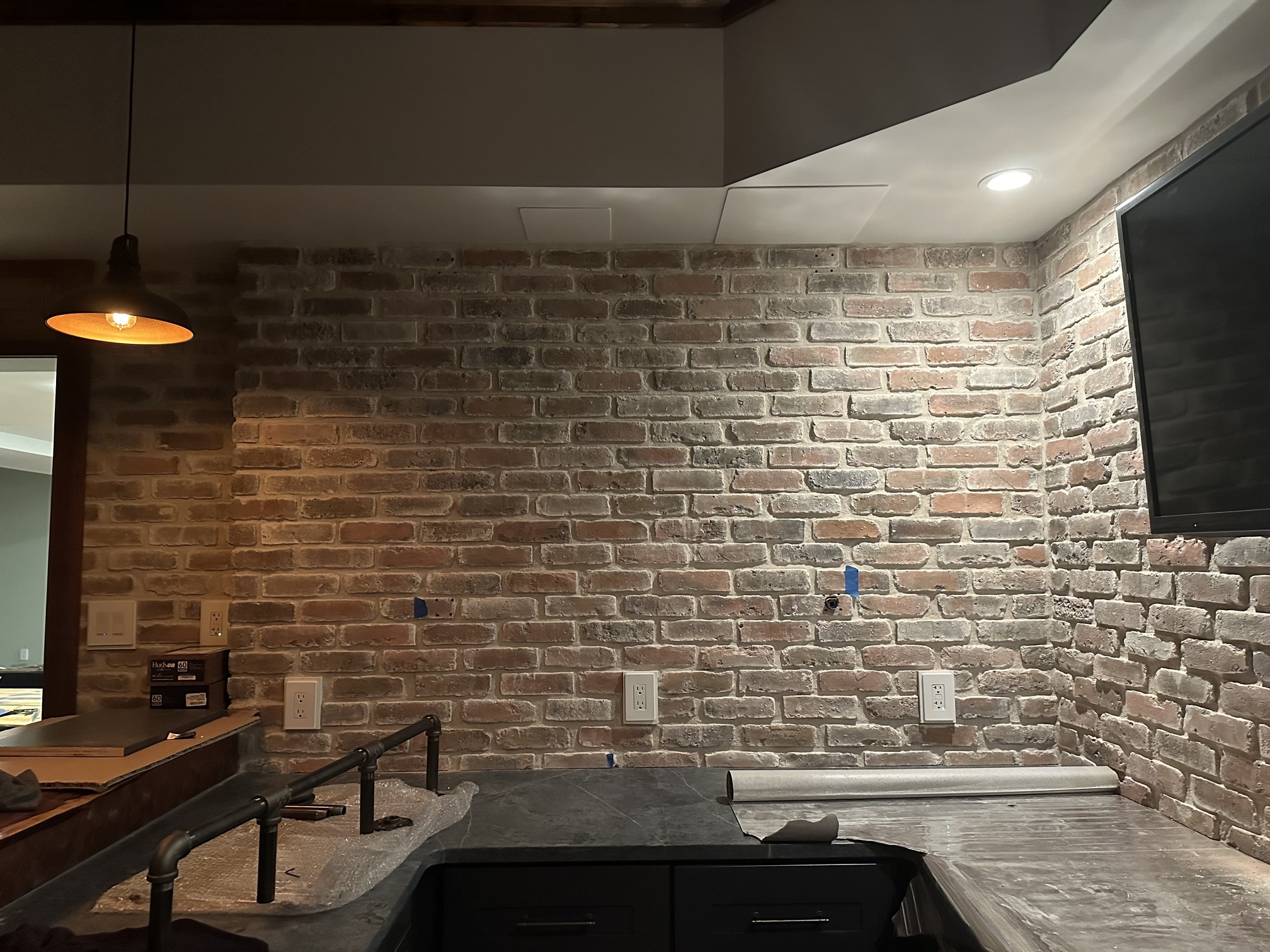

Haha no. It’s uplighting for our bar shelves in our wet bar :slight_smile: Shelves aren’t up yet because we are basically waiting on me lol
n
Wow, the brick looks awesome...I miss brick, spent some formative years on the east coast where so many houses were made of brick. Just not really a thing out on the left-coast, sadly. Miss it...
Hopefully you'll get that Haley person going on her tasks... :wink:
The house really isn’t brick but we added brick inside so the bar feels like being transported out of the house. We live out in the country and don’t have Ubers, so drinking definitely means drinking and driving :sweat_smile: But, I still like my happy hours after WFH lol.
