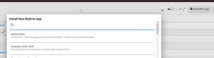

Have you installed the app for connecting your hub to Amazon?
It's found here:
Once installed, you select IN THE Hubitat Echo Skill App on the apps page what devices you want HE to share with Alexa. Then you can talk away.
