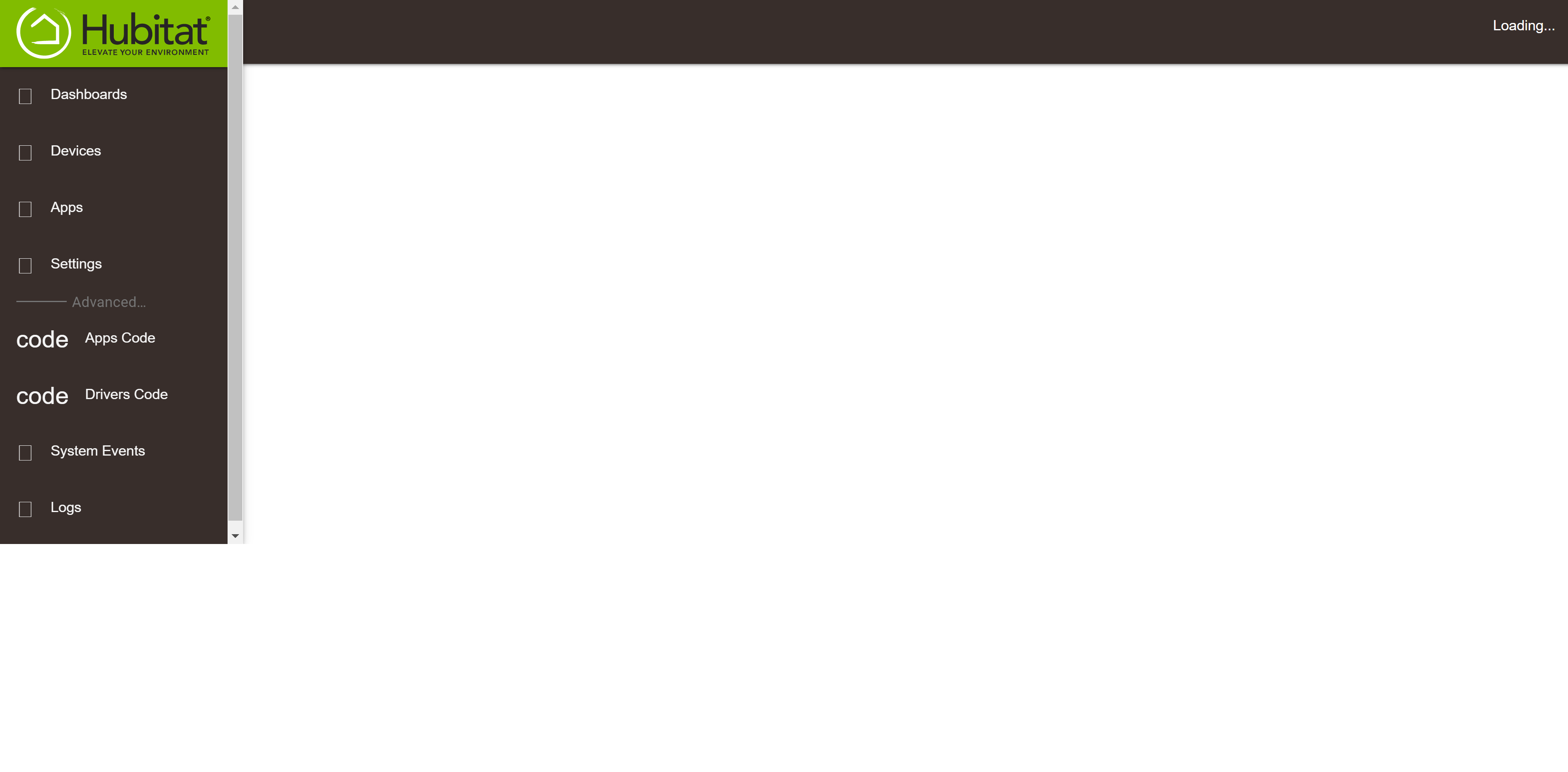

I recently moved into a new home and brought all my tech with me. I am having trouble getting into HE. I can find it, but it just loads forever as seen in the picture below. The sidebar on the left loads but nothing else. When I log in through my phone, everything is there.

If you look at your screenshot, even the icons on the left hand menu have not loaded.

That's right. The icons haven't loaded and they keep trying forever.
