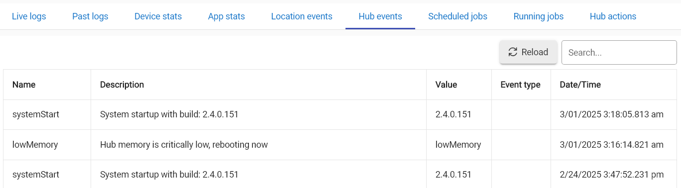

I have been trying to track down a long standing issue of my hub becoming slow and then requiring a reboot every 4 days. I have actually confirmed its always 4 days after the last reboot.
So after trying everything to diagnose the issue, I ended up contacting support and had the C8 hub replaced under warranty. I actually ended up paying the difference for a C8 Pro hub as well.
So now I have a C8 Pro which has double the memory, yet the exact same issue is happening and its still happening on the 4th day of uptime. Everything works great up until day 4 and than I right away start noticing lighting automatons becoming slow and the web UI becoming unresponsive. And sure enough the hub reboots itself due to "critically low memory," yet the memory is not actually low.
The other day after the hub rebooted itself on day 4 of uptime due to claiming critically low memory, the actual free memory before it rebooted was still 1.2GB. Also, if this was a memory issue I would have expected that after upgrading from the C8 to C8 Pro hub, this would either have mitigated the issue or at least extended the uptime, which has not been the case.
Despite the hub "claiming critically low memory," I don't think the hub is actually running out of memory. It seems like some kind of race condition in an app/rule, but nothing in the logs shows any issues with an app/rule. So aside from re-creating all apps/rules I am running out of ideas.

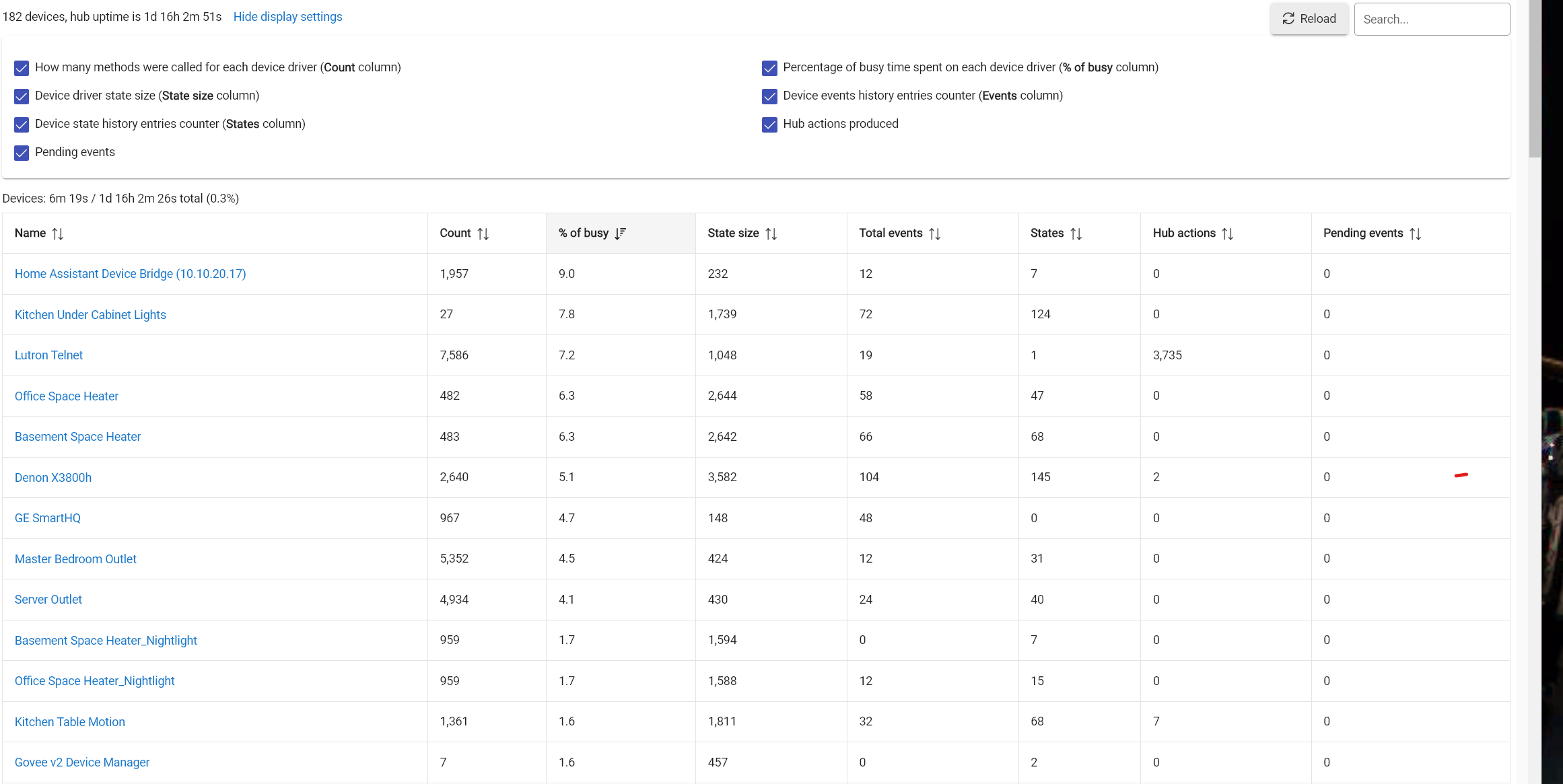

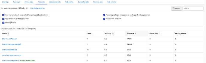

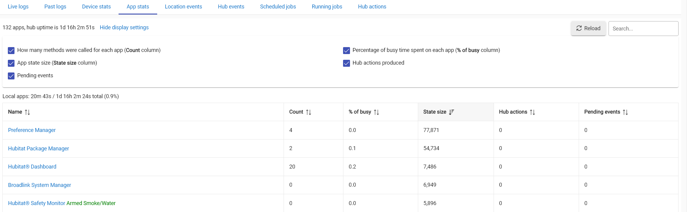

What would be considered a high state size? This is what I have currently.
True I could do it in chunks. I do find it odd that a misbehaving app/rule did not throw any errors/warnings in the logs though.
That does not look unreasonable to me as far as State Size goes....

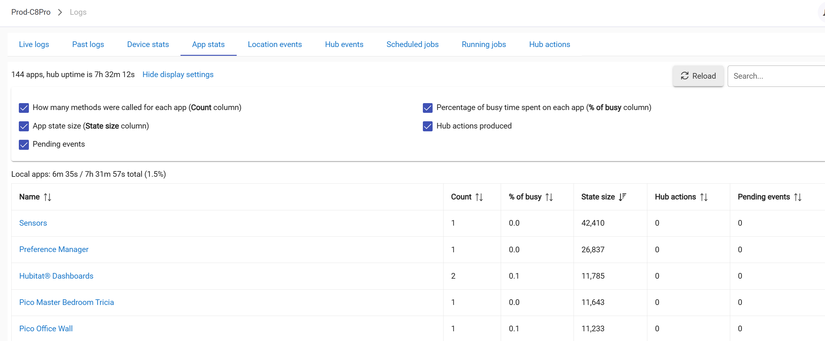

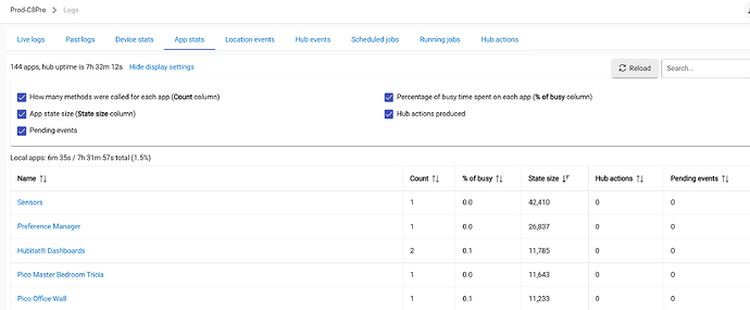

Here is mine, sorted by State Size
Yeah looks similar.
I also noticed my % busy times for both devices/apps have always been very low, never high enough that I would expect to cause problems. You can see the devices have very low CPU busy time overall.

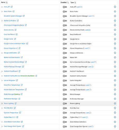

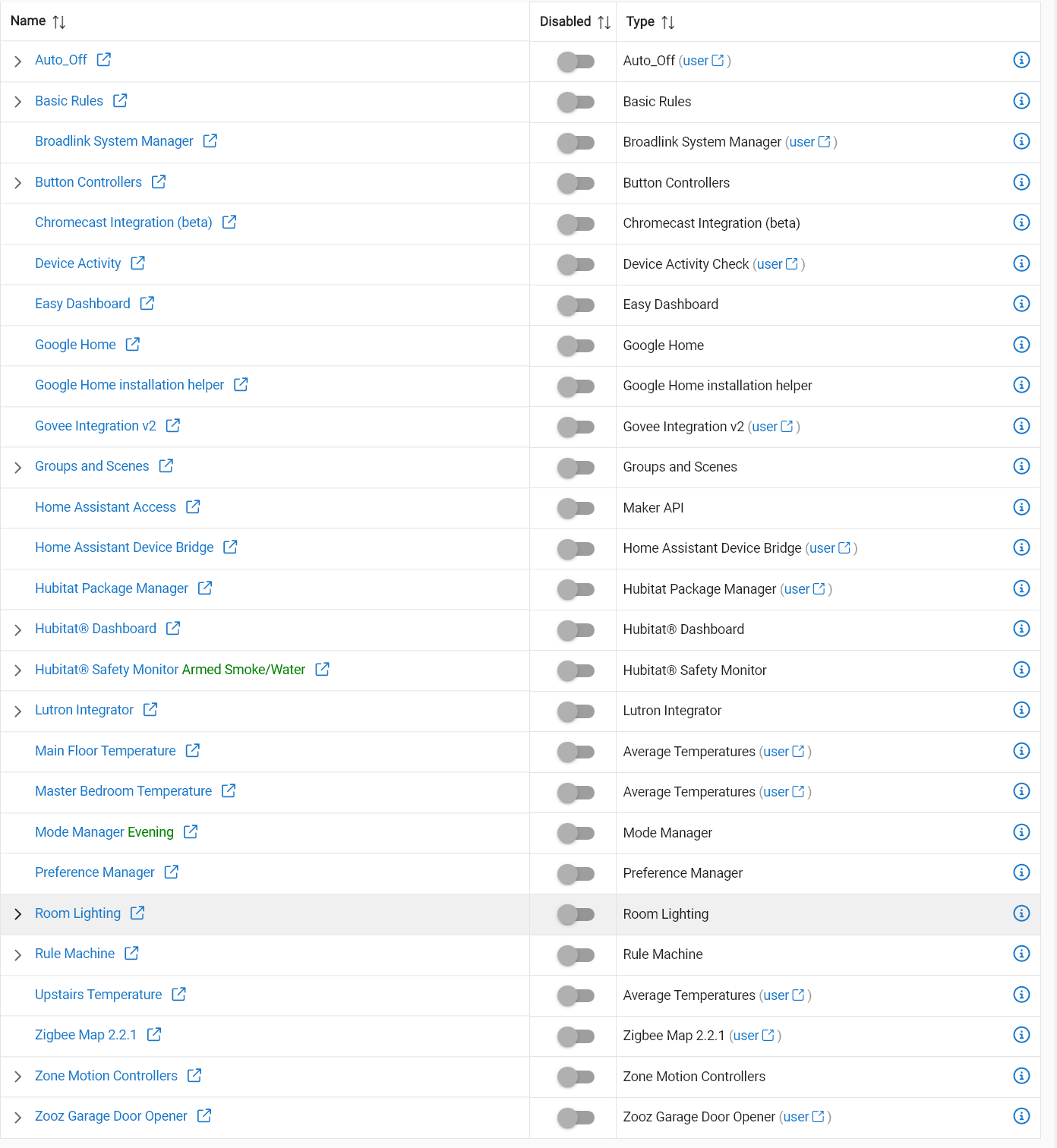

Can you take a screenshot of all your apps and rules so we can see what kind of stuff you have.

I would suggest starting by turning off all of the apps labled "User" and see if that makes a difference. Then move on to Rule Machine rules if that doesn't help. Rm is great because it is so flexible, but it also allows us to do things that may not be the best.
Actually those average temperature apps. What is that. How many sensors do they have on each of them and what ia the reporting frequency on the temp sensors.
I have been using those for over 5 years at this point. It just averages temps from a group of sensors.
