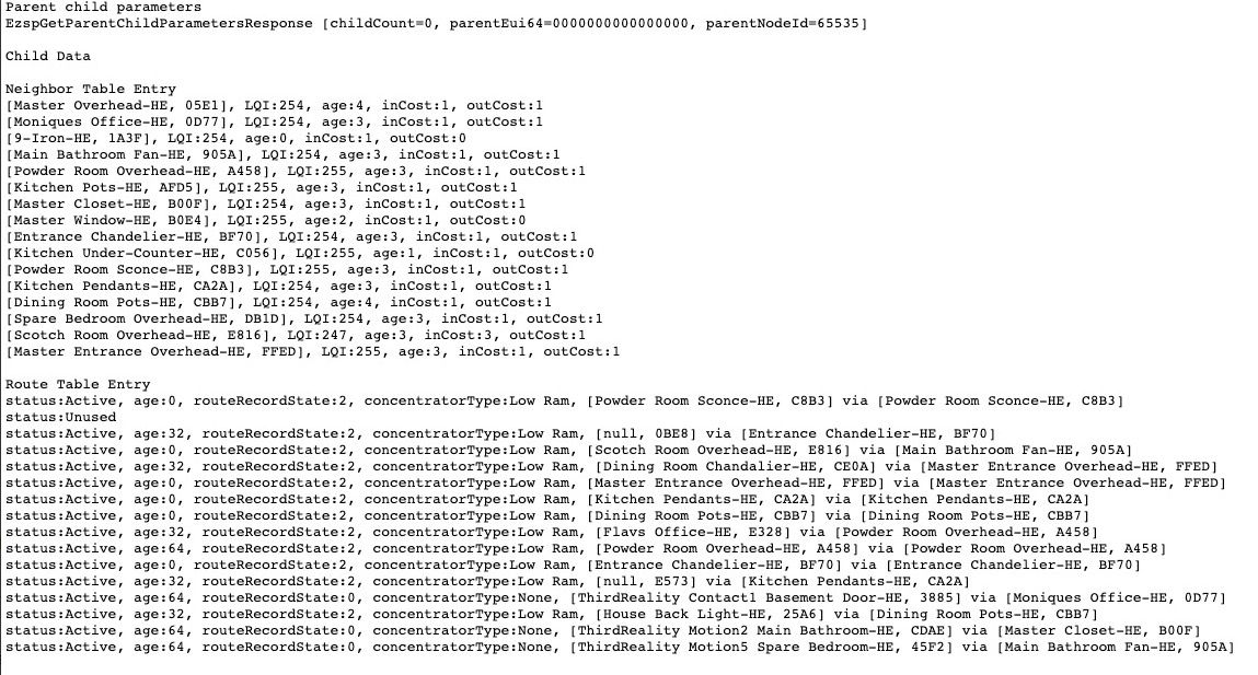

You can get some indication of the health of your zigbee network with this link... if you want to take a screen shot of the results it may help.
http://[insert your hub's IP here]/hub/zigbee/getChildAndRouteInfo
The other thing that might help is to safely shut down your hub, remove power (at the wall, not by pulling the USB connector), wait 30 min or so, and plug it back in. This should cause the zigbee network to rebuild itself. It still may take a while to get everything working again.
thanks brad.. yes i moved the hub because i was getting weird behaviour.. with it moved, things appear to be better except for the above mentioned issue.
I did try the http://[insert your hub's IP here]/hub/zigbee/getChildAndRouteInfo, command.. I must admit that I dont understand it.. Does it show signal strength ?.. Because I'm not sure if it shows the entire network.
LQI is an indicator of the quality of the link to those devices connected directly to the hub... yours all look pretty healthy. Low incost and outcost numbers are also indicative of the relative "cost" of routes to and from those devices. Low is good though zero basically means "unknown."

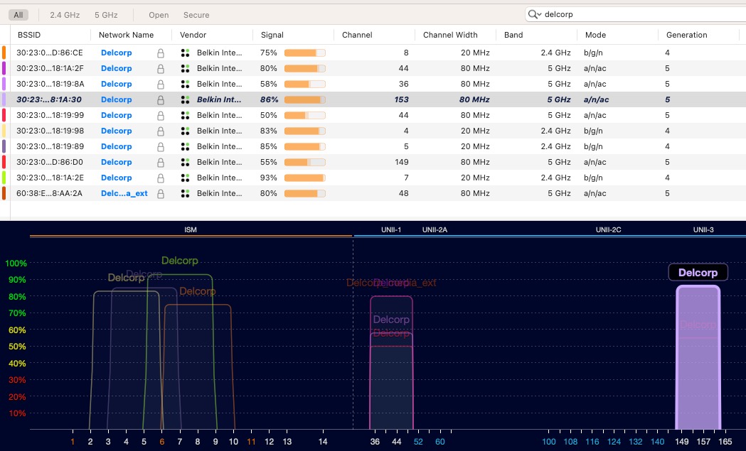

Can you use a scanner on your phone or computer to figure out which 2.4 GHz channel is being used by your Velop mesh?
Your mesh looks good. So I'm kind of puzzled why you have these lingering issues. I'm inclined to agree with @brad5 that you might have zigbee/wifi interference.
I do recommend figuring out all the WiFi channels used in your house, and then picking a zigbee channel that is far away from them. Also recommend using a 20MHz wide 2.4 GHz WiFi channel and not a 40 MHz channel width. This chart should help:

I scanned by wifi and heres what I found : My home wifi is called "delcorp"
If i understand this correctly, my home wifi appears to be running between wifi channels 5 to 9. My Hubitat is on zigbee channel 20 - So i believe that they do overlap.
Understanding that I cant change my Velop wifi channels - I suppose I could move my HE to a higher zigbee channel.. like channel 24..
This screenshot looks like WiFi Explorer on a Mac. To get a cleaner picture of just DelCorp, "type Delcorp" in the Filter box on the upper right hand corner.
To my eyes, Delcorp seems to be using Channels 4, 5, and 7 - but a cleaner screenshot would help.

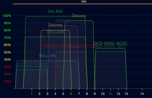

Heres the scan again just with Delcorp..
So Delcorp is using channels 4, 5, 7, and 8. So zigbee channel 20 is not a good idea. I would suggest 23, 24, or 25 - especially 25.
And keep the router away from HE by at least 2-3 feet. WiFi signals are much stronger than zigbee.
Remember when you change zigbee channels, it will take a while for your zigbee devices to find the new channels.
Some might have to the factory reset and re-paired, but they will rejoin with the original device names and device-ids on HE. Just don't delete the Hubitat device. Simply reset the device and put your HE into zigbee pairing mode.
