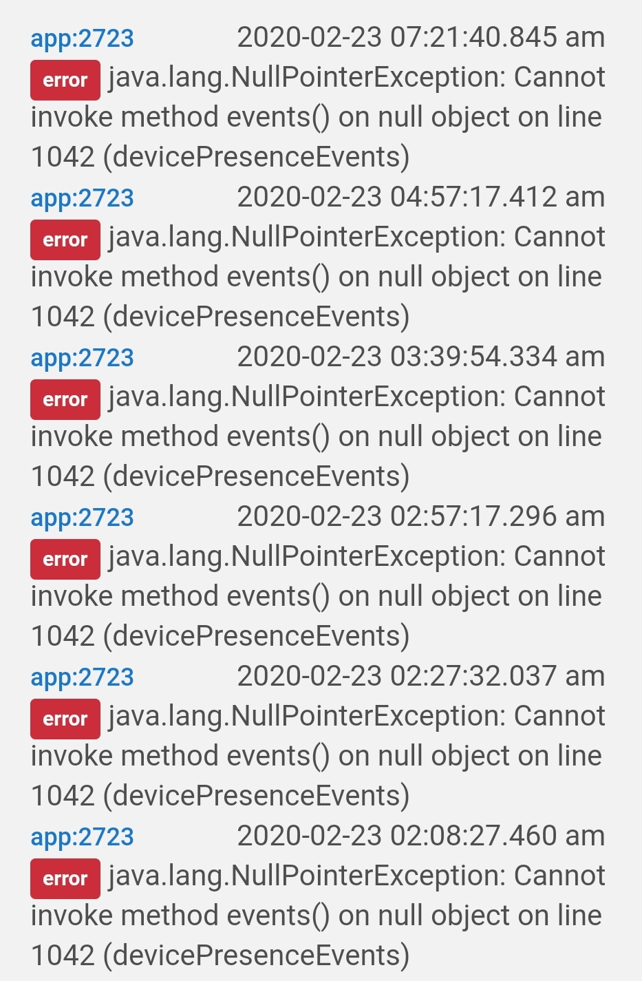

Hello,
I don't know exactly when this started, but it was after an update, I'm in the latest version and still the error, I have not changed the dashboard in few months, only using HE default tiles or colors.
I'm tagging @bravenel
Hello,
Did you by chance remove a device that used to be in a dashboard? I would guess that "events()" is trying to get the history of a device but the device is null.
Not recently that I know, but if that is the case, how I fix that?
Go into the dashboard's app, load the devices, maybe select a new device and then deselect it and hit update again. That should give the dashboard the chance to drop any devices that don't exist any more.
Thanks, I added one device in the 2 dashboards I have, fingers crossed.
Still getting the error
Hopefully Bruce can give some guidance.
