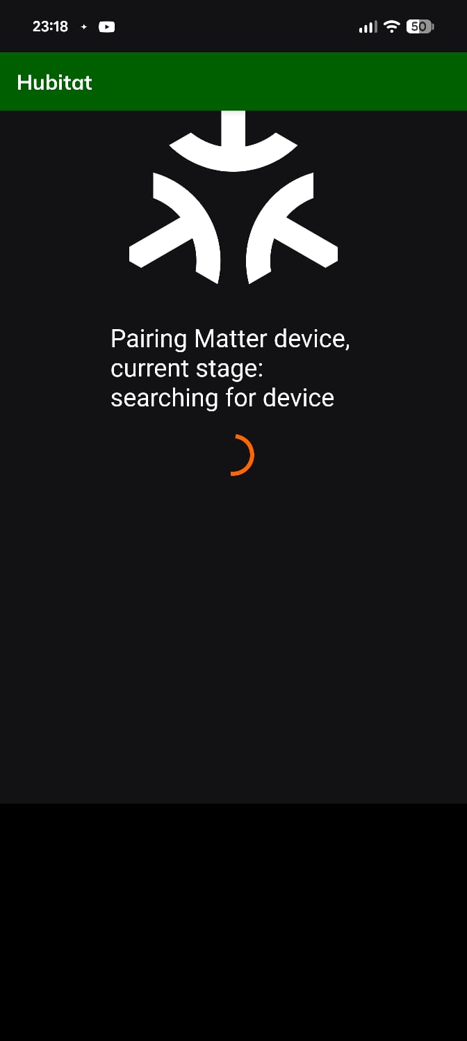

Hi, all I am new to HE. I got my hub almost a week ago and have been troubleshooting and trying daily to get it up and running and devices added. I bought some of IKEA's Matter devices and have been trying to add them to HE with no success. The thread border router I use is a Google TV streamer 4K, and I have a HE C8 Pro. When adding the device from google to hubitat, i get to a screen where it says "device added, then i get stuck on a hubitat screen same as title of post. I have included a few photos if it will help.

Thanks for your response, and let me clarify a bit. I first commissioned the devices on the Google Home app using my Thread border router (Google TV Streamer). I then selected the device in Google Home, "linked Matter apps and services", then "link apps and services". This is how the new code is generated to be shared with Hubitat.
The first picture shows the screen that comes up at this point. I select 'Use pairing code' because Hubitat is not in the list of apps at the bottom of the page. Next I open Hubitat and click 'Add Device', 'Matter Devices', and input the provided code.
In the Hubitat app, the device goes through the pairing process and reports 'device connected', as seen in picture 2. The next screen I am presented with is picture 3. This is where the app gets stuck, and that circle never stops spinning.
