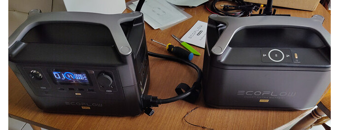

Costco had the Ecoflow River Pro and extra battery for 699.00 and running it in sudo UPS mode before my actual UPS keep my network stack running for about 22 hours. Need the real UPS in the loop because it take about 1/2 second before the Ecoflow recognizes it has to turn on the inverter.
