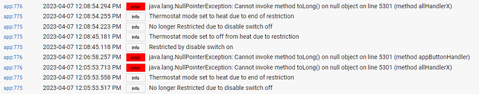

More recently (with 2.3.5.123), this doesn't seem to work. I'm not a coder, but wonder if this error which occurs when I turn the Furnace disabled virtual switch off provides any guidance as to what is no longer working as it did before?

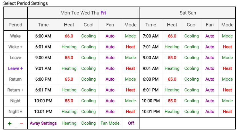

But, I wonder if my adjusting the time periods table such that the temp and the mode change don't occur at the same time (which has been working) puts me in a position where at 5:51PM (in the Leave + period) I am in a time period wherein the Thermostat Scheduler has no target Heat setting?
