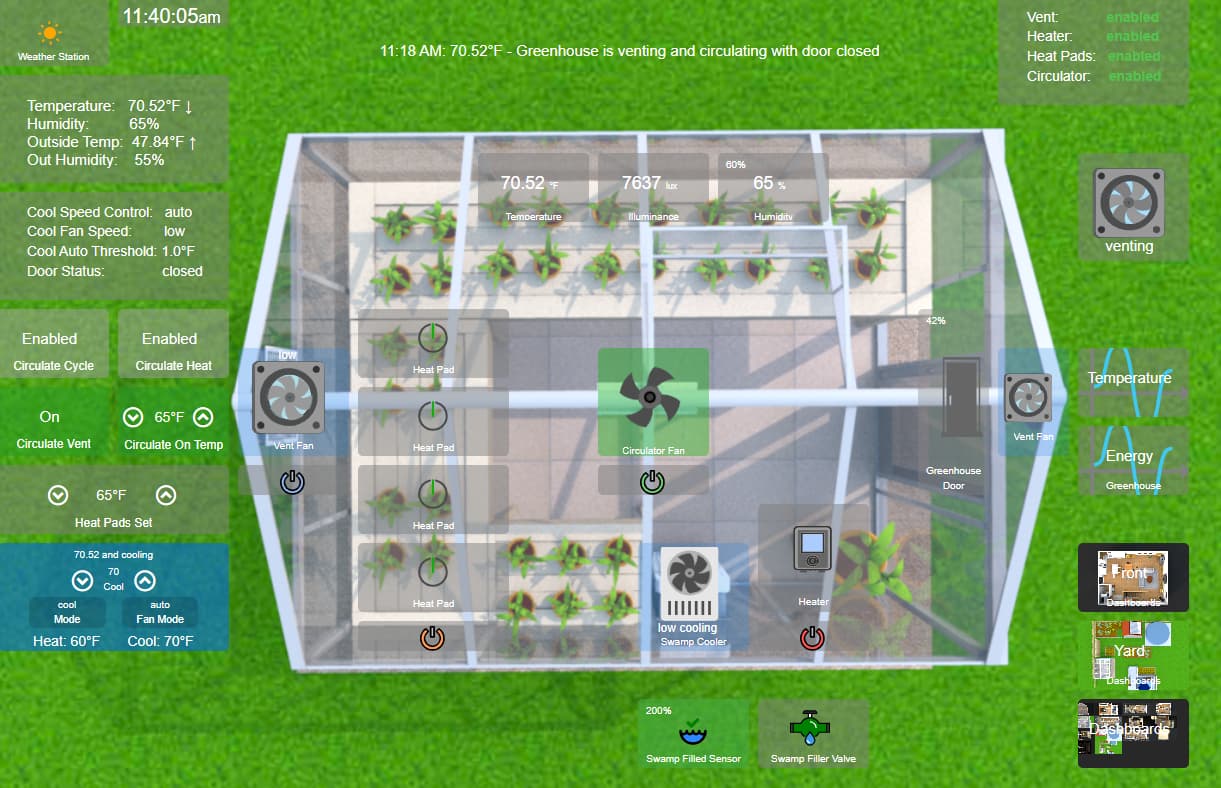

Right now it 47F and sunny, the cooler came on hours ago on low when the temp rose above 70F. Vent fans come on with the cooler, so that helps vent the humidity out. Currently 55% outside and 65% inside.
The greenhouse is pretty smart at this point:
Outside Temp/Humid
Inside Temp/Humid
Inside Illuminance sensor
Inside motion sensor
Greenhouse Door contact sensor
GE Fan Controller for vent fans - tied to the virtual thermostat
Heater on a smart power metering outlet - tied to the virtual thermostat
Heat pads on a smart outlet - tied to temperature for on/off
Circulator fan on a smart outlet - with on/off cycling, on/off with cooling, on/off with heating, or on by internal temp
Swamp cooler - tied to the virtual thermostat
Swamp cooler filled sensor (leak sensor)
Smart valve for auto water fill of cooler - tied to leak sensor for auto water filling
