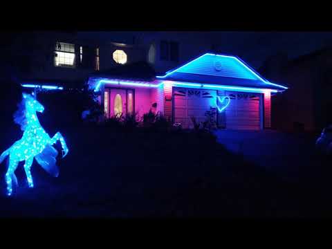

It looks good so far. I think you are doing just like what I want to convince my wife to allow. If you can post an "overall" picture of the house with them on at night, I would love to see how it looks. Plus a video clip if you put any type of "change through the colors" rule going.
