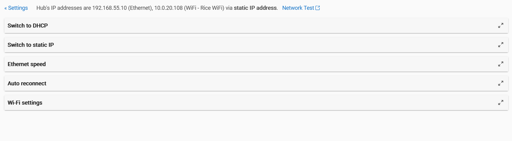

Is is possible to have the new C-8 hub plugged into a LAN connection as well as be on the wireless network similar to how Home Assistant. The reason I'm asking is because I have a C5 that is hardwired with a static IP and the C8 hardwired in with a static IP. I want to be able to have the hubs be able to communicated through Mesh however, in order to do this it is my understanding that they both have to be on the same subnet. Which poses a problem though, as I want to integrate the Wiz Integration into the C8 with controls Wiz lights over the wireless network via their unique and statice IP addresses. Right now I am able to enable the WiFi via the C8 with no issues, after enabling it states to disable the ethernet port on the hub. If I do not do this will it stay on both subnets? Or will it cause issues further down the road? Is it possible for the C8 hub to have 2 different IP addresses each for an individual network. If not, could it be possible to see something implemented in further updates? As I have the hub stating that is has 2 IP addresses, just not sure if this will pose a problem down the road or not.

I’m currently running dual connections on both my C-7s and my C-8. By default the hub will communicate with the fastest responding connection (usually the wired) when it goes out across the LAN, but both will respond if you directly address them. C-8 will disable the WiFi connection if you remove the SSID and supply a wired connection.
Edit: Another note - Since the WiFi connects using the SSID, and the SSID doesn’t technically need to be on the same LAN as the wired connection, you could create a situation wherein the Hub is on two different networks simulataneously…
