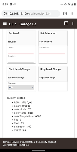

When I look at my Hank RGBW LED Bulb (HKZW-RGB01) bulb in the device settings and dashboard, I get different color settings. The Set Color shows "red", as well as it does in the dashboard. When looking at the Current States the color shows "Cool". When I use the bulbs in an app and try to set it to "white", it doesn't take and sets the color to red. I can change the red with the color wheel, but there is still inconsistency. Also, is there a way to pick a color from a long list of color names instead of the color wheel?

There's an RGB bulb and a White color bulb in the one physical device. Initially, I thought the reason for the split was Power.. the heat sink within couldn't handle both Arrays of LEDs on at the same time. But for whatever reason, since you cannot have both arrays on at once, you have to pick a Mode.. CT (color temp) or RGB. Your screen cap shows CT and therefore the values related to CT are valid, the values for RGB are simply historical.

With CT as the Mode, the name and color temp values are related to the Color Temp selection.
When I click the setColor button and switch to RGB as the Mode, the values change to match.
