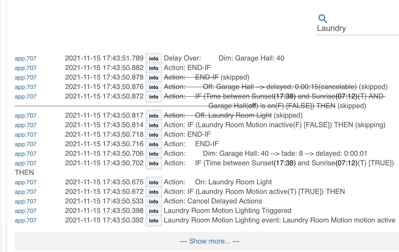

Can anyone help me understand why this is hanging. The Rule is pretty simple…I think. Basically, if motion is active turn the lights on, and if it’s after dark, turn two lights on. If motion is inactive, turn the lights off. And if it’s after dark, turn the two lights off.
What’s actually happening is that it turns the lights on and they hang on until I either see it and turn it off, or it is re-triggered with another Motion event.
I had it only set to motion active with a wait for event (motion inactive), but that failed more than it worked. This way pictured works about 75% of the time.

I’ve been watching the logs and it looks like the motion is inconsistent on changing to inactive. There is a zigbee powered device in the light fixture of the laundry room, so I should have a repeater within a few feet of the Motion. It only flashes when it activates and waits two minutes to reset. I checked the device status and it showed active on the hub. However when I walked into the room, it flashed. I’m guessing it’s a device reporting issue?
The problem I’m having is that it really doesn’t log when it doesn’t work so I’m not seeing what’s happening. I just come in and it’s been on for an hour.
That would explain the problem; the second half of your Rule actions (that turn the light off) will not happen if this event does not occur.

Is your motion sensor event log showing it going active and inactive? You should be able to see each time the device goes active and inactive and then go look at hub logs and look at that the inactive times to see what happened.
