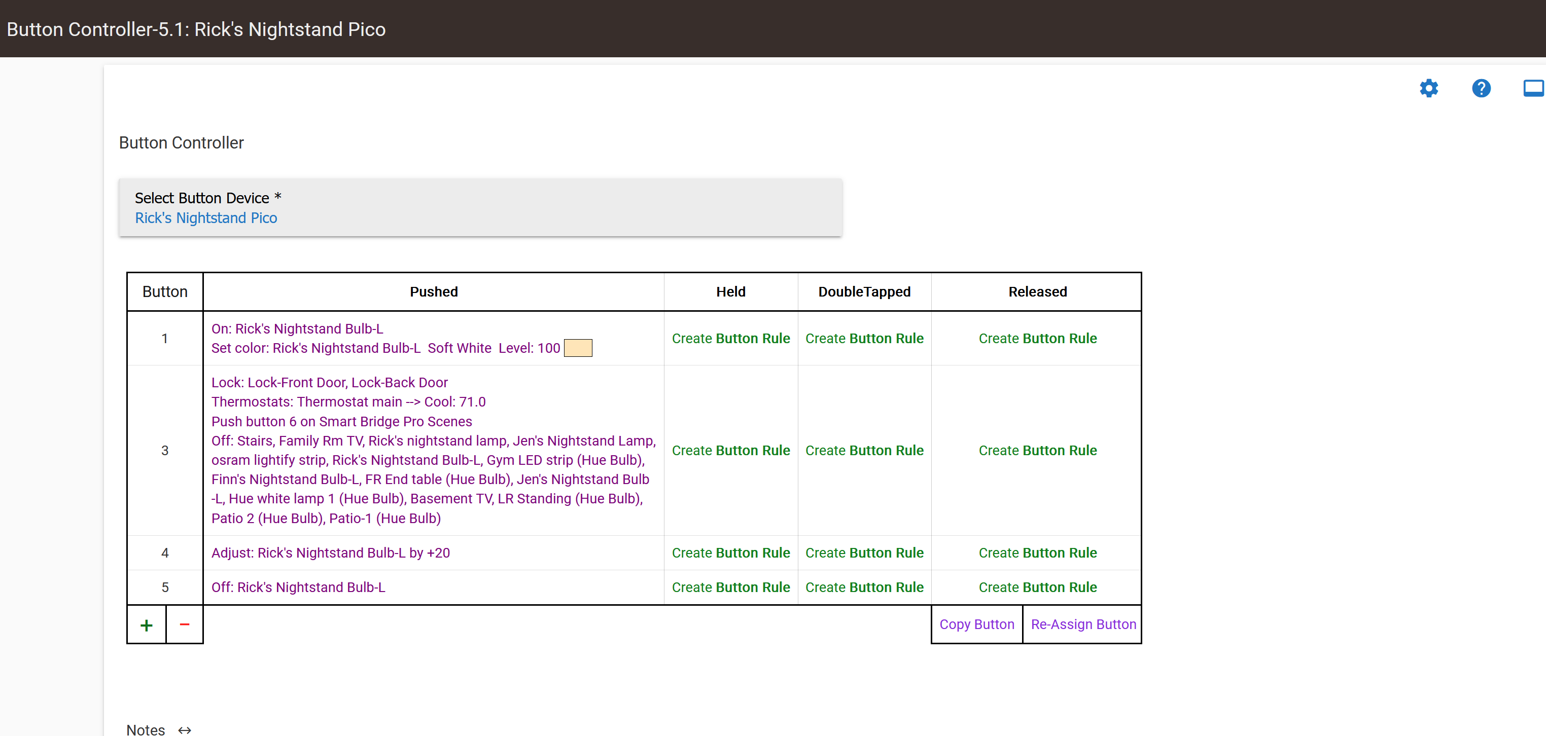

That is certainly strange. One Hint though... If you have a rule to turn off all your lights (I have a whole house shut down routine using the center pico button on each night stand). To avoid slow popcorning create a virtual device using the lutron keypad driver. (add whatever buttons needed). Add the keypad to the integration as k,1,whatever you decide to name it. Create an all off scene in the lutron app and name it something. Re export the integration report and look for that scene and note the number.
So from my below rule, all lights turn off at the same time with no popcorning
