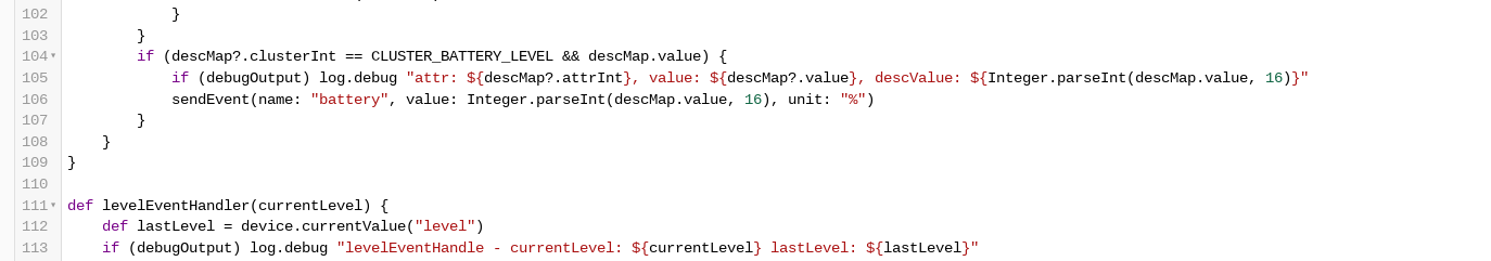

I tried to implement your code change but unfortunately without luck.
What makes me wonder is that the above shown line items are not exactly line 104 and 105 but 105 and 106 (see shot below). If I try to adjust/replace those lines I cannot save the change, I get an error message.
What am I doing wrong, any ideas.
Sorry if I overlooked the solution somewhere.
The battery of attribute being 16 is what is being reported as 200% after the firmware update. All my change does was divide attribute 16 by 2 (16/2). You might have to play with it a bit to get the syntax correct if you’re not familiar with coding.

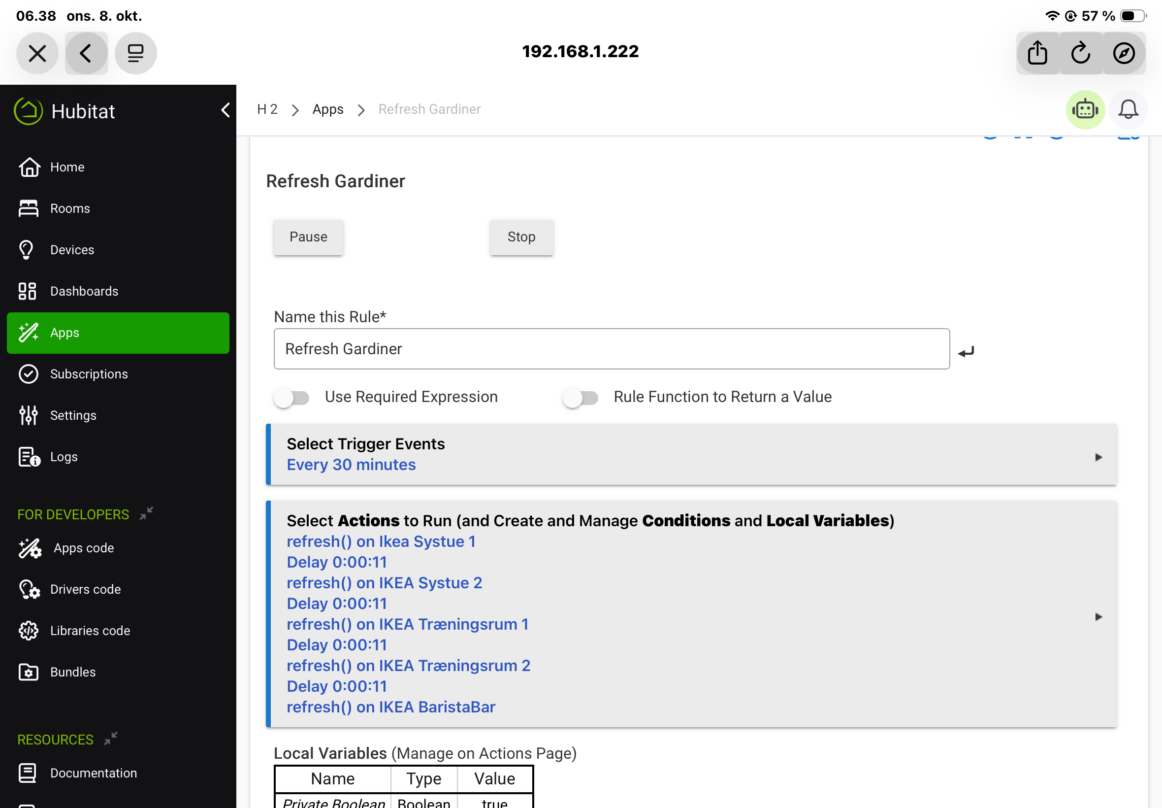

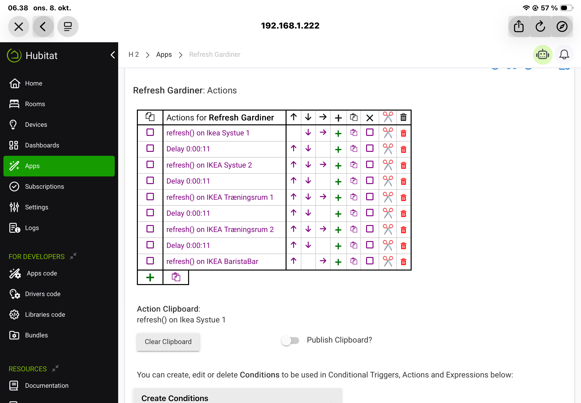

4 I use a refresh command every half hour
I must say I have had a really hard time making them all work, they still drop of the network from time to time, so far this is the best.
How did you do the refresh command every 30 mins?
