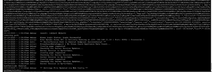

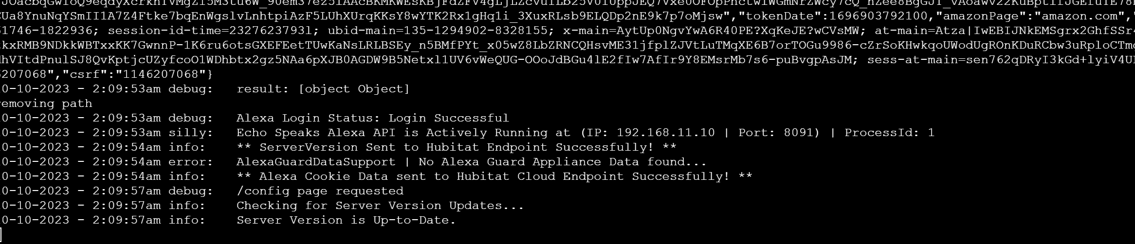

the docker is definately working ok.. something wrong in the app.. here is the docker terminal output with part of the cookie purposly cut off.
Close out of the app and go back in, see if it detects it.
Restart the container and then check if you are still logged in. If not log in again and DO NOT press Save at the bottom (which seems to log me out for some reason).
ok .. sucess thanks got it working.. not sure what i did different.. now holding breath to see if it will update cookies automatically. i think is it every 12 hours?

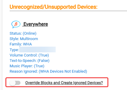

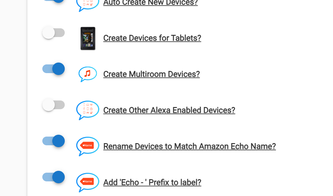

also not getting the everywhere device so i cannot send a notification to all devices.. any ideas..'
i do have the switch on.. ie

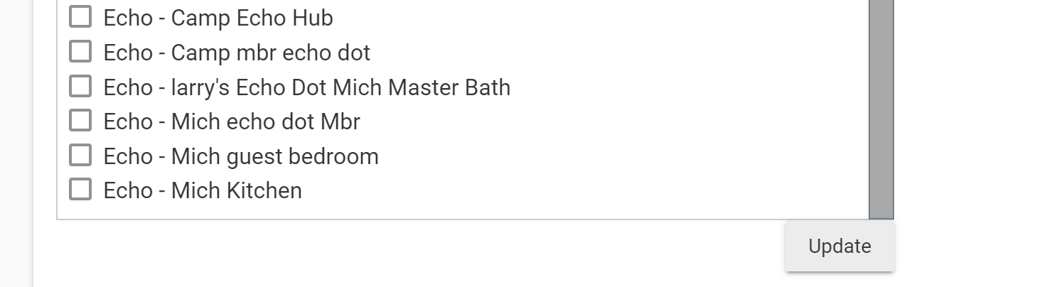

In the HE Echo Speaks app go to "Manage Devices" > Unused Devices
Force it on. Not sure why its not getting created automatically. I do not use it so never noticed.
ya wasnt that.. followed rlithgow instrucitons here and got it working
Yes, I had the same issue. Set up a zone (call it what ever you want). A child app will be created under echo speaks. Go into the child app and click the CREATE DEVICE switch. The name of the group will now be a device. Set your announcement to go to that device. It will now do all speakers in that group at once instead of one at a time.
just assumed it would automatically create the device with all echos.. as the voice test feature worked for that when i toggled that.

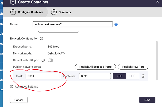

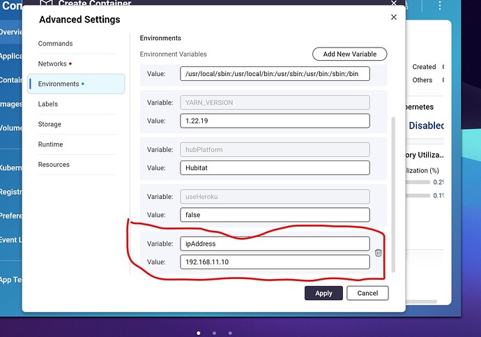

also anyway to summorize.. this does work in qnap nas with a little tweaking.. The only changes i made on creating it in docker was to add the ipaddress variable and change the port to 8091 so that it didnt nat a high port to 8191.. i did it directly in the qnap container station..

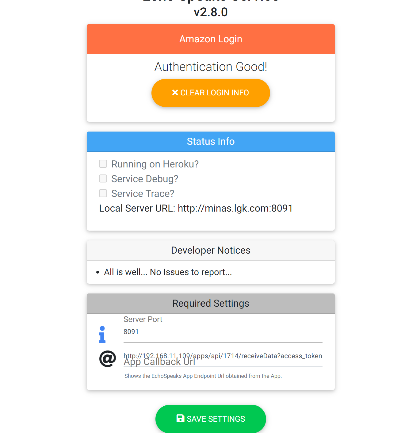

i didnt see an option to use a local callback url or i would have preferred it.. that is the url it gave me when i clicked on it.. maybe i missed an option.
It's mentioned at the bottom of the first post of this thread.
The only time it does this for me is if I press save after logging in. Need to log in then close that window, no save after.
Yes but you have to hit save to chsnge or add the callback url or it doesnt stick which means you have to do it twice.

this must be out of date as my cloud callback url looks nothing like that.
ie
https://cloud.hubitat.com/api/numerchanged-1283-43f9-ab3a-numberchnged/apps/1714/receiveData?access_token=7cbd83cb-c516-4249-aed7-numberchnged
so what would the local url look like for this
Your cloud URL looks exactly like my example. The example is only the front part of the URL, it says to replace that part and keep the rest. Your local URL would be like this:
http://LOCAL.HUB.IP/apps/api/1714/receiveData?access_token=7cbd83cb-c516-4249-aed7-numberchnged
yep once i changed it to that without the extra slash (sorry) it works fine with the local url..

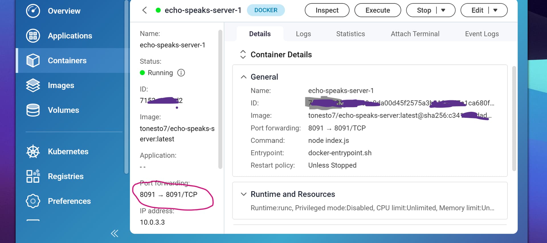

this is for josh and others for qnap instructions.once installed the docker image should look like this.. also ignore the nat ip ie 10.0.x.x that is not the actuall ip you will use to run the image.. it will be your nas's ips and that is what confused the container and why you have to add the ip addrss field on install as below,, This appears to be a qnap quirk of docker/container station..
the key is other than putting in the ip (your 192.x.x realip as a parameter ) and here are the steps to deploy in container station on qnap.. the only changes i made are circled in red..

one thing to beware is that it is tricky to get the stupid local url right.. took three tries..
remember when changing from hubitat.local to the ip it is the IP of your hubitat not your nas
and if you have the wrong local url that will cause the log in to not stick in the docker image... probably what others were seeing
