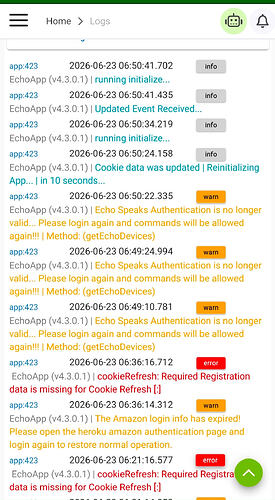

I have been running the integration on a LXC with Proxmox for over two years without fail. But this week I was shocked that none of my Echo’s played a weather alert that showed up and the app showed the cookie didn’t get refreshed. I had to go back into the Echo Speaks Server and re-log into the service and all seems to be well. Don’t know what triggered this I rarely restart any services on my Proxmox cluster unless there is a security patch. I am wondering if something at Amazon forced the re-login?
Mine just quit working yesterday. Restarted the container, re-logged in, nothing seems to be working this morning.
I don’t have time right now to troubleshoot this. Will check back here to see if anyone else has done anything that works and go from there.

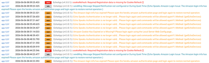

I’ve had the 408 failur twice now over the past 2 weeks.
Fix both times has been to log back into Amazon with username/pw and 2fa code.
Working again for now.
Perhaps there’s a longer/shorter timeout that needs to be implemented. ¯\_(ツ)_/¯

Looks like Amazon may have changed something in the refresh. Lot of discussion over here:

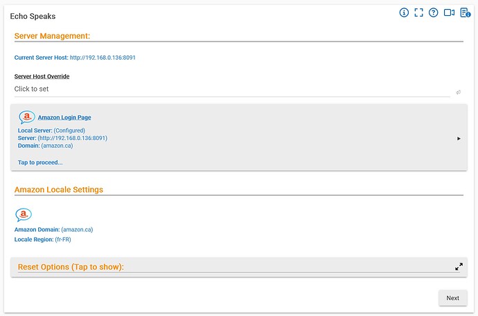

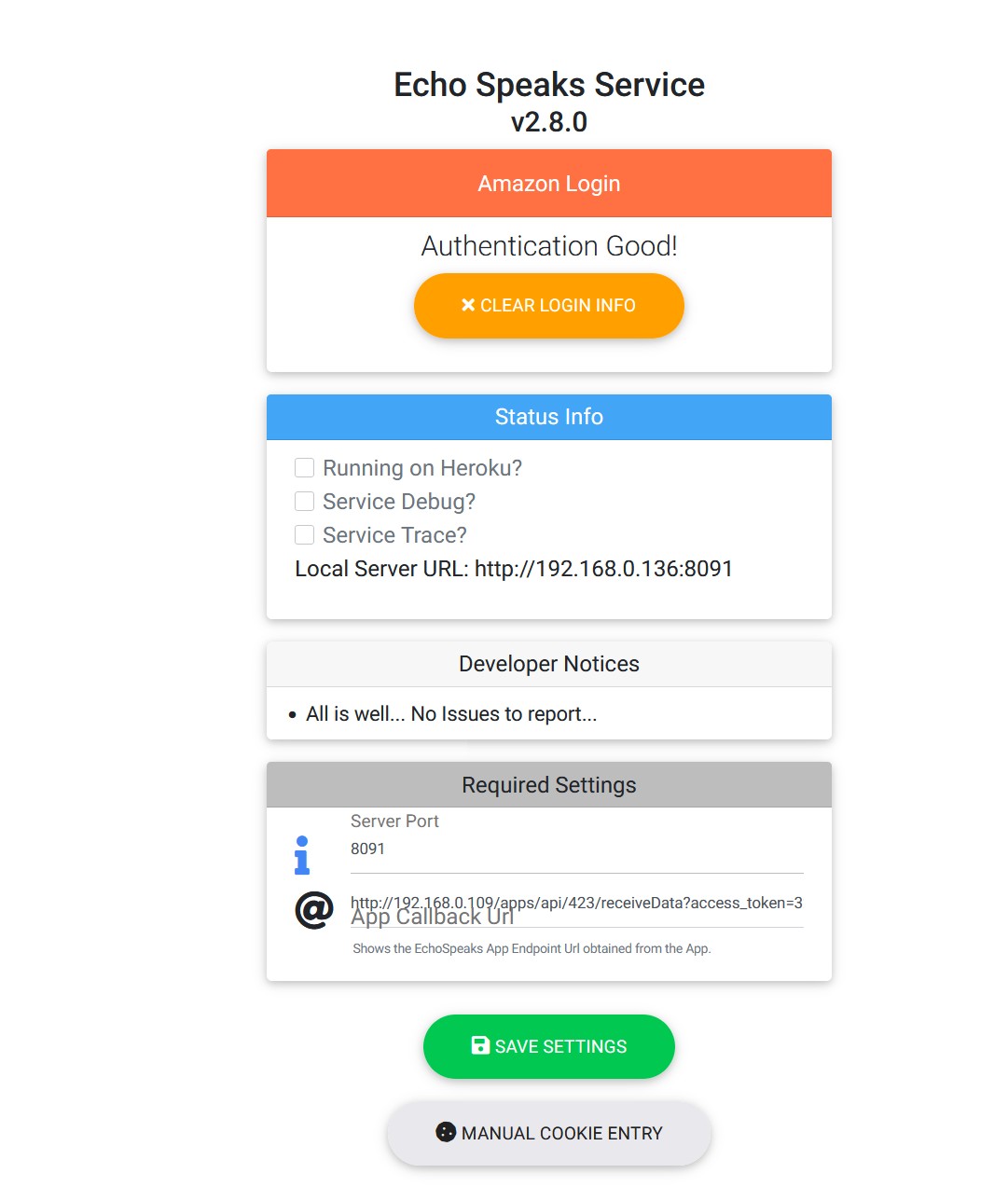

looks misconfigured to me. if u are running in docker it should not be referencing heroku. (see your log entry) you forgot to turn off that toggle during setup.
I don’t saw Heroku in my log and Heroku isn’t selected. Maybe I miss an other setting?

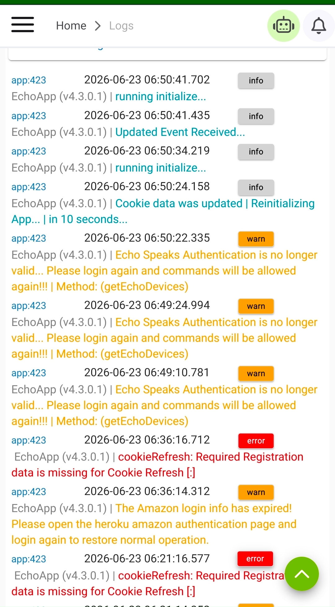

Probably not. Amazon seems to have made a change that is causing the cookie to not automatically refresh. You need to log back in manually to get the cookie to refresh. If you look at thte thread posted above by @thebearmay you can find how to change the refresh interval to 90 days.
I’m playing around with the server-side code for the refreshes. With some modifications, the /refreshCookie endpoint works. It refreshes the cookie … except for the refreshToken. I’m unsure about the impact.
Hi, I have echo-speaks-server v2.8.0 on Docker-RPI (build: GitHub - tonesto7/echo-speaks-server · GitHub) that I recently updated to, because I was receiving 404 error when attempting to re-login to Amazon from v2.7.2 this week (Echo Speaks stopped working at least 3 weeks ago but I just noticed now after being out of town). This was attempted with Incognito browser starting from Hubitat Echo Speaks app, then clicking through to my locally hosted echo-speaks-server and attempting to log in to Amazon again.
Prior to the 404 error, v2.7.2 was working for years. In looking at the container logs, it shows that in spite of ipAddress env variable specified, the echo-speaks-server is flip-flopping between a valid IP and the loopback interface around every 6th or 7th iteration. Can someone help me out?

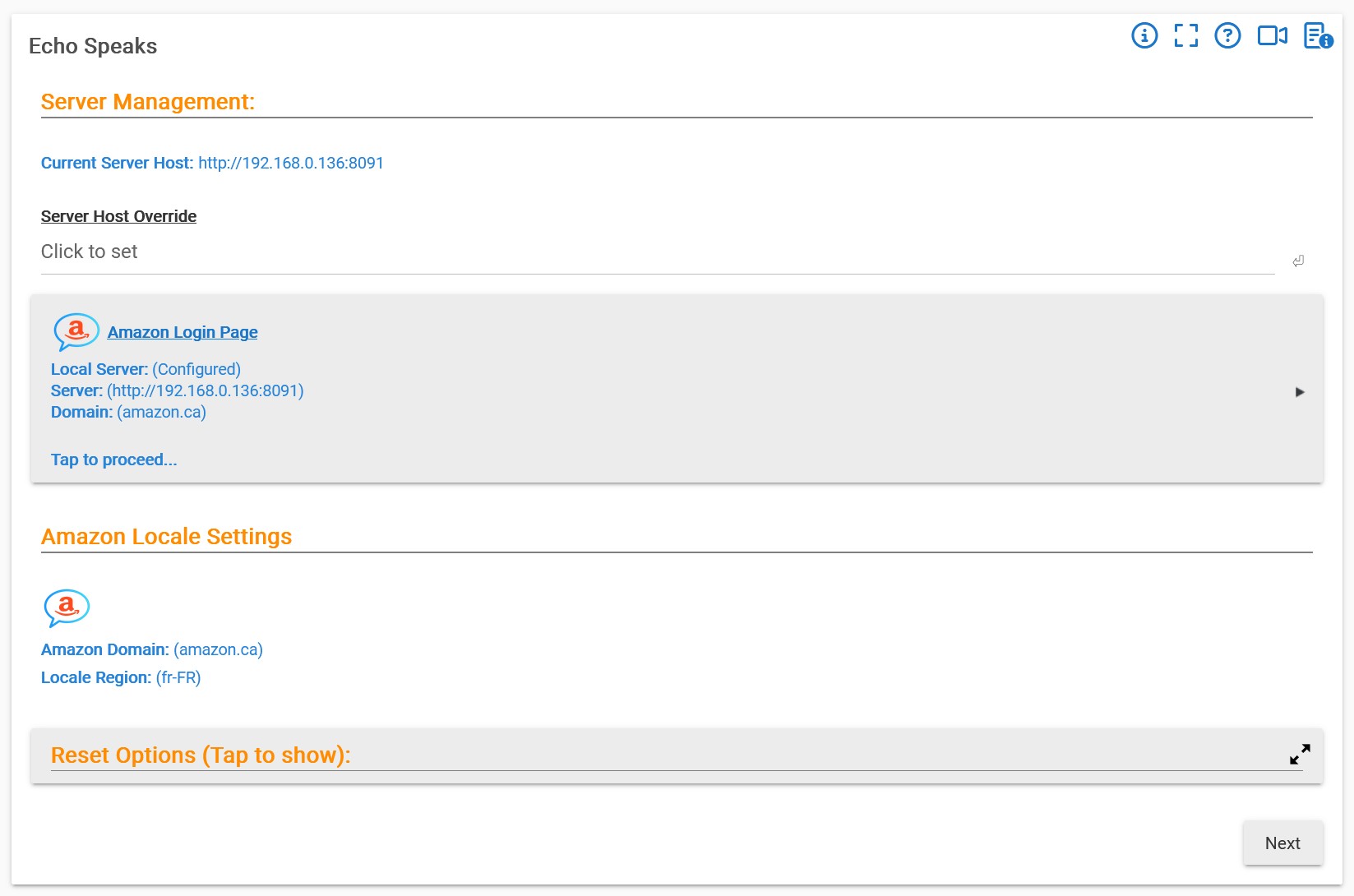

incognito didnt work for me.. try a different browser ie chrome vs ie and also you dont need to go through the link in the app . you can type in directly http://192.168.1.2:8091
also the 2nd log entry with 127.0.0.1 instead of the 192 looks like you munged up your configuration.
