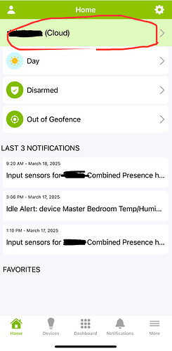

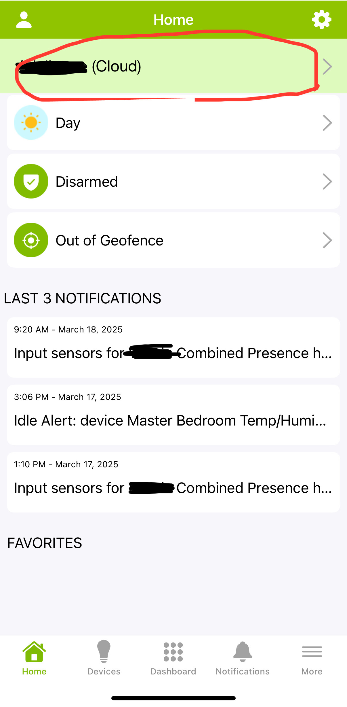

A picture is worth a thousand words, but I can only share what it looks like on the iOS app when I switch hubs.
It shouldn’t be too different in the android app.
First tap the name of your hub:

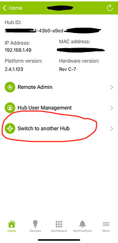

Then tap on “switch to another hub.”
As @jtp10181 was explaining, the app can actively connect to only one hub at a time. This is how you switch back and forth, and it shouldn’t matter whether the account logged into the mobile app is an admin or guest account.
