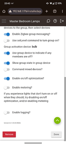

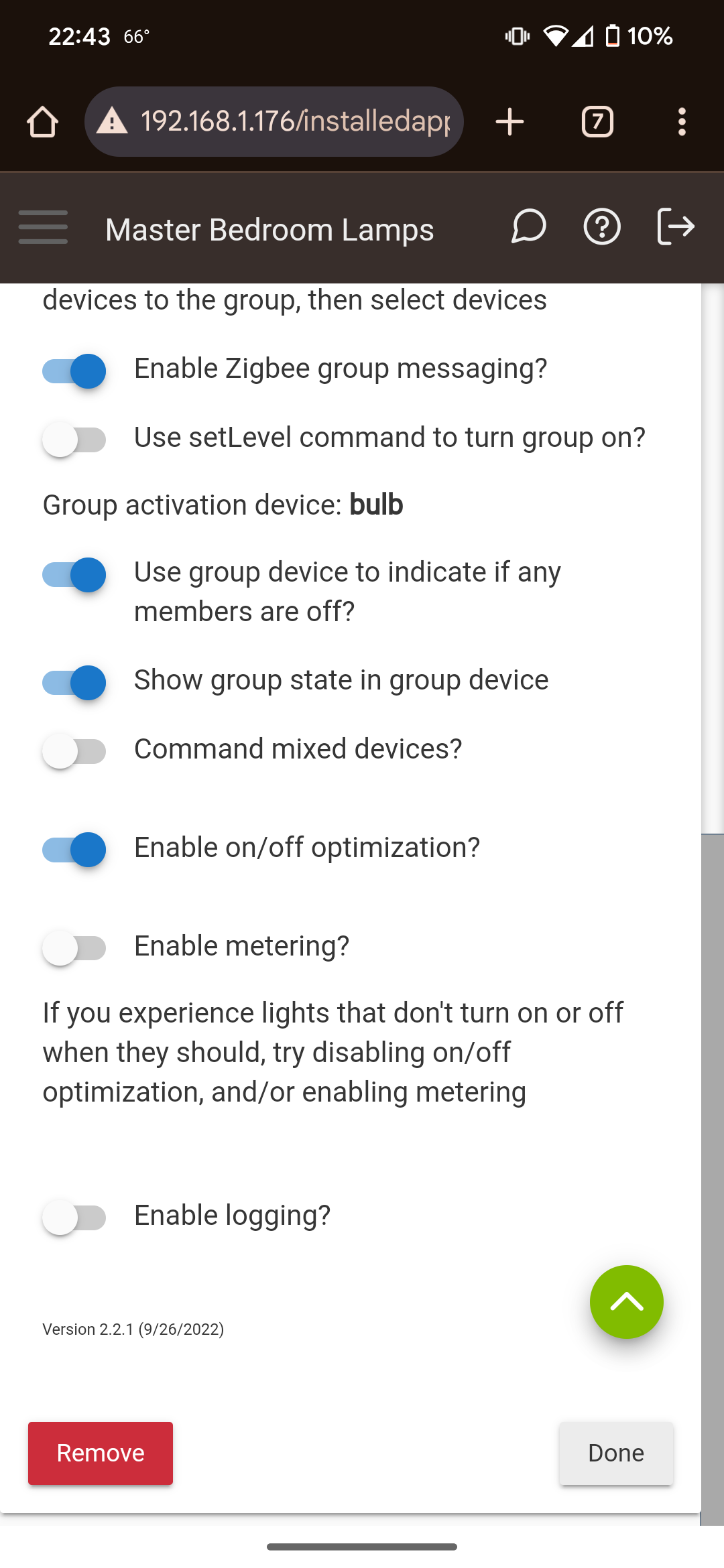

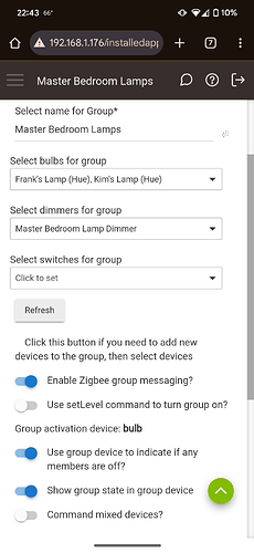

One guess without knowing more: there are various options in the Group app for how the activator should show its state in response to member devices. Maybe those options just aren't set as you want? Note that some member device states will simply never make their way to the group device, for example, color changes. Those will only be reflected if commanded from the activator (undoubtedly due in part to to the complexity of figuring out what the group state should be in that case -- an average?). The on/off state should be pretty clear-cut if the options are correct, however.

  • my settings are attached.

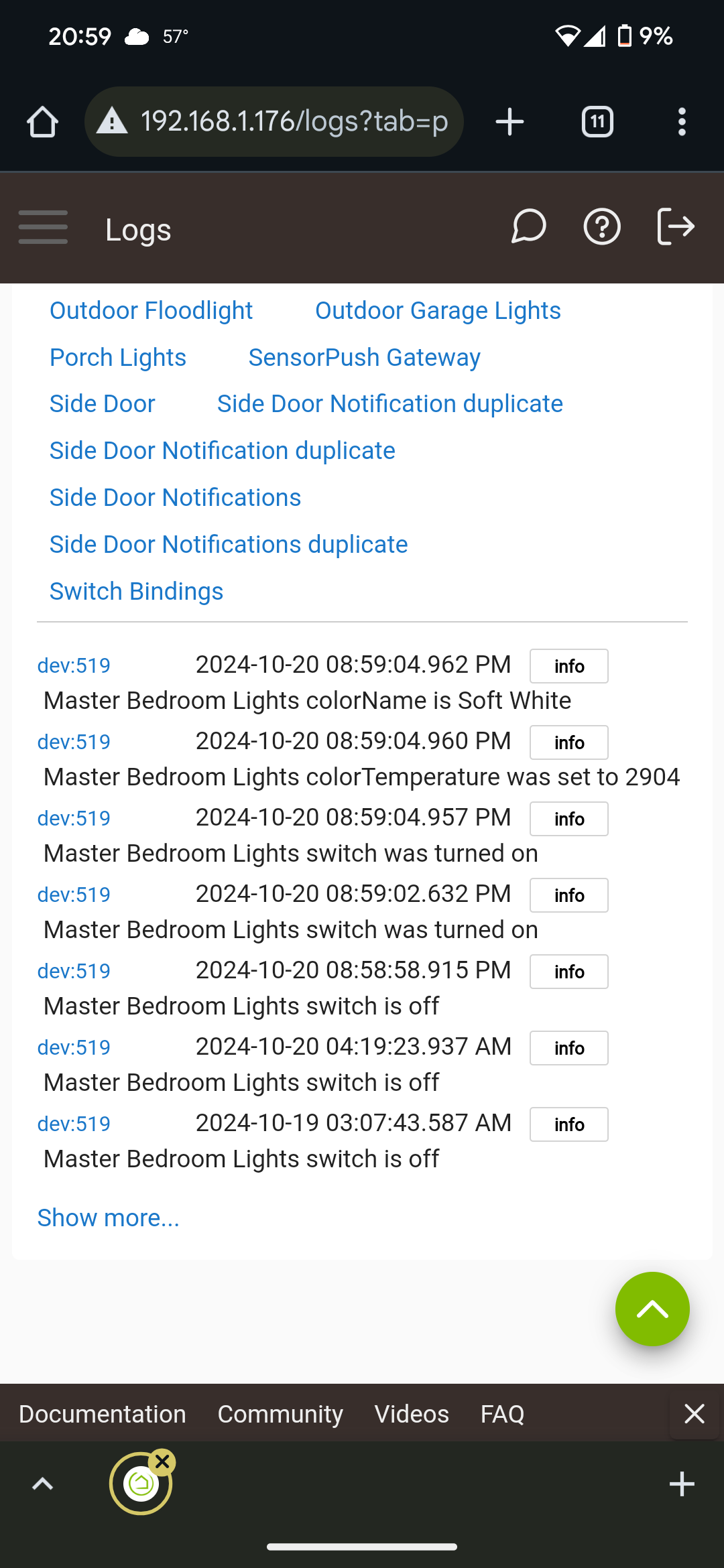

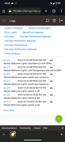

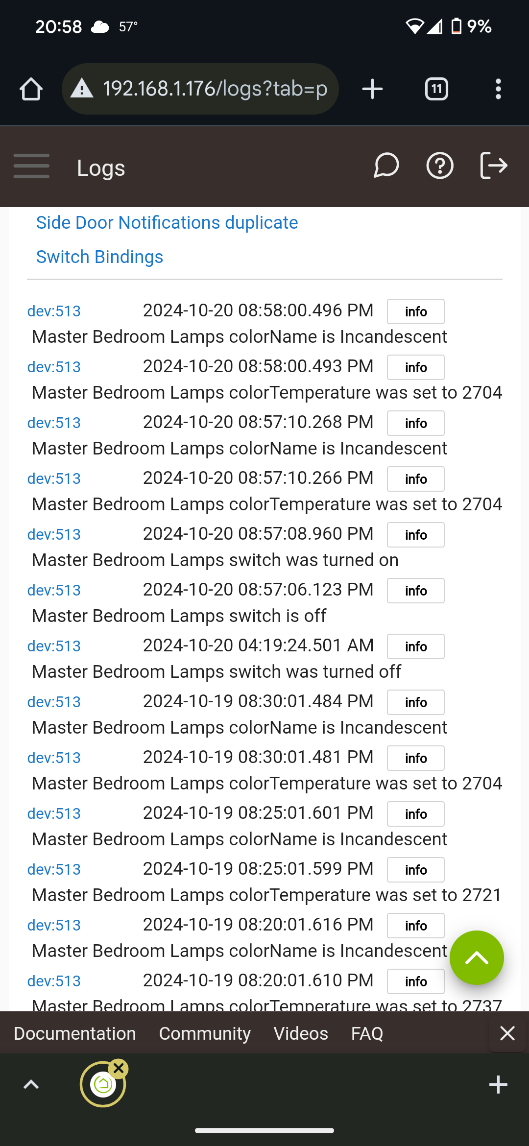

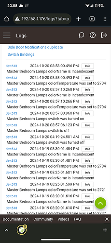

This is the best I got. At some point in the early morning, both of my Groups for master Bedroom stopped working, both the lights and lamps. Since the hue bulbs are paired directly with the switch, I didn't notice until later in the day when Webcore could not assign the correct color temp to both Groups.

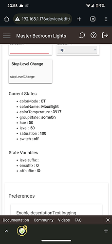

Once I cycle the group off/on from the device page, as not even dashboards could interact with the Group, it starts working normally and tracking the physical switch. These pictures were taken when the lights were on.

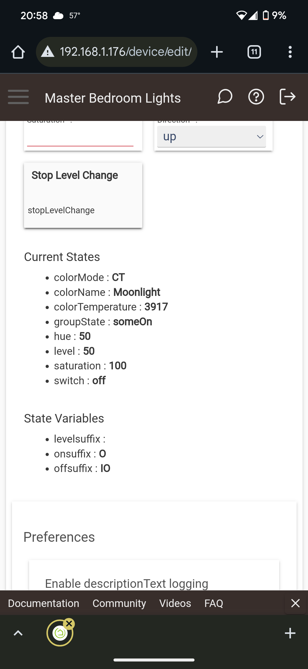

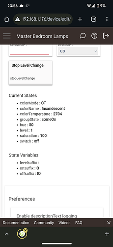

Master Bedroom Lamps - Lamps with hue bulbs were on. My Inovelli switch said it was on. Group said it was off.
Master Bedroom Lights - Ceiling lights with hue bulbs were on. My Inovelli switch said it was on. Group said it was off.

On the logs the best way to look at them is to look at both devices and apps in line. You can filter on multiple devices/apps. Your logs above just show devices. Of course, you need to make sure logging is turned on for your groups.

I finally have isolated the issue down. My Groups would not match the physical state switch because sometimes one of the bulbs wouldn't report as being on. I had to change it to reflect if any members were ON, not off.
