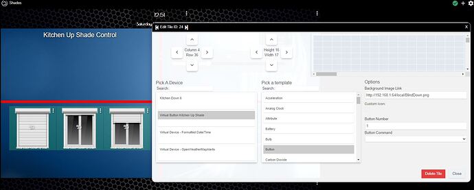

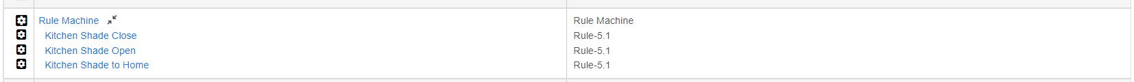

Hi Team, we have shades installed that use the Somfy motors and Graber blinds. We purchased these from Zebrablinds. We got all 6 of them to work in our kitchen. Here is what we have done so far to set these blinds up. All blinds use the Generic Z-Wave Shade driver. We then created 3 x PM rules that will move the blinds to their corresponding position.
We then use a virtual button on our dashboard to trigger them. This all works really well.

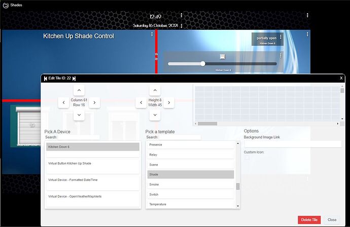

We can even get a shade slider to work that gives us a variable height. But this is only for the individual shade.
However, when we try to create a group to use the shade slider to control them all together, this it were it breaks down. We cannot figure out how to move the group all together. We tried to switch to a dimmer driver but then we do not get attributes like fully open and so on. Please help!
