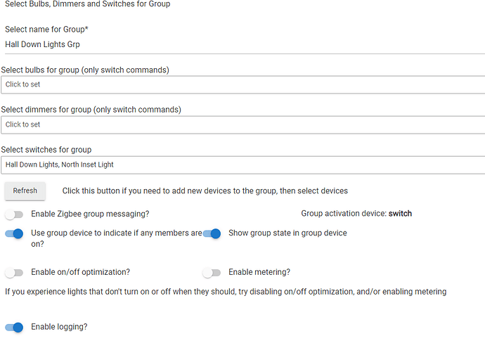

I have a group called Hall Down Lights controlled by two switches. Each switch controls
its own circuit, but doesn't control the group. However using the App it works fine. I have tried all the suggestion to no avail.

If there is a problem and not just a misunderstanding of what a group does, have you tried hitting Done in the group app (your screenshot above)?
A Physical Switch is for example, a Z-Wave switch that is connected directly to a physical device like a lighting circuit. Besides controlling those circuits, it is my understand that they can also control a group. Am I wrong? Yes, I have clicked on DONE, and all suggestions on the Hubitat Community related to this issue.

If you look at my screen shot. I am using the group device. Is it not correct?
No, your screenshot shows the group app, not the group device. There is no control available from this page, hence my question: how are you doing it?
