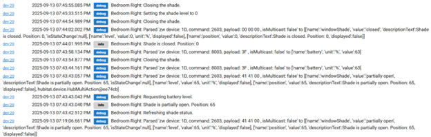

In past, to get the blind working/connected, I would do a Power Shutdown then unplug the C8 for a minute then power up. The blind would then operate correctly. I have had "debug" turned on for the Bedroom Blinds for some time. It appears the blind receives a command to close (change position) but for some reason the "position" parameter is not set to "0". I do not see the reason why? Below are screen prints of problem.

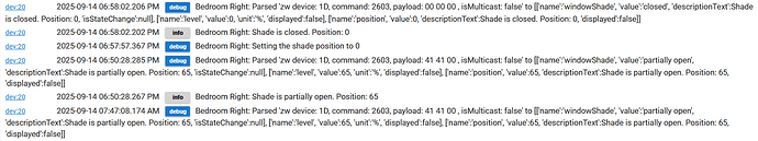

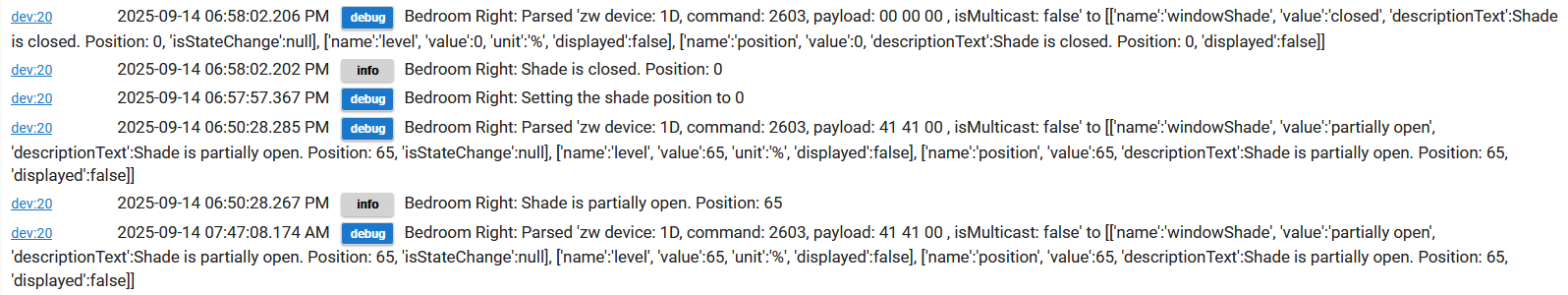

Bedroom left: always works
Bedroom Right: constantly fails

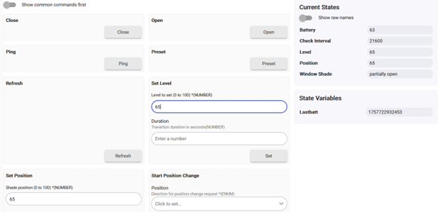

In "Devices", I issued "Refresh" command then "Close" command which changed the set position to "0" in the log but the Blind did not move and the "Set Level" stays at 65
I then manually changed the "Set Level" to "0" and the blind closed.

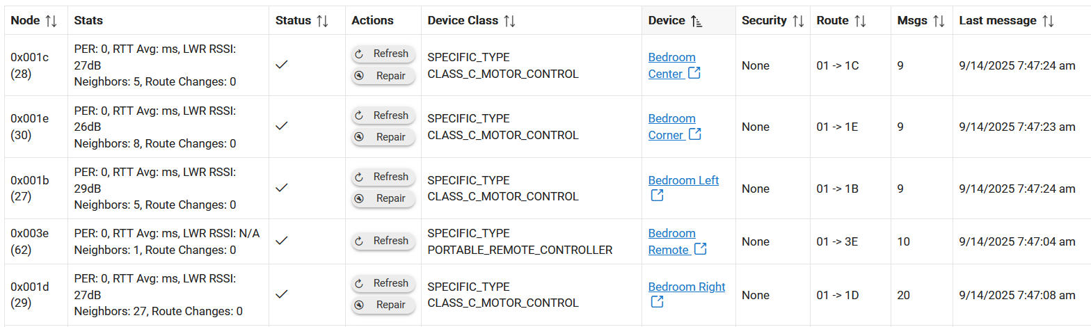

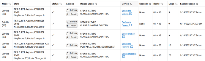

These are the "Rooms" and Z-Wave screen prints:
I am at a loss as to why the blind does not respond when the remote instructs all the blinds to close (one blind at a time, not using groups or virtual as I could not get the coding to work back on the C7 years ago).

just closed the blind using the remote, blind closed but the "Position" reported remained at 65. I had to go into the "Bedroom Right" device setting and manually set the "Position" to "0".
Not sure why the "Position" will not report correctly.
