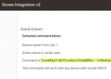

Wondering about more specifics regarding whether the Tap-to-Runs will work with the v2 integration or not yet. I seem to be able to get the very first tap to run in a group to appear, and it shows the very first device type, but what about the other 4 tap-to-runs in that group? Or does every one need its own group to work with this integration?
For example, I have a tap-to-run group called "Holiday" with 7 different options for different holidays, but when I put "Holiday" in when extracting the scene, it only gives me the first one "candy cane", and then only shows the first device listed in the Action list, "Front Can 1":
Is this by design or is this not how to get to the tap-to-runs to appear? I'd love to be able to get it set up so I can ditch my Google Home routines, just wondering if it is an option now with v2 and how to get it to work. Thanks!
