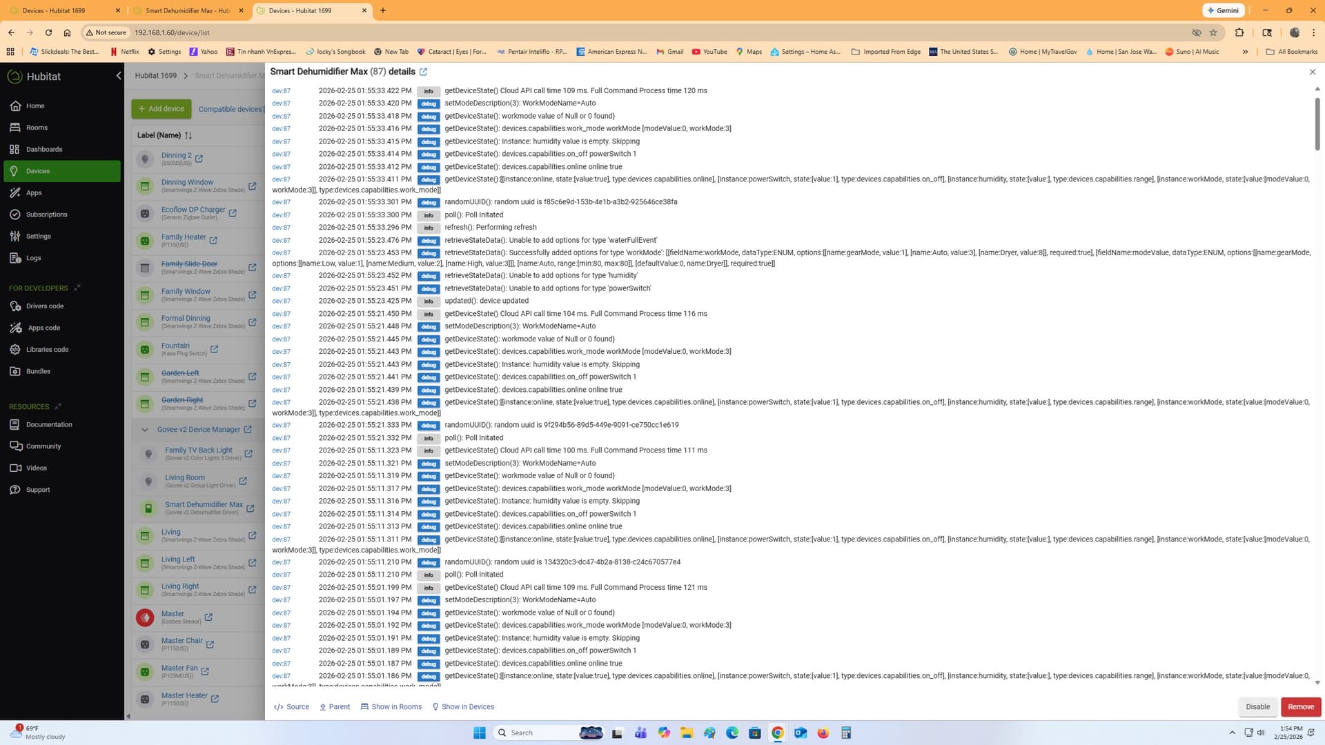

Thanks for update. Everything is basically working. Govee H7151 has build in humidity sensor, is anyway to query the current humidity so can automate base on desired humidity? also for desired humidity it range 30% to 80%.
Again Thanks
Can you turn on debug logging and then click on the refresh button. That should trigger a poll of the Govee Cloud API. Then capture what is returned and send it to me. with debug on it should show everything that was returned from the API reguardless of weather it is processed or not. I may just need to add the attribute to the device.
That said i think it is unlikely the API is returning the Humidity based on the CapTypes reported by the device.
It doesn't look like the Humidity is being returned by the polling of the API so i won't be able to capture it here.
