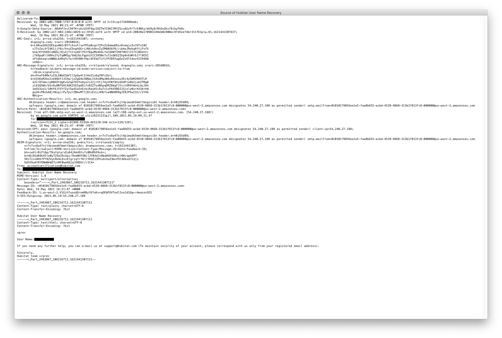

SMTP is pretty easy to spoof. Examine the raw SMTP headers to look at the path to you, see if it’s genuine.
It seems like it came from the Hubitat username recovery servers but what do I know about reading the RAW format. Here's what I see and perhaps a more knowledgeable person can say whether its been spoofed?
Well, good news is that it came from an Amazon SES server that Hubitat.com’s DNS SPF record denotes as ok to send email for Hubitat.com, and there weren’t any intervening SMTP relays to your gmail.com email destination server, so the originating “Received:” header isn’t spoofed in the SMTP headers, nor is the SPF validation header. And, it’s known that Hubitat’s Remote Admin service uses Amazon AWS, so it’s probably genuine.
copy/paste the raw headers into here and have it be analyzed. used to do this back in my datacenter days

Received: (qmail 6513 invoked by uid 30297); 12 Jul 2022 12:11:26 -0000
Received: from unknown (HELO p3plibsmtp02-14.prod.phx3.secureserver.net) ([68.178.213.14])
(envelope-sender 01010181f252403c-7a7e57ca-68af-4ba7-aeed-4ce05e7b8fe4-000000@us-west-2.amazonses.com)
by p3plsmtp26-01-26.prod.phx3.secureserver.net (qmail-1.03) with SMTP
for XXXXXXXXXXXXX; 12 Jul 2022 12:11:26 -0000
Received: from a27-56.smtp-out.us-west-2.amazonses.com ([54.240.27.56])
(using TLSv1.2 with cipher ECDHE-RSA-AES256-GCM-SHA384 256/256 bits)
(Client did not present a certificate)
by CMGW with ESMTP
id BEjeoN0rxoYg0BEjeokTKq; Tue, 12 Jul 2022 05:11:26 -0700
We use AWS services for user verification so as @672southmain mentioned last year, these emails come directly from AWS. I could escalate this case with Amazon, if you'd like to find out what triggered the account verification email. Send me a PM if you'd like us to dig into it.
