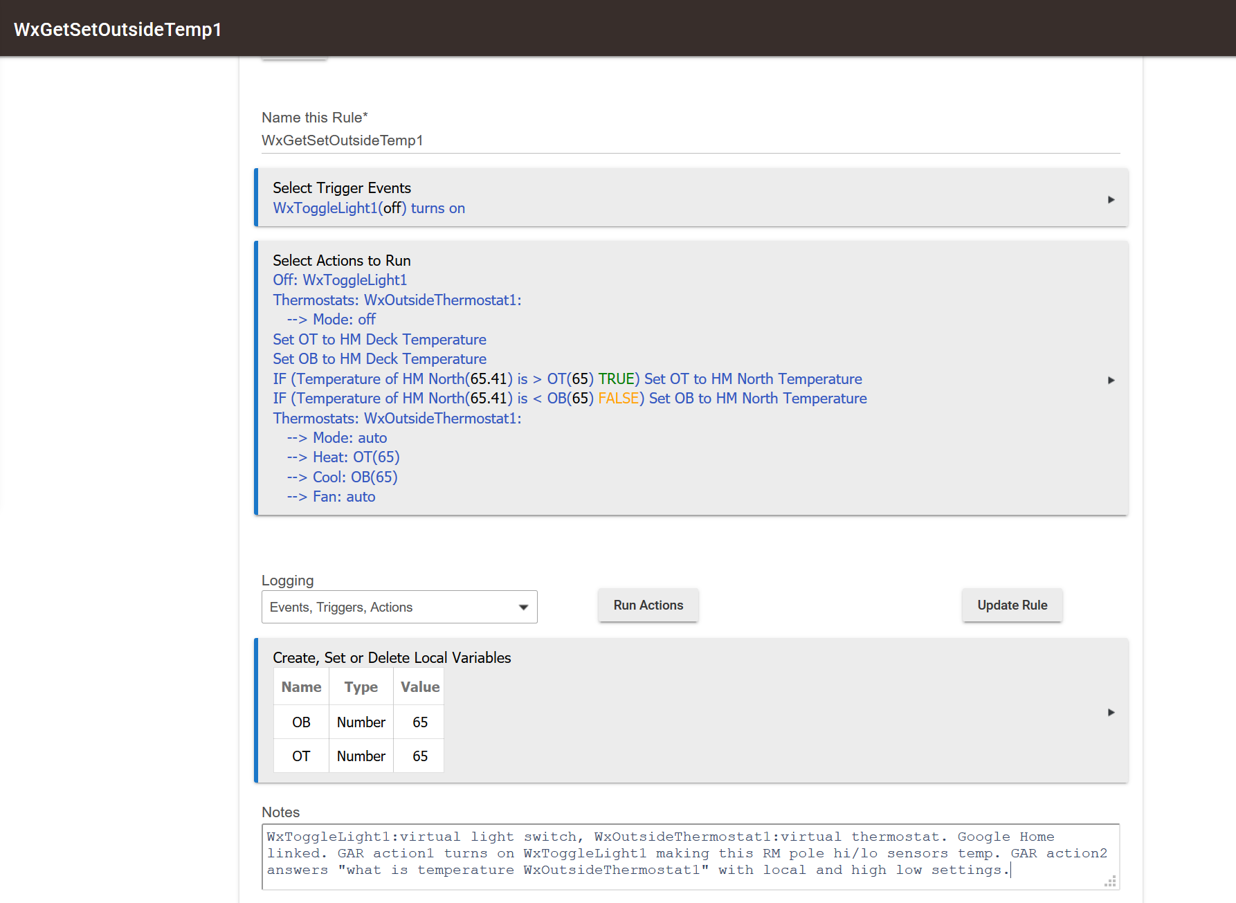

Nothing elegant, but as an example going from GAR to HE...
Going in the other direction is dubious, again but...
