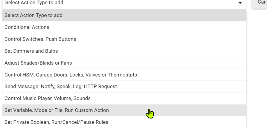

What action are you using to initialize? I can't seem to find it

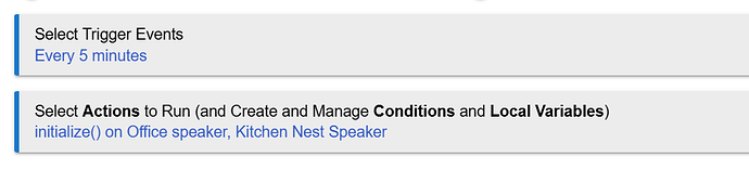

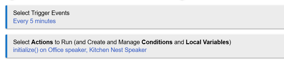

Maybe excessive...but I initialize my Google Home speakers every 5m via a rule:
Doing so has kept my announcements on the Google devices (one mini, one Nest speaker) rock solid for many months.

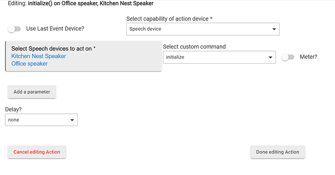

@danabw This is what I'm trying to find. Where is the initialize at?

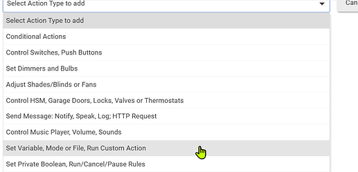

Create an action using Custom Action...
Speech device>select speakers>choose "initialize" command:
Found it. Thanks. I will give this a try. I'm setting mine for 5 mins also. Thanks

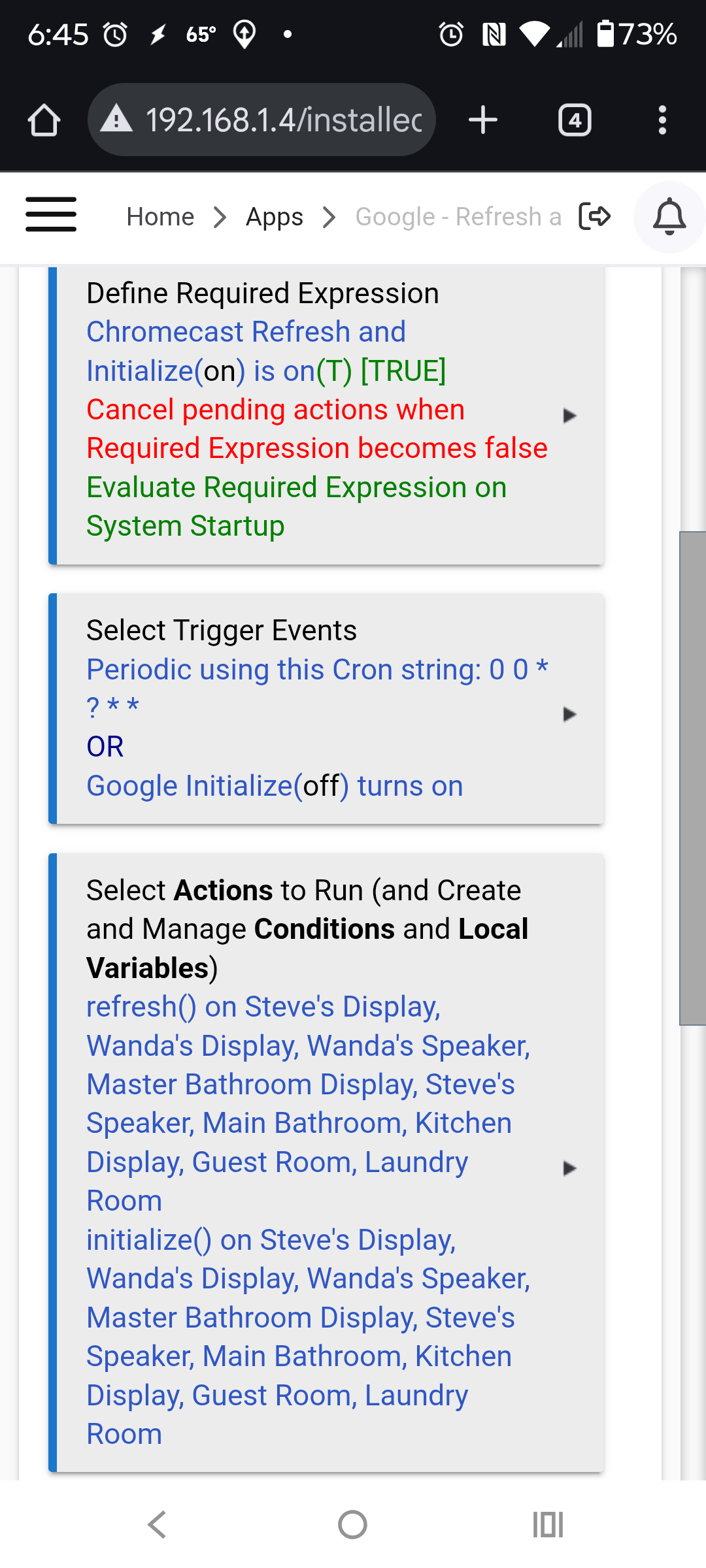

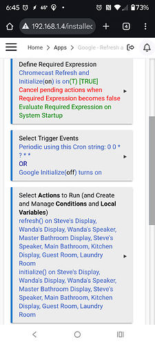

I issue a refresh and initialize at the top of every hour. I can't remember the last time I had an issue with announcements. For me, this has just worked for years now
